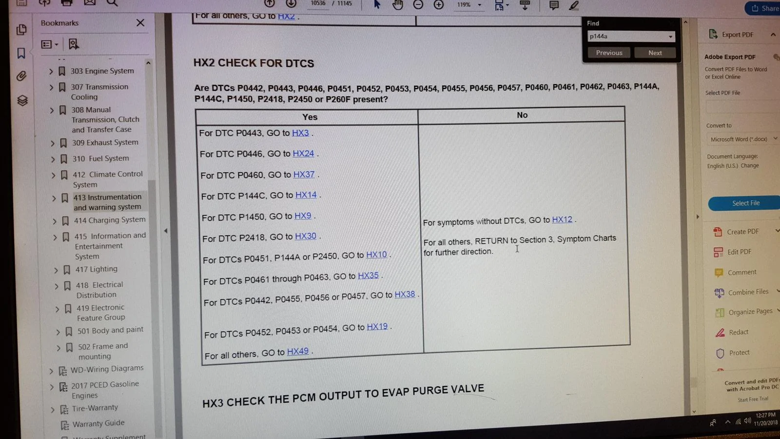

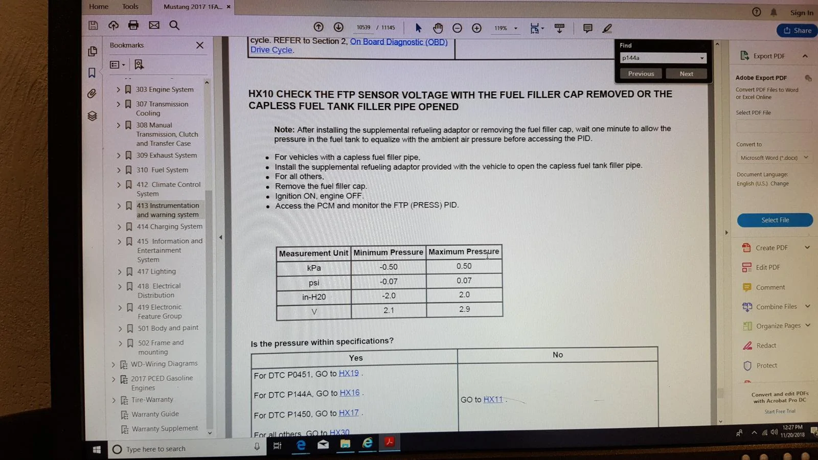

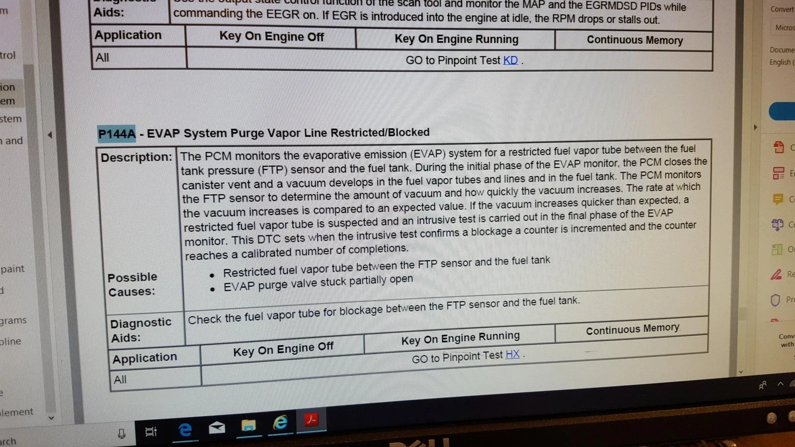

Step 1 DTC P144A
HX 10.... is the pressure within specification?

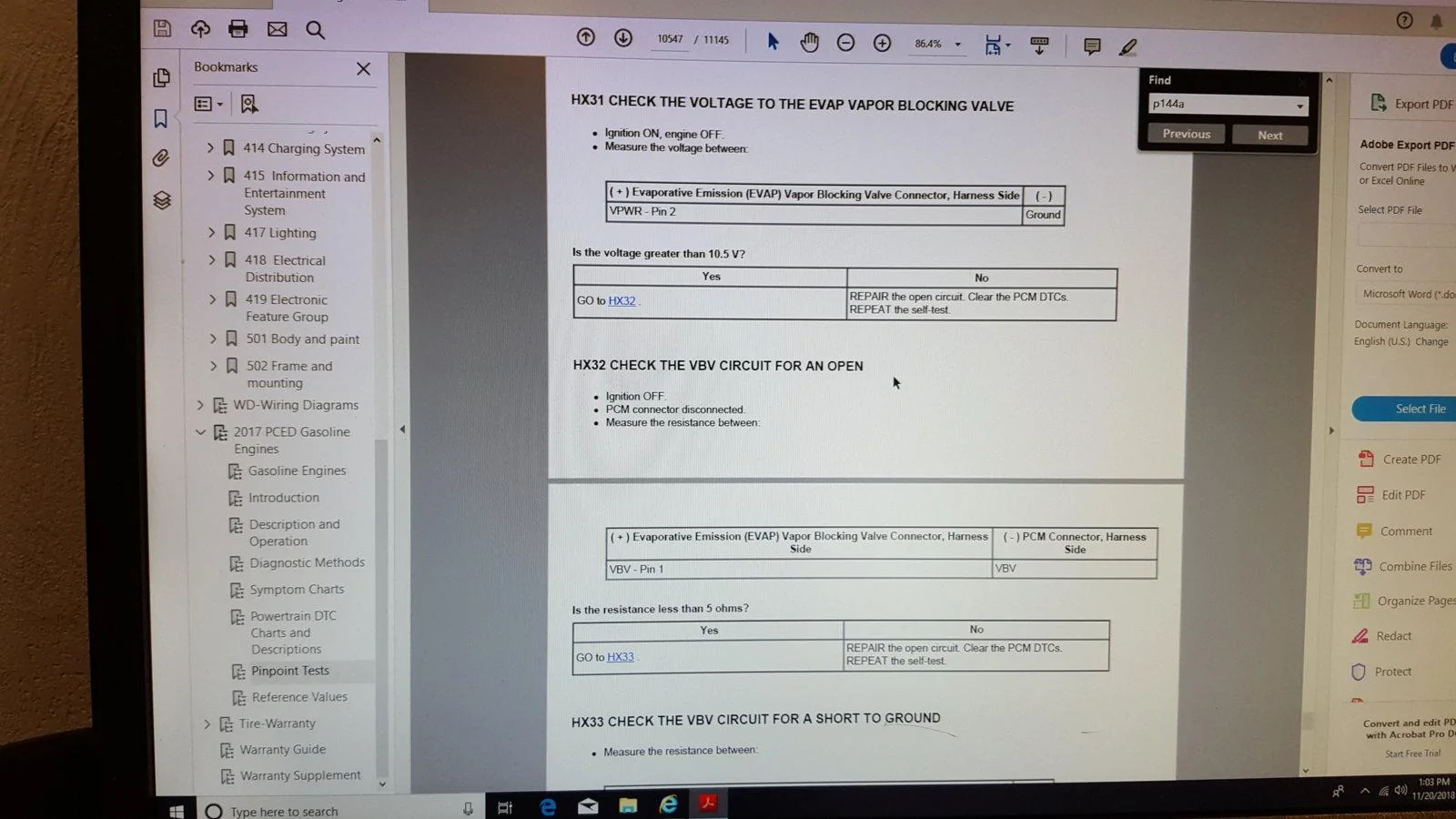

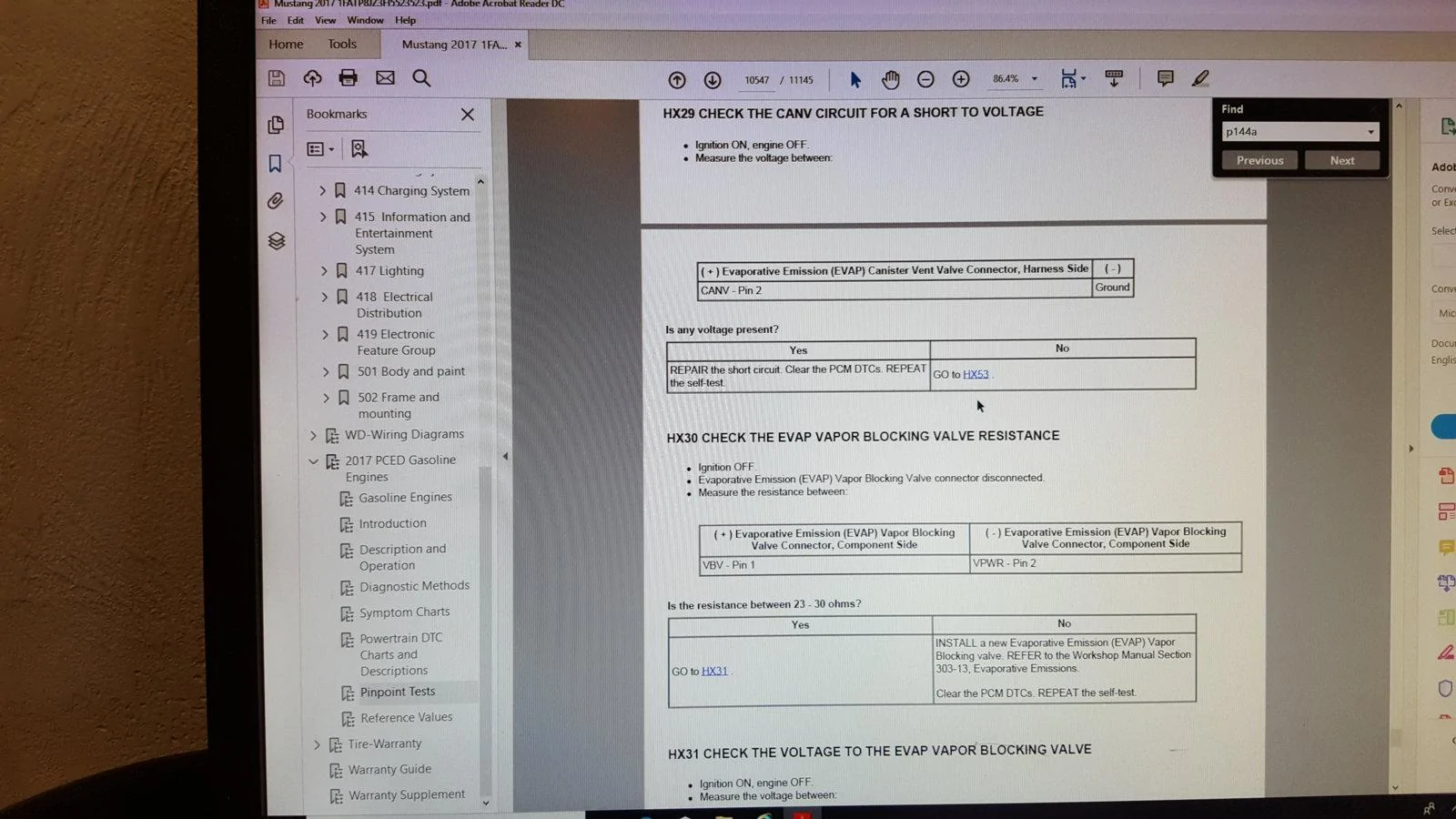

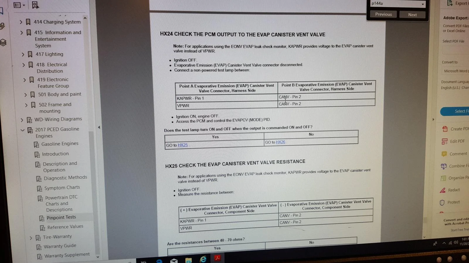

The manual is oriented more like a decision tree. It is very difficult to locate specific tests for various components. This is what I found for the canister and vent control valve.
I would suggest following the troubleshooting steps as per the manual for each DTC. Way too many variables and the decision tree takes care of the logic.
But here you go for testing the vapor canister vent control valve

Thanks, Tom! I appreciate it. Looks like I know what I am doing tonight.

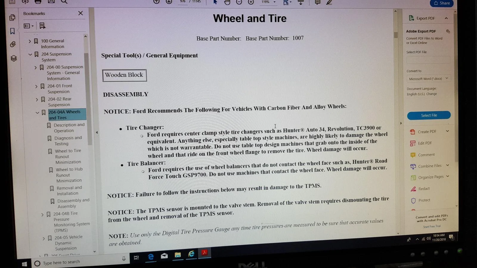

Jim, this is what the factory manual has yo say about carbon fiber wheels
I am out of town for Thanksgiving and do not have access to my computer that has the manual. They build the manual off of your VIN. However, it may contain instructions for both wheels. @tedj101 Will you please help @Tank with his question?
Thanks for your help @AgentOrange and @Tomster . The info was to try to wrap up the TPMS info in the GT350 Basics thread.

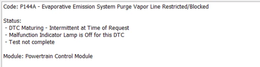

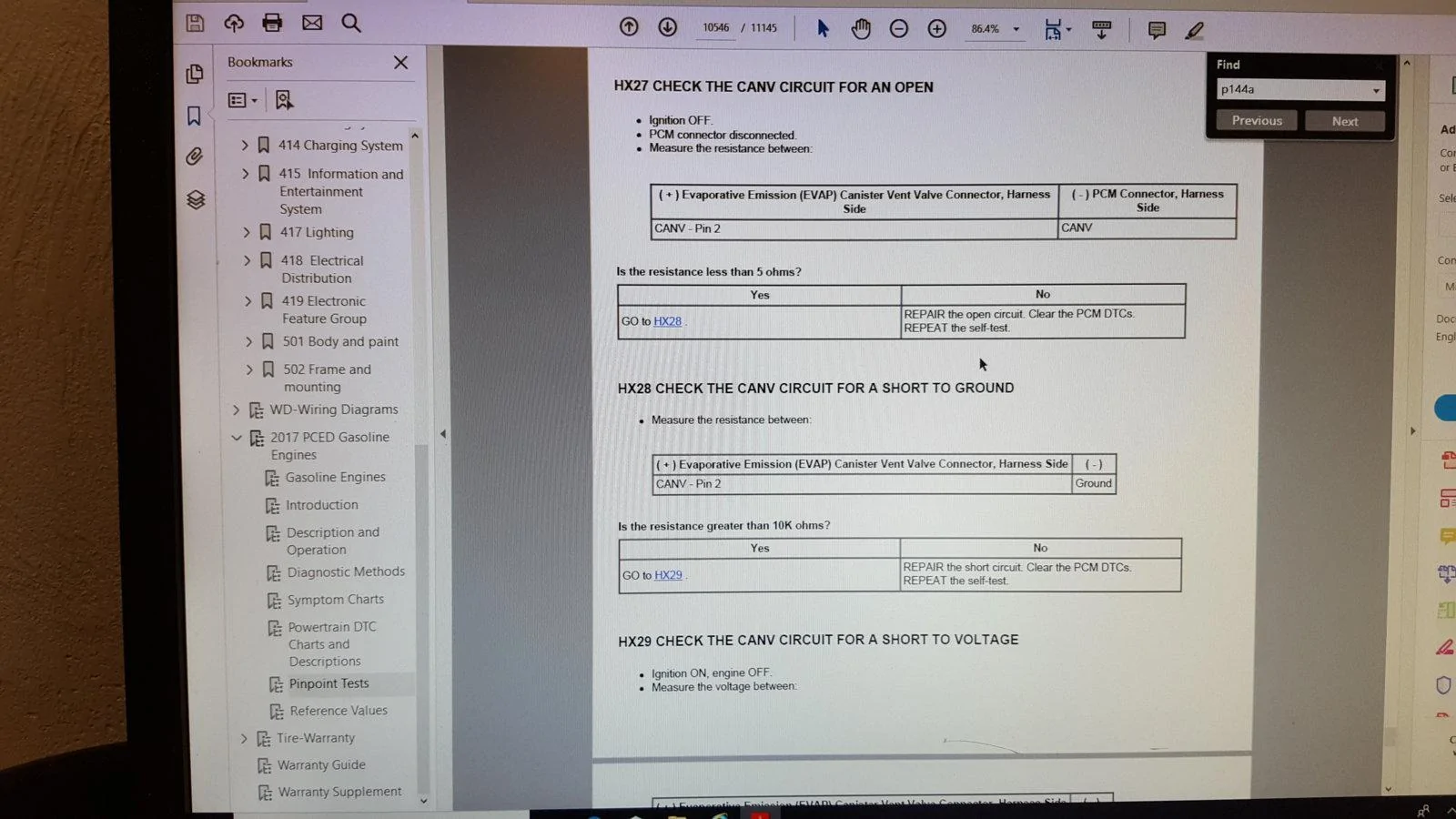

Welp, the plot thickens. So I tested the vapor vent control valve, PCV tubes going to the fuel tank, and EVAP canister circuit. All passed.

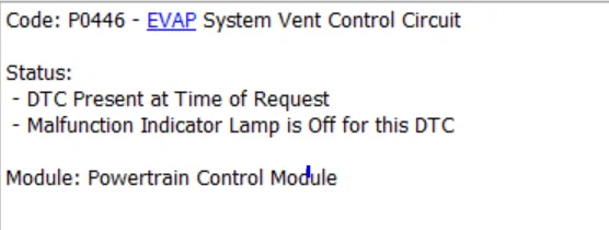

So I decided to power up the car, start it and re-read the codes. I had forgotten to plug the EVAP canister circuit back in, so it through a third code P0446. I plugged it back in, reset the codes and restarted the car. Surprise - no more codes. Engine seems to be happy as a clam. Ugh. It wasn't an exhaustive test session, but in 10-15 none of the codes came back.

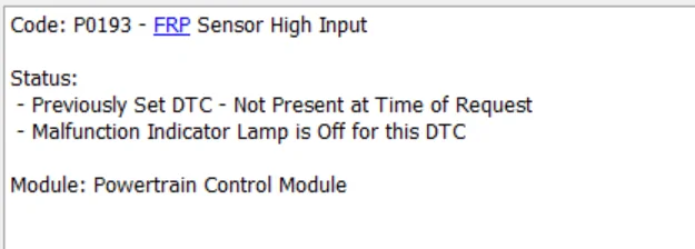

Anyways, here are the details of the 3 codes.
Once I get the service manual, I'll test the circuits more in-depth. But right now, it's looking like maybe this is an intermittent problem. Considering both the purge valve and the fuel rails are controlled by the engine harness, I am wondering if there is a week connection that is going to cause me intermittent problems until complete failure.

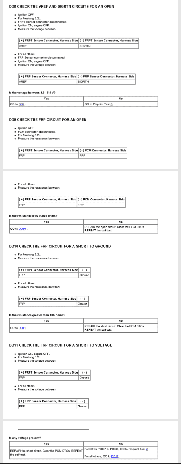

Alright, got the service manual out and started working my way down the decision tree. Since I have a GT350, I started DD8 per the instructions. Got to DD11 where I test the Fuel Rail Pressure circuit for a short to voltage.......where it failed. The f**k? How is it shorting to voltage? Exposed wires somewhere? oye

Not sure if I am suffering in the reading comprehension department or overthinking this, but digging deeper it says:
Fuel Rail Pressure Temperature (FRPT)
Sensor The temperature component of the FRPT sensor is a thermistor device in which resistance changes with temperature. The electrical resistance of a thermistor decreases as the temperature increases, and resistance increases as the temperature decreases. The varying resistance affects the voltage drop across the sensor terminals and provides electrical voltage signals to the PCM corresponding to temperature. The pressure component of the FRPT sensor provides a signal to the PCM indicating fuel rail pressure.
The PCM supplies a 5 volt reference (VREF) signal, as well as supplying 5 volts on the FRP circuit. As pressure increases, the sensor signal voltage decreases. The FRPT sensor measures the pressure and temperature of the fuel in the fuel rail and sends these signals to the PCM. The PCM uses the fuel pressure and temperature sensor inputs to command the correct fuel pump speed. The relationship between the fuel pressure and the fuel temperature is also used to determine the possible presence of fuel vapor in the fuel rail. The FRPT sensor is located at the top of the left fuel rail.
So the FRP circuit is supposed to supply 5v from the PCM, but the diagnostic parts say that if any voltage is present, there's a short to voltage (read step DD11 above). I must be confused...
