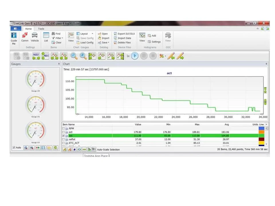

CAI Temps

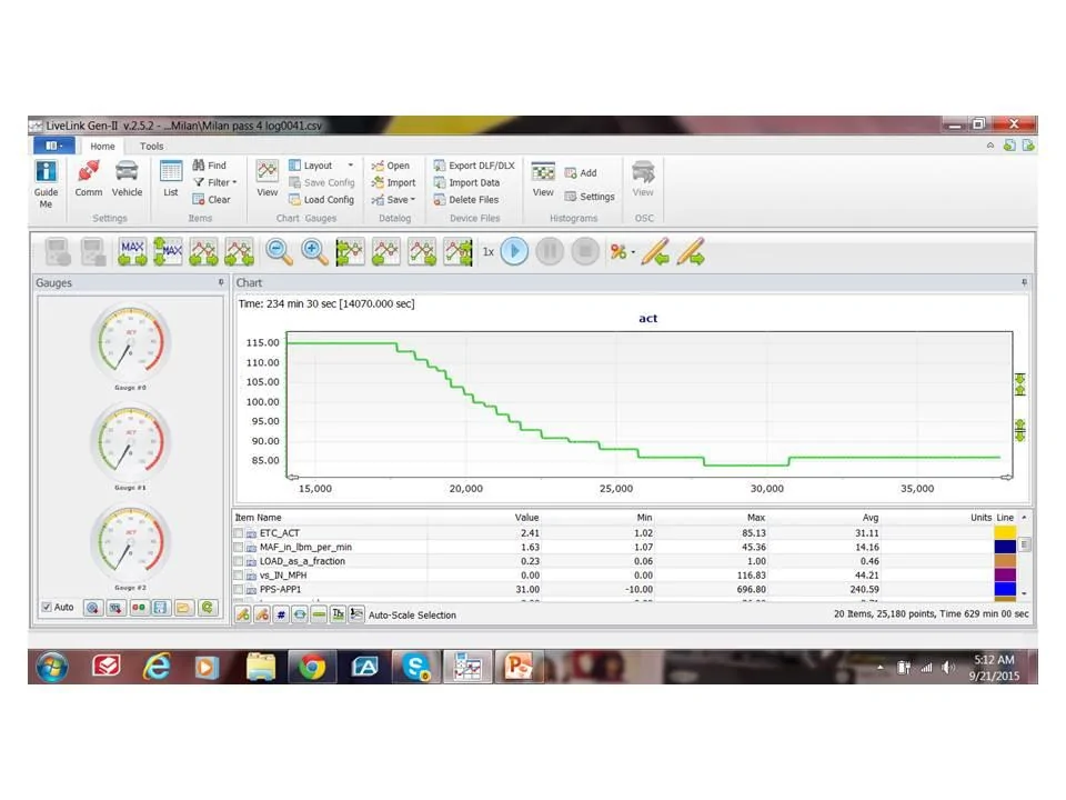

So here's some data on CAI during a 1/4 mile pass. The 1st log was my cardboard template, went from 113° to 93° so there was some improvement over nothing at all. The 2nd log is my home made ABS heat shield, it went from 115° to 84°, it went lower and in a shorter time period. Good data backing up imagination and don't forget the 119.65 mph.
esacteksab
Apr 4, 2015
64
1,445
243
CO & KS
2015 Mustang GT
Love the data! Thank you!
Sinister
Jan 29, 2015
845
302
Missouri City, TX
2015 Black GT PP
Looks like it's working pretty good.

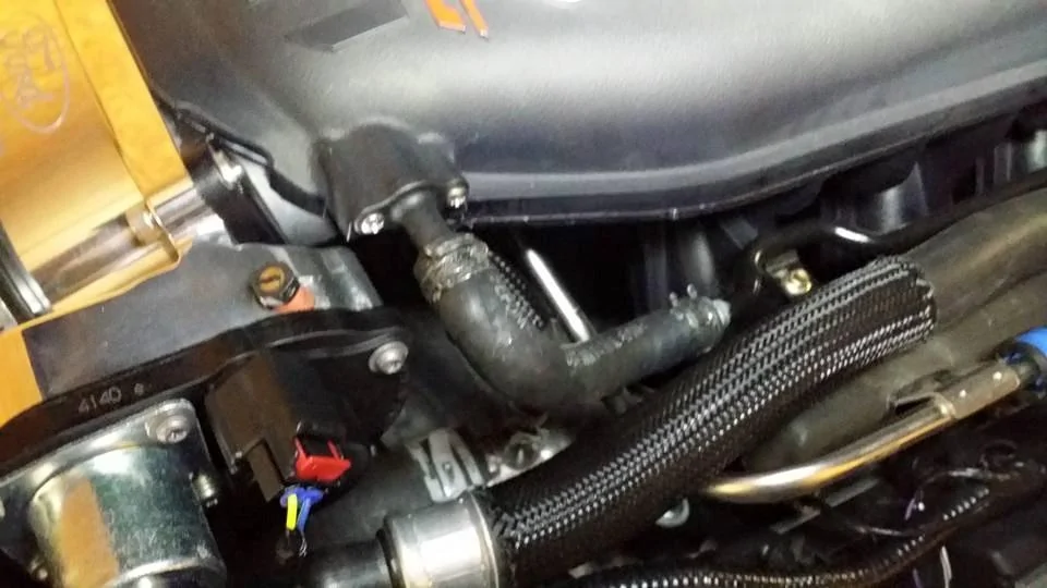

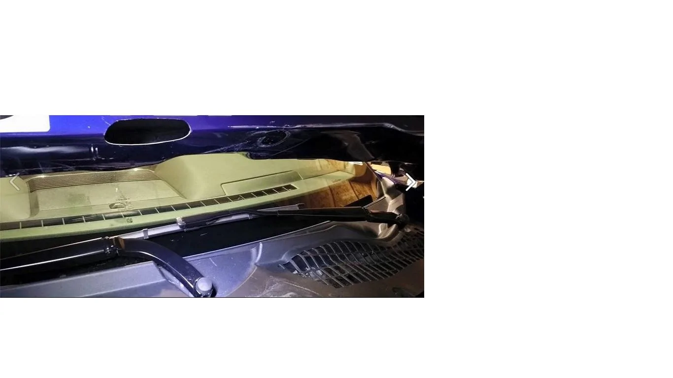

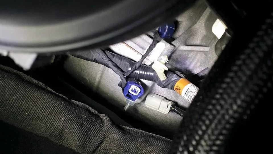

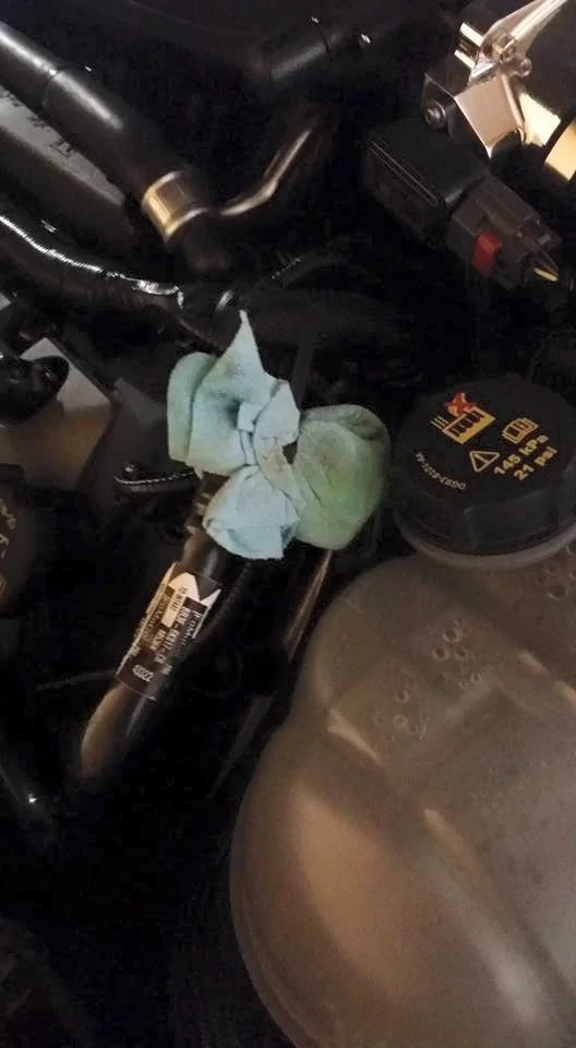

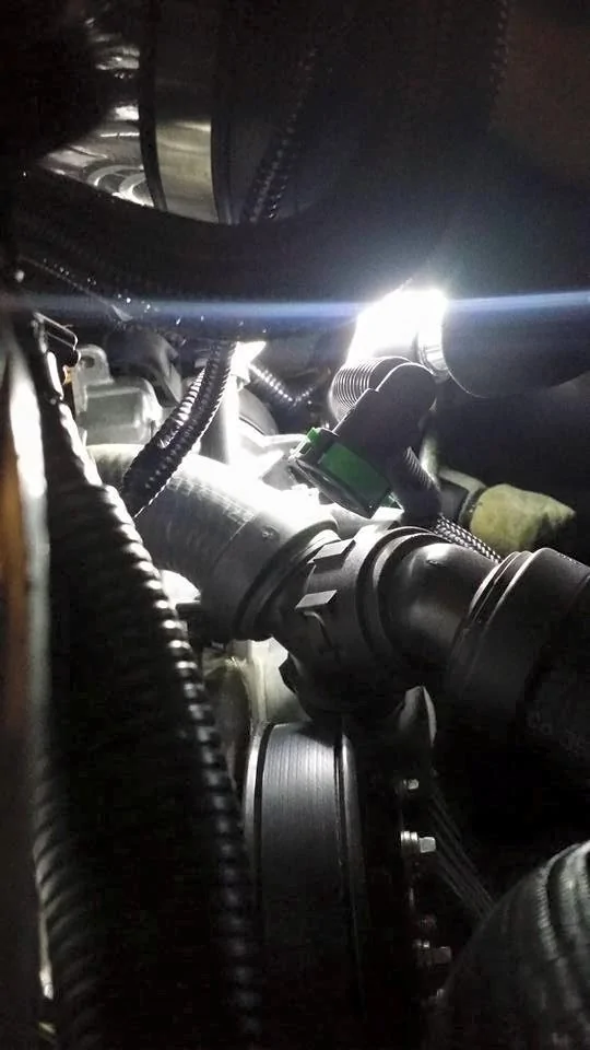

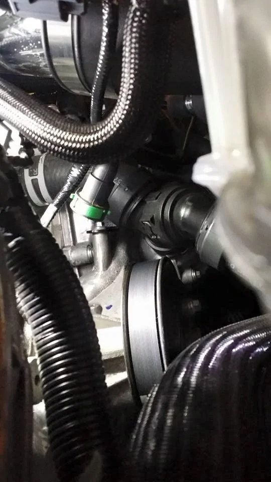

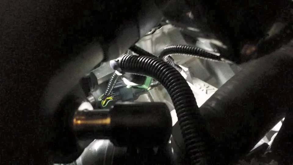

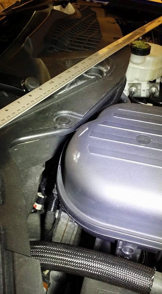

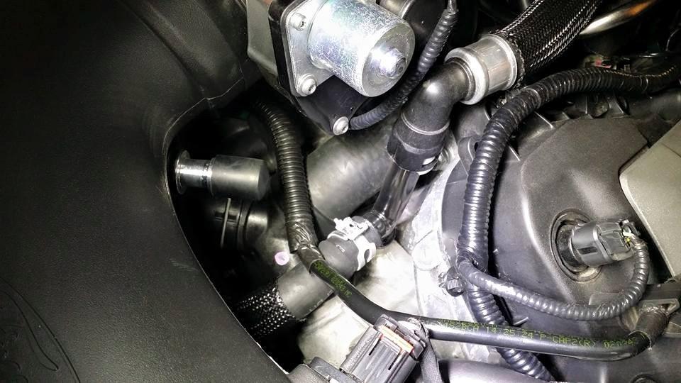

The pics here are meant for a fellow member to view to assist in future mods. I tried posting in a PM, but I guess you can't post pics in a PM? I can understand why if it's true.
Sinister
Jan 29, 2015
845
302
Missouri City, TX
2015 Black GT PP
No doubt. I didn't realize how tight it was against the firewall. Thanks for posting the pics!
Poppacapp
Apr 29, 2015
1,325
365
NC
2015 Mustang GT
So I guess Intake must come off for tranny work?
86merc
Sep 1, 2015
353
125
US
2015 Mustang GT
Boy ford sure made it a huge pain in the ass to use different manifolds.
Well it was designed for the 2011-14 cars. Can't blame Ford or frpp for the intake not fitting the 2015+ the same way.
I had to remove the CJ intake when dropping the trans on the 2011-14 cars. Otherwise it would hit the firewall/cowl area. So not surprised if the 2015+ was the same as it looks tighter. Luckily the intake is easy to take on and off.
