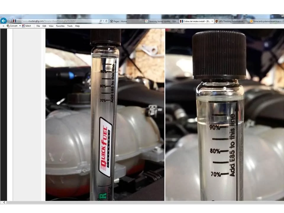

I tested my first batch, but not since, I will now. My first batch was E90!

wha? how can they claim to sell you E85 if it's not 85% ethanol?
From my understanding E70-E90 is acceptable by Government standards, just as the gasoline octane rating has a variable and you can be sure it's on the low side.
The pumps always have a tag that show the range that is acceptable, or the minimum level acceptable....at least in CA.

Good luck on getting true e85. Local where I am at, we never get the full e85. We are e66-67 at the moment and the best I have seen his mid 70s. I would think allot of the gas stations selling e85 get the same deliveries.
Luckily I know it's available to me just not as convenient as this station which is right next to me. A friend of mine (who currently runs E98 in one car and straight race gas in his other car) used to fill up E85 drums at this other place and he confirmed it's E85 there. At least in the summer.
They have a sticker that says "70% minimum" to cover for their winter blend. Most if not all stations should have it.

I test mine and it's been 85% all the time
