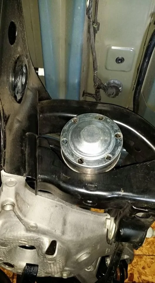

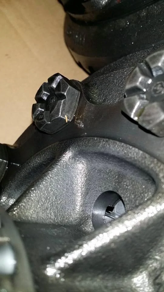

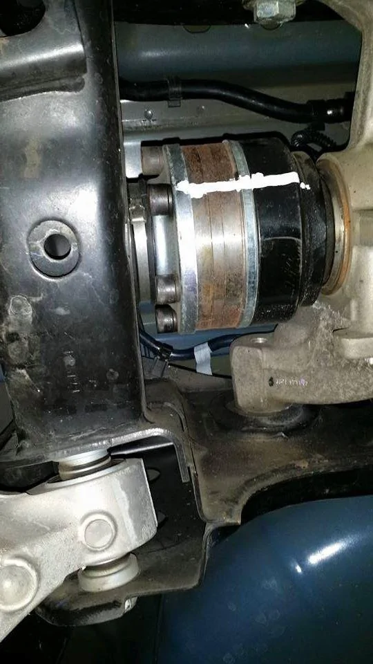

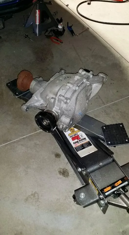

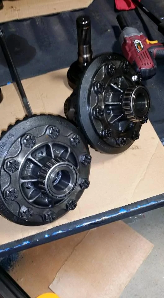

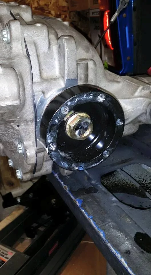

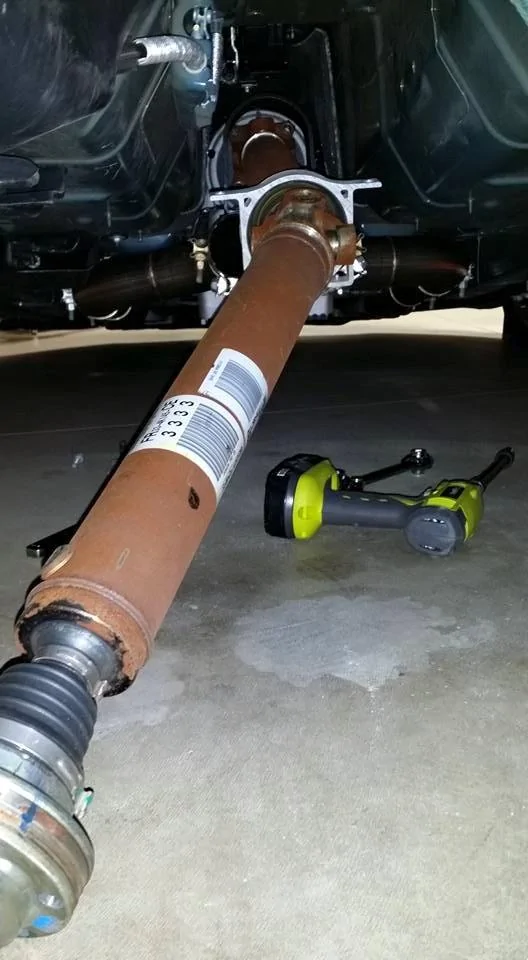

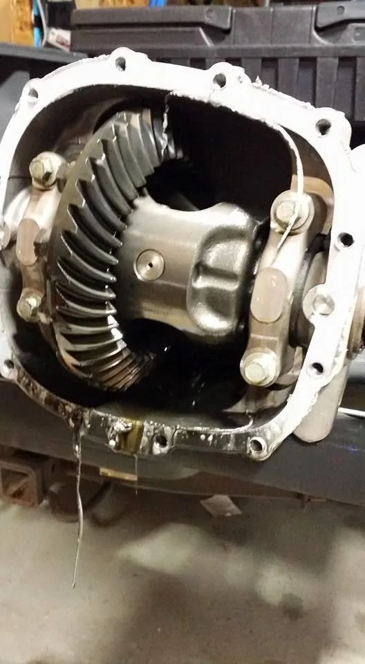

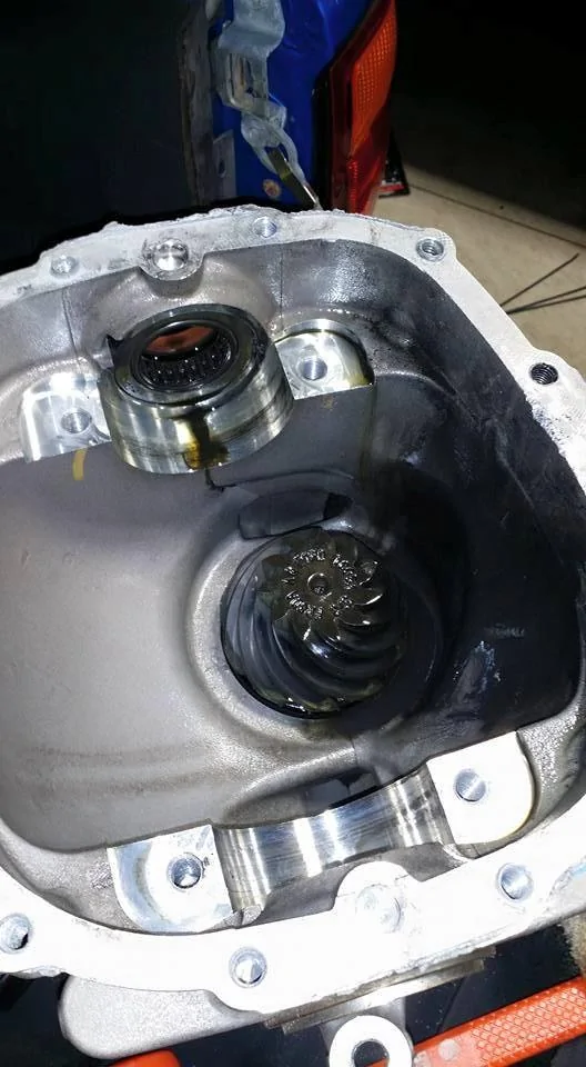

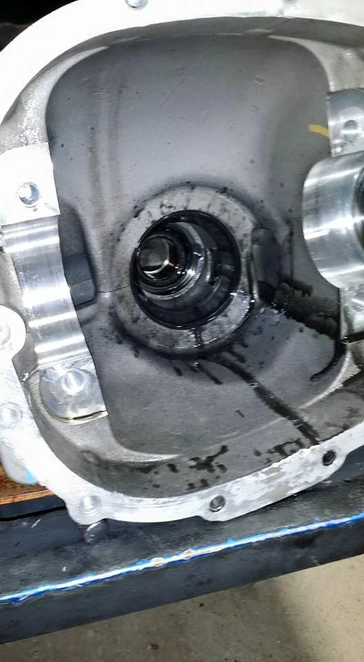

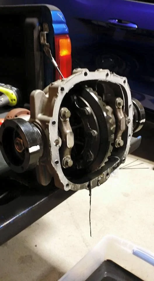

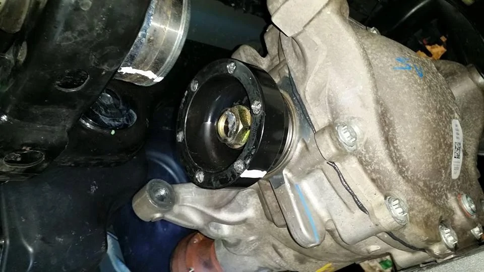

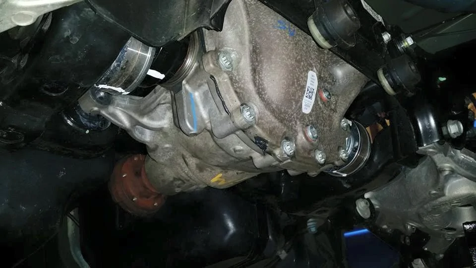

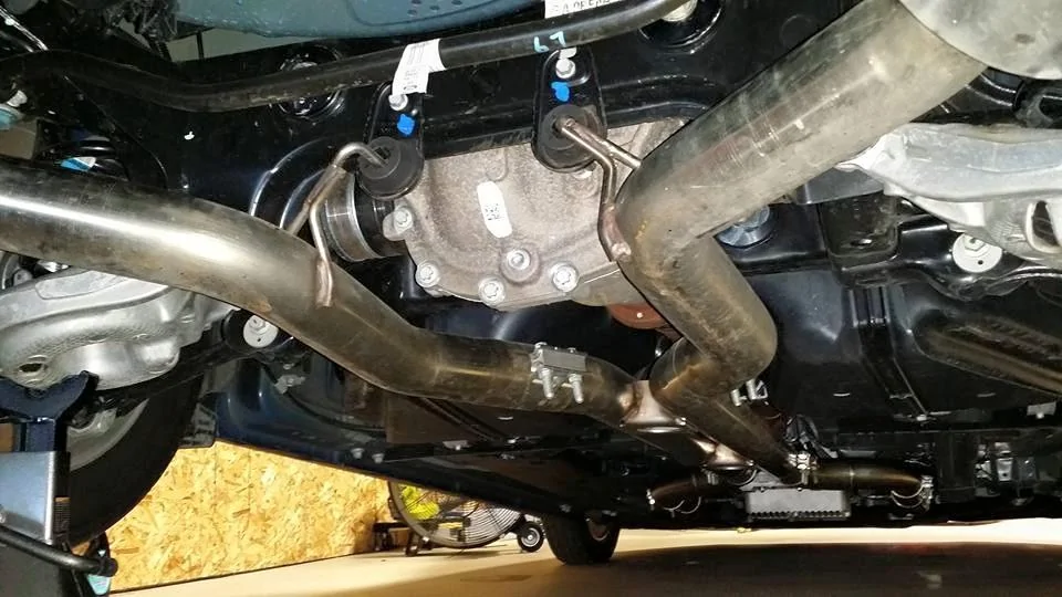

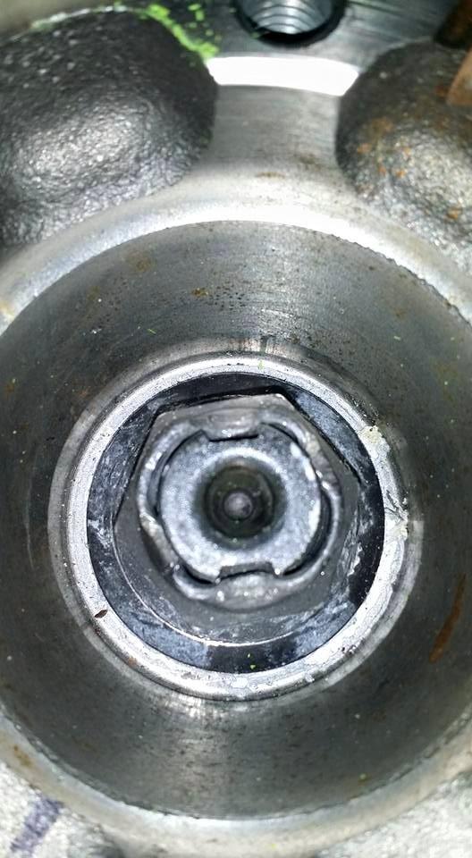

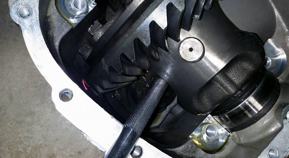

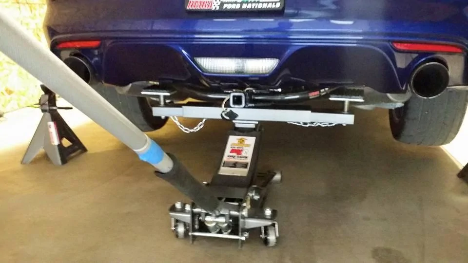

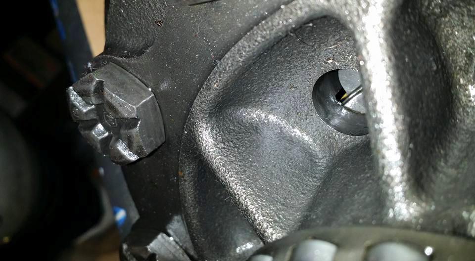

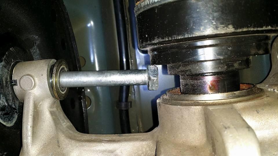

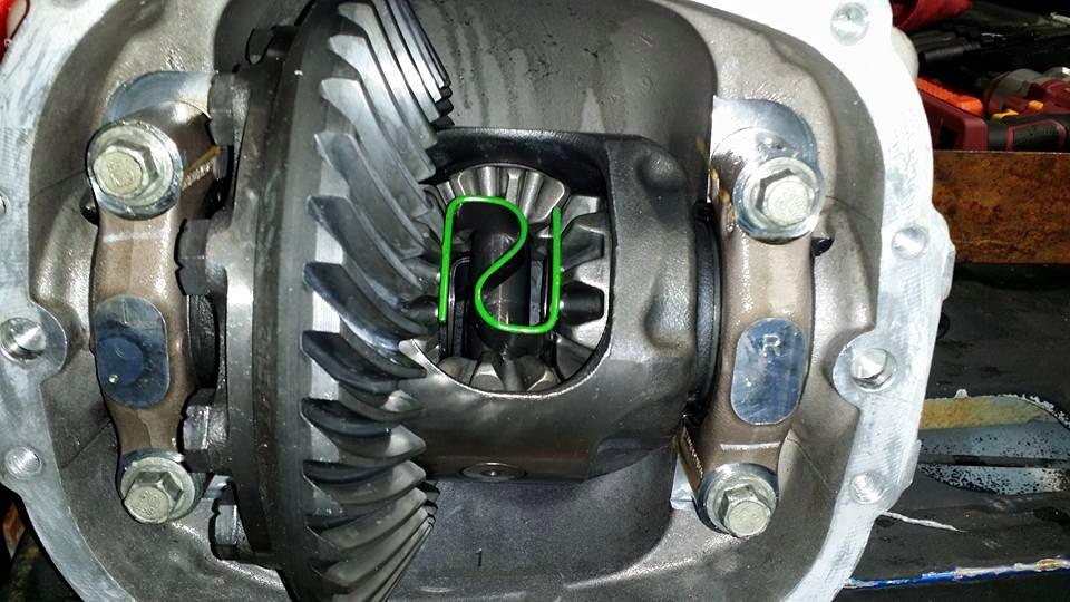

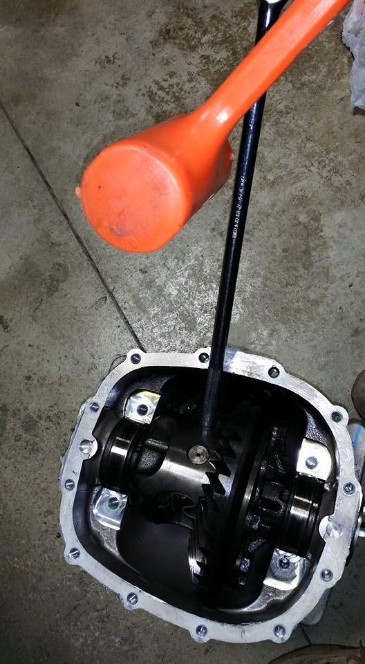

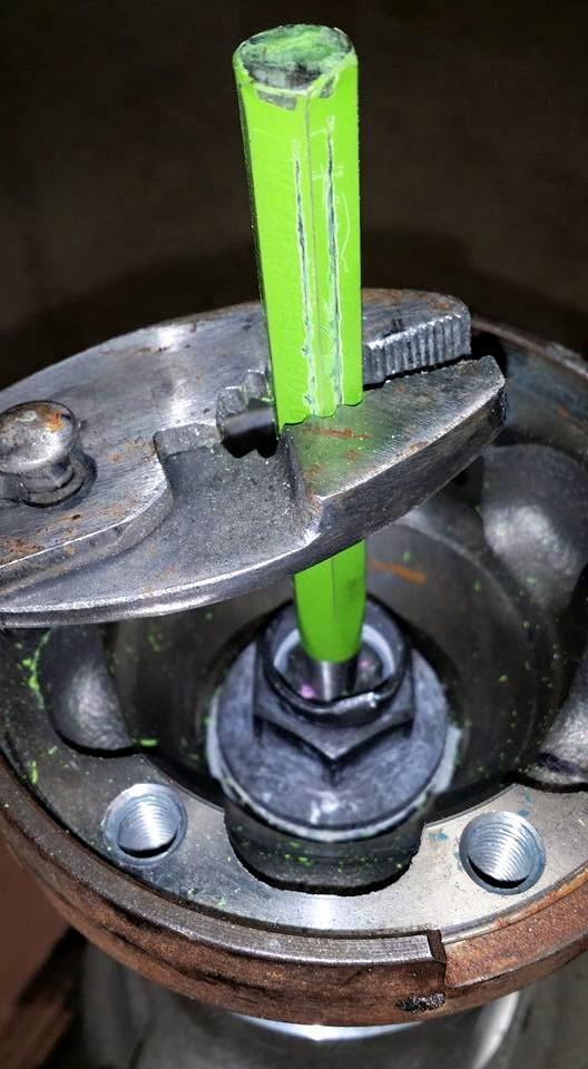

Gear change to match CJ IM
First I have to say I LOVE my DSS Shafts, how sweet it is the be able to unbolt those baby's and drop that center section out without even removing your wheels! BIG Thanks to DSS for providing such a useful feature! Second my Tuner will be happy to see that I'm doing this, now I'll be able to stay in 3rd till the end. Now there are a couple of lessons here you will see in the pics. A while back I reversed the direction on the front bolts for the carrier, because you couldn't get the bolt to come out far enough, it would hit the gas tank, you have to lower the tank to be able to get the bolt out to be able to lower the carrier. Well by reversing the bolts I was unable to use that wonderful feature from DSS of unbolting the shafts. I have decided it's much quicker and easier to take advantage of DSS's feature and flip the bolts back the other way and lower the tank one side at a time just enough to get the bolt out, after all it's just two bolts holding the gas tank. To be clear I only lower it enough to get the carrier bolt out then I bolt the tank back up, I use a jack stand under the tank so it doesn't get away. The CURT trailer hitch makes a great jacking point. You will also see I'm still running the heavy stock drive shaft. This will be changed soon, which should net us some more numbers. Oh I forgot, if you look closely you can see the mounting height difference between the two posi units for the different gear ratios.
