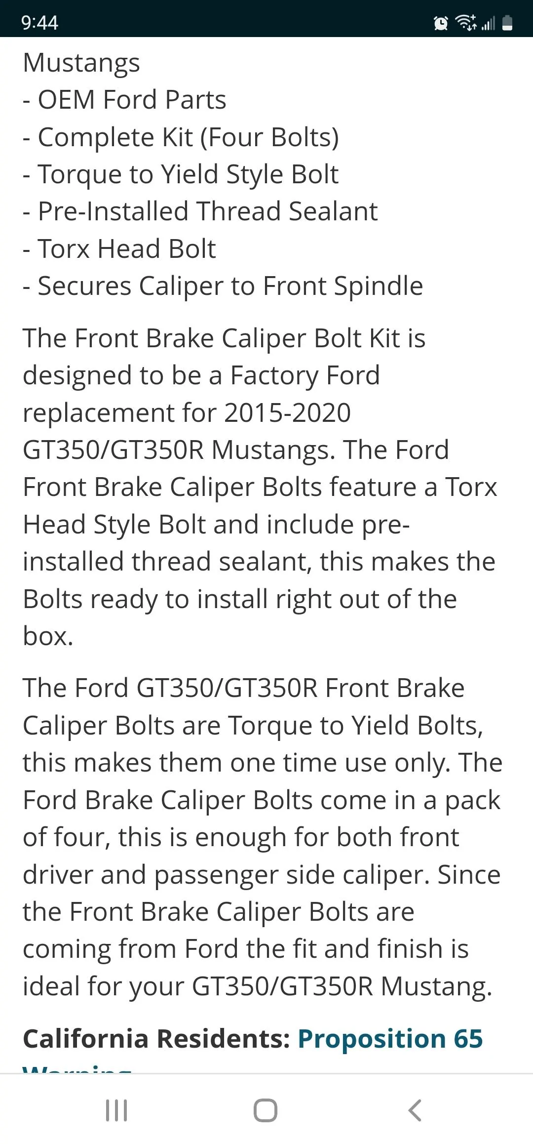

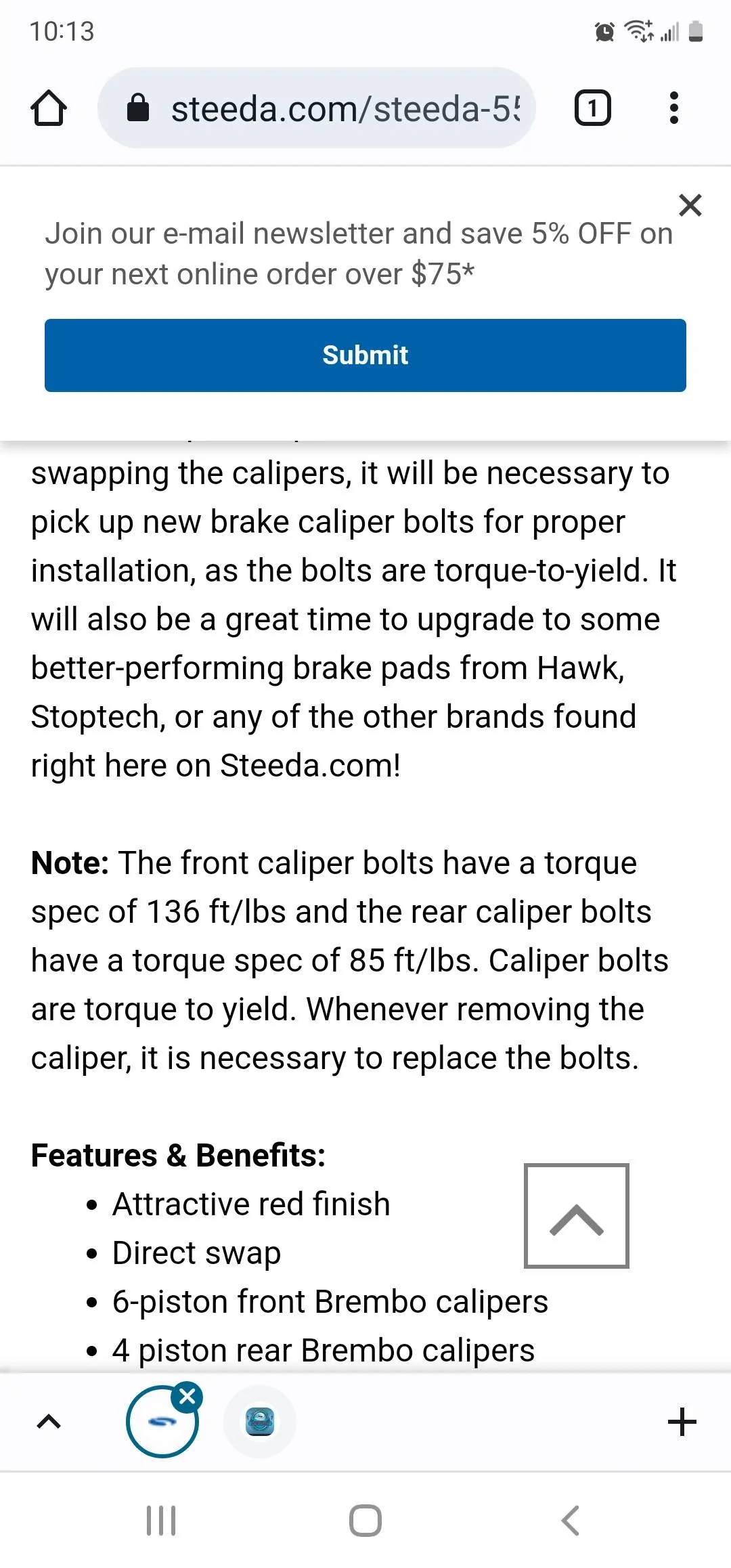

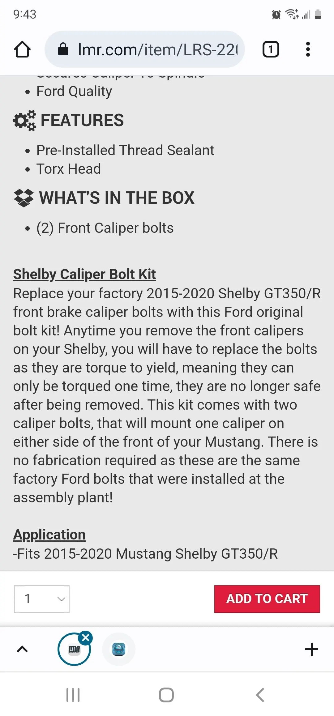

How do you know that? Seems some say they are tty and others say no. CJ Pony parts Steeda and LMR claim they are tty...people who reuse them claim they are not...
The main reason I think they are not TTY (don't trust me, I'm just guessing) is that the bolts are steel and they go into aluminum threads. If they are TTY, so is the knuckle.....
I can't explain why they're saying it. It's just not true. If you do the math on the bolts and the torque, they're around 70% to 75% of "yield". Those posts could be revenue enhancement, maybe. If you look at actual torque-to-yield specs in things like rod bolts, it's always "tighten to xyz ft-lbs and then turn the fastener an additional xx degrees". The specs for the caliper bolts aren't that. They're just plain vanilla "torque to 138 ft-lbs". The only yield is in your wallet.
