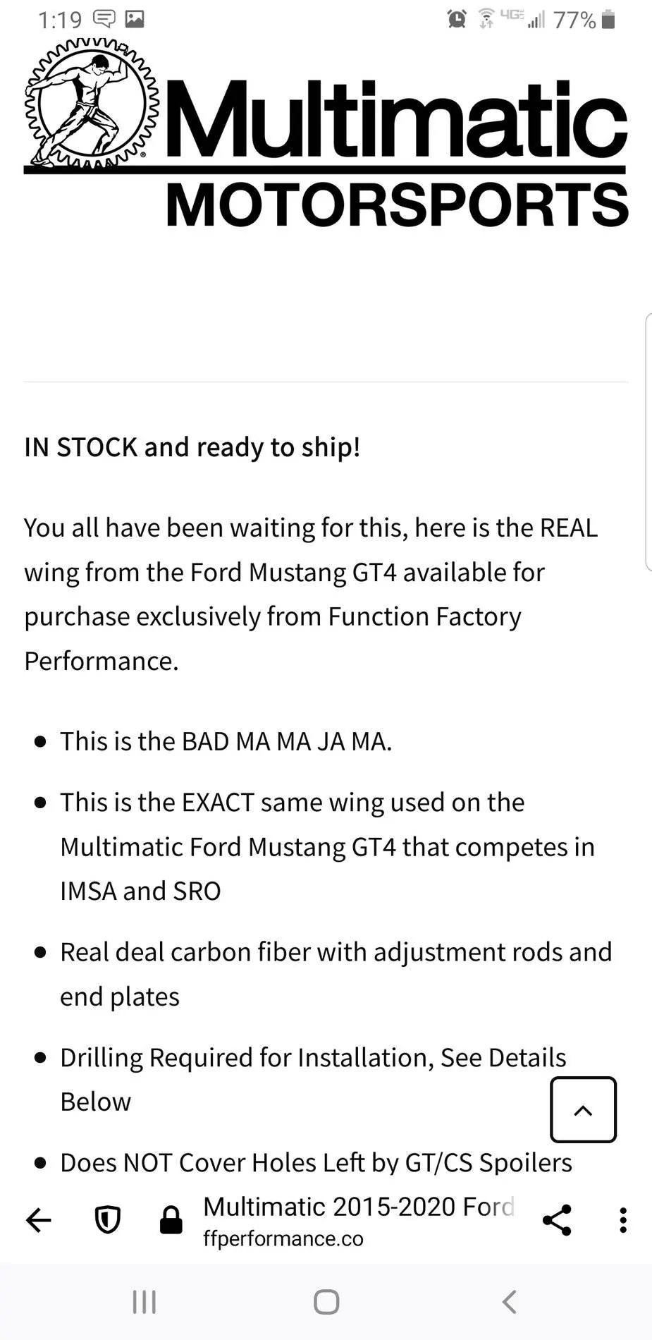

FFP has been all over the map. They are the ones that claimed to have GT4 wings from Multimatic in stock. Thanks to them I had to come up with a Plan B when Multimatic put the kibosh of GT4 wing sales to the public.

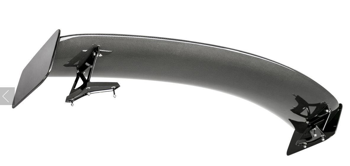

To me, it looks like wing only. No mounts.

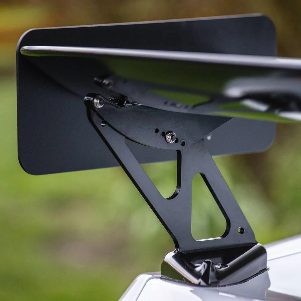

They probably should clarify but they do say Mounts with OE style brackets and hardware and then go on to show a non-OEM dogbone (I believe, need to see the other side of it to be certain) and the underside of the mounts they show is different from factory. Leads me to conclude they are included.

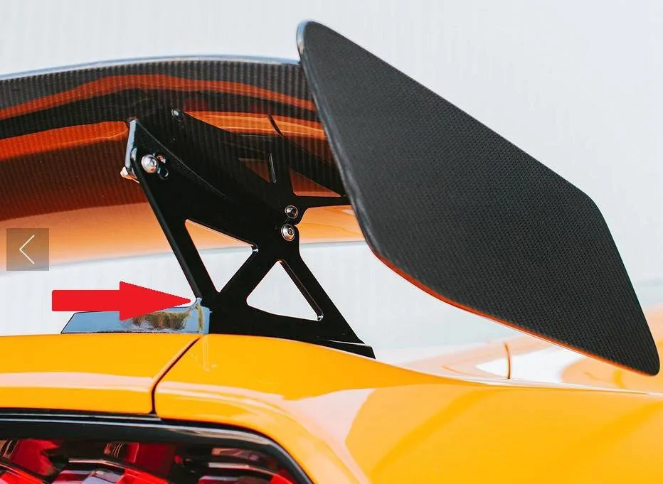

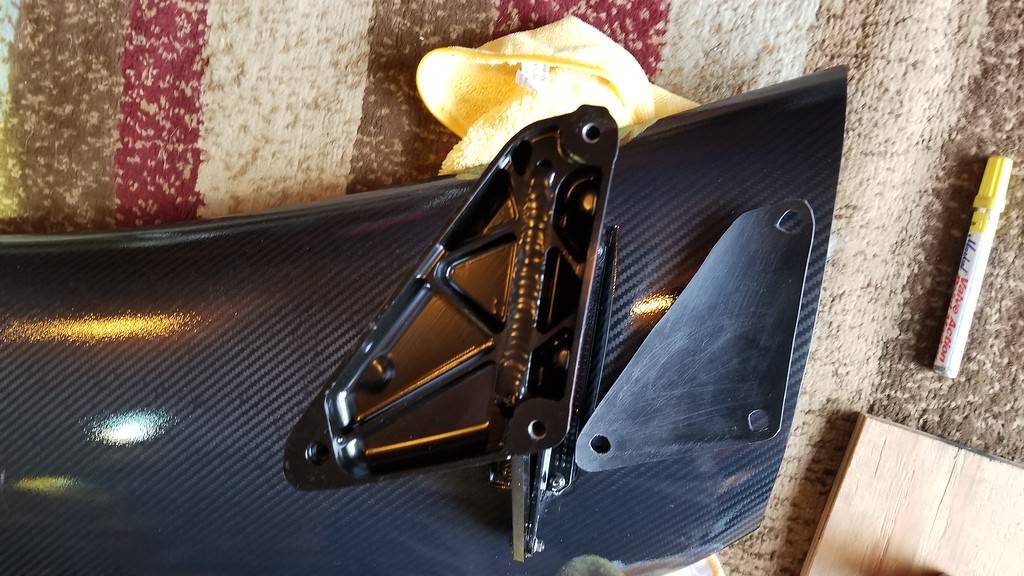

Something else...I assume the Anderson upright and base are 6061-T6 aluminum (no way they would be the OEM chopped CF). As such, it would make sense that they are doing the upright in two sections - the base as one and the "ladder" section as another. Multimatic does this with their GT4 upright and then welds the ladder section to the base. In the following photo I put an arrow to point out what I believe to be a weld as I think Anderson is doing the same thing as Multimatic. I don't believe the OEM chopped fiber has a bump in this location. Looks like weld to me.

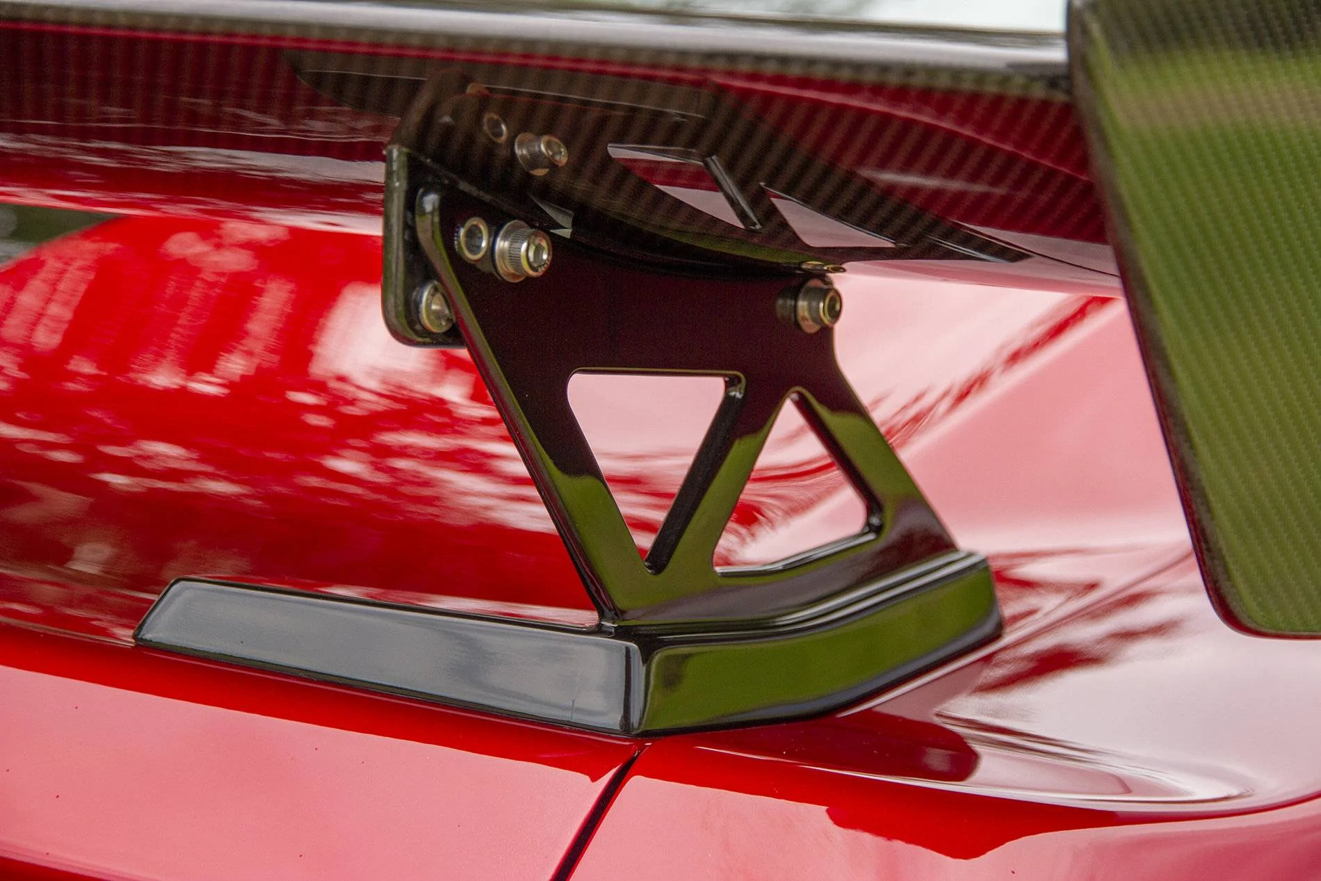

OEM CFTP wing mount, look at the same spot...
Below is my GT4 wing, note the weld in the same area where the ladder section meets the base. The front has a similar weld.
The base has a slot that the other section slides into, which is then fully welded. My guess is that Anderson is doing something similar.

Our bases are single-piece, non welded CNC machined aluminum. We made our own dog bones, they are not from another manufacturer. We tooled from the OE parts, excluding the drain hole slots on the GT500 wing. That design feature has a patent protection. More detailed images will be added to our website product listing.

Thanks for the clarification. Is the wing on the orange car using a prototype that is welded, because it sure looks like it. If your base and upright section are one piece, holy cow that is big chunk of aluminum that you are knocking it out of.

The orange GT350R we used for testing is the same bracket design.
