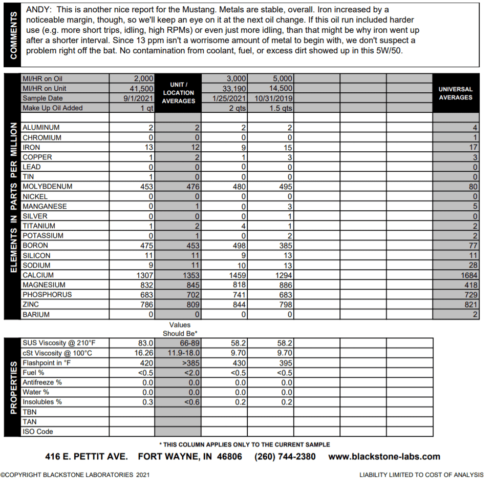

I have ceratec in my whippled 18 gt with amsoil 5w50, runs great and quiet. Ive used ceratec for 40k miles every oil change. Newest oil report is after putting on the whipple and with the amsoil 5w50, the prior oil reports were on amsoil 0w30 or 5w30 or those 2 mixed.
