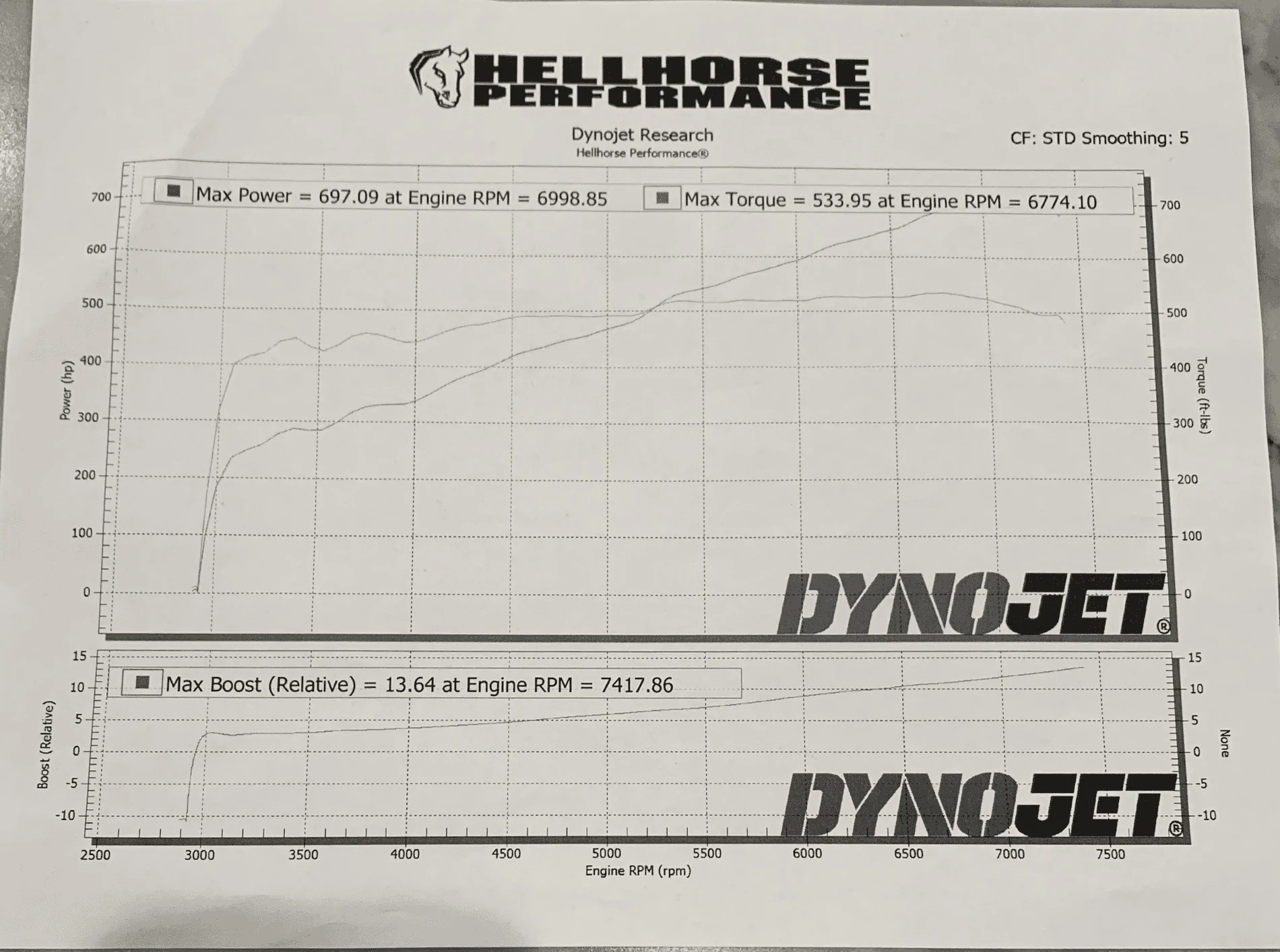

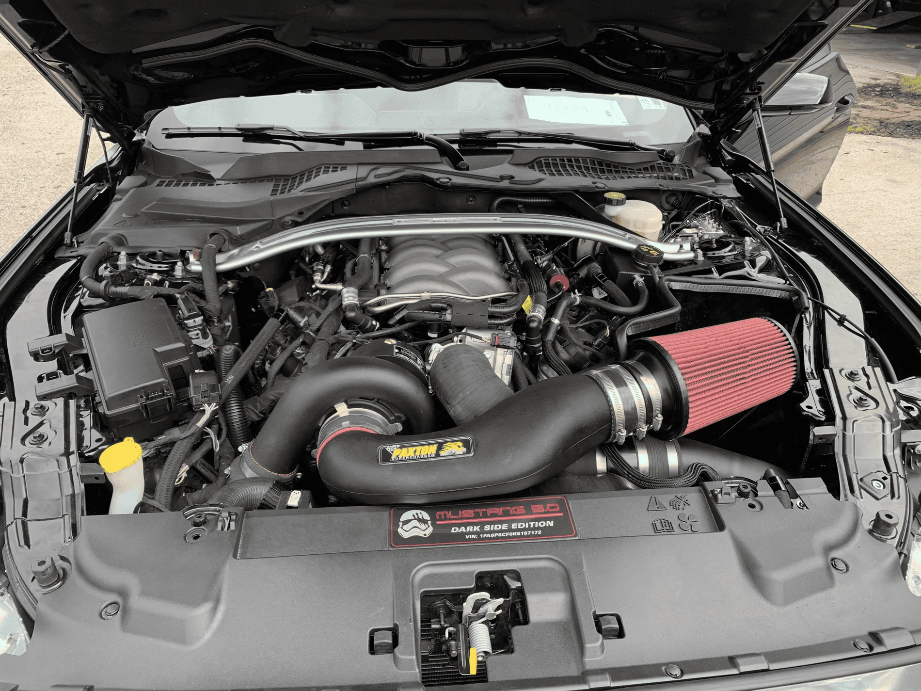

Picked my car up yesterday and it feels great to be back in a boosted car. I went with a Hellhorse Performance Paxton kit. Car made 697 RWHP and 533 TQ. I would also like to give a shout-out to Jeff and the team at Hellhorse Performance in Houston for the great customer service, work, and follow through. If your in the market for some upgrades give them a call as they went the extra mile to make sure everything was perfect.
Engine is stock to include factory headers and cats...only changes listed below....
Set Up:
Paxton 2200 SL, 3.6 pulley
FIC 1000cc injectors
Boost-a-pump
JLT cold air intake
Palm Beach Dyno remote tune
Corsa Cat-back
