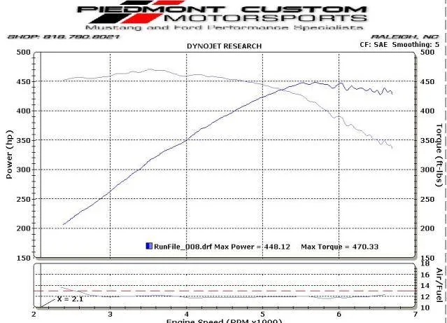

Do you still have the Dyno sheet form the cobra?
Yes. somewhere. That was like back in 2005-06. Just look up 2.8 upper pullied cobra dyno #’s. It made 460/472 through stock cats. Mods were K&N Fipk, 2.8 upper pulley, and Maggie axle back. Tuned on dyno by Sam @ Steeda. Torque was huge table top. But, it would heak soak after 1-2 pulls.

I cannot find that sheet. I know I have a picture of it in my laptop somewhere. Here is one pretty close. Looks like belt slip past 5k.
