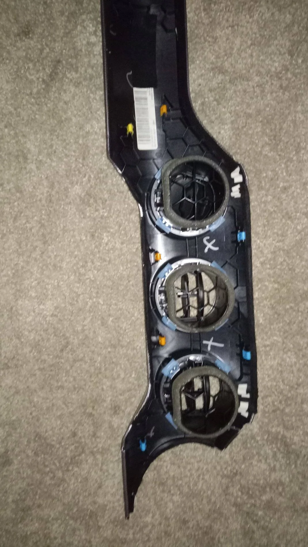

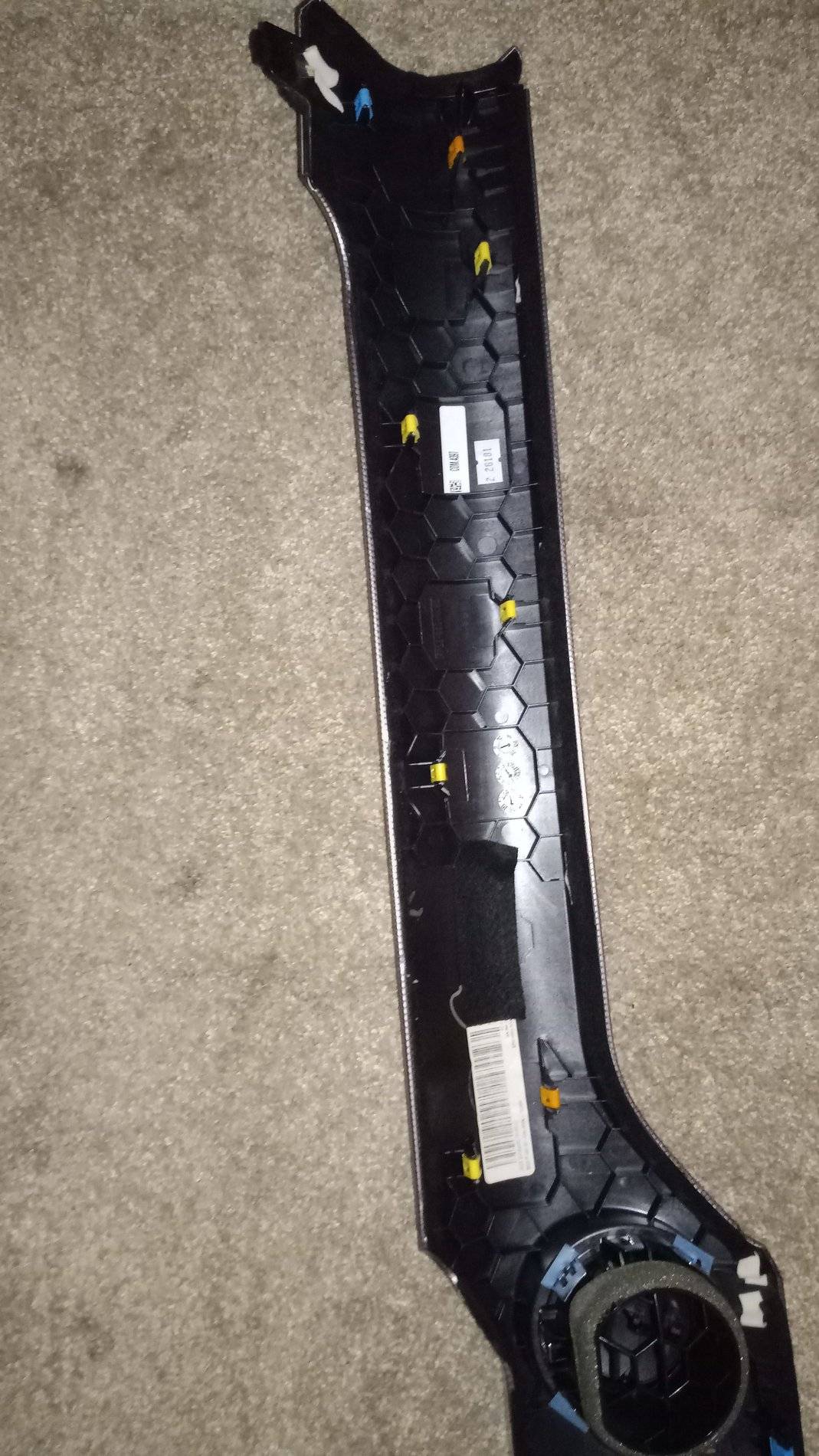

Hi everyone. Since I bought the car I've noted buzzing and rattle in the center aluminum/carbon fiber trim. I took the trim out a few months ago and put some felt tape around it but I've noted that it's still creeks over the bumpy road.
This time I took out the trim and wanted to show you guys the back part of the trim to get some advice from you on what should I do. Should I put foam everywhere around the trim that creeks? I feel like the trim is not well made and it's very flimsy rather.

For every place you see a clip on the back side of that trim - go to the dash and place felt tape over each location - wide enough so it covers a good area. Cut the slits in the felt tape so the clips press through.
Any other raised surface in that location, place felt tape where it might eliminate the creak, squeak or rubbing between the 2 plastic parts (dash and overlay).

On mine I found it was the three central vents. So I took the vents out (lots of videos on this), put felt tape around the circumference of where they contact the trim, and then clipped them back in. Now it's all solved. The felt tape made them a tighter fit, and now they don't move anymore over bumps.

Hey gang, for the vents and/or central gauges, there's no need to remove anything. I did, and still didn't fix the noises. What fixed it was shoving a small piece of rubber at the top (12 o'clock), which I cut out of a rubber washer I had laying around from some bicycle product. Made a little rectangle, shoved it all the way with a thin trim tool, and it's invisible, and zero noise now. Unfortunately, now my freaking door panels are making a racket, so will reluctantly have to remove them, and secure everything on the panels and inside the door. The last annoying rattle I'll have to tackle is the damn C-pillar one, but no idea what the hell that is. Stupid car; it's the worst I've ever owned in rattles (especially when new) by far. Oh well.

I put three pieces of rubber behind the top edge of the vent trim like ELP mentioned and that fixed it for me.

You sir are a genius. I used some round rubber washer and cut it in prices then placed it on top area of the vents. No more rattle.
This is the best advice yet. You need a cushion at every attaching point this isolates the attaching points from rubbing.
