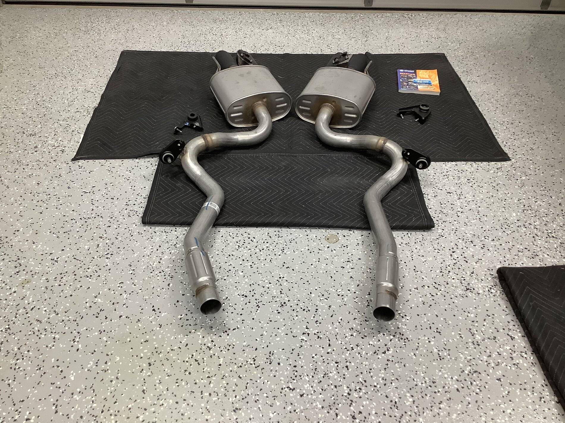

X-pipe with long tube headers is even better. Couple those with an E85 tune and your GT will see a huge increase in power. I went this route (catted LT headers) and retained my factory active exhaust and it sounds great! No need to spend money on a cat back. Here’s a pic after I cut out the factory resonator. I used a ratchet cutting tool from Eastwood to make clean precise cuts.
