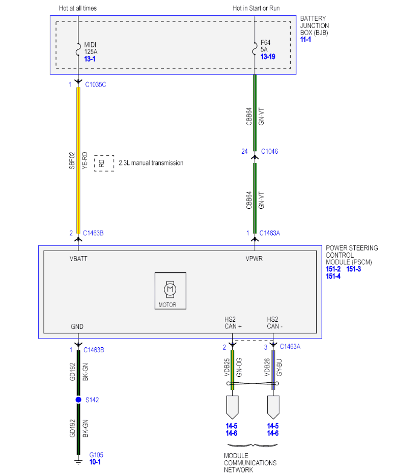

The blown fuse is a mystery. The chassis electrical diagram I have shows a 125 Amp fuse on the fuse block that powers exactly one thing - the Power Steering Control Module (PSCM). If that dude's open, the PSCM still has power on the second small connector to run its computer and send out an SOS message that it has no power on the main connector. The BCM responds to this by sending out CAN bus messages shutting down a bunch of other modules; it's programmed to do that ("load shedding") to protect what it thinks is a weak battery. So, your experience isn't out of line with what the car would do if the 125 amp fuse was blown.

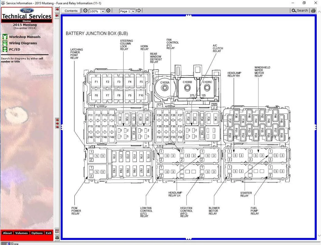

Looks like there is a “125” etched on the hot post in the top center area of this picture of the fuse box. If someone tried to jump start the car via this post instead of hooking up directly to the battery, they would probably fry a fuse below it. What I don’t know is if this can be replaced individually or if you have to replace the whole fuse box.
I can’t find a part number for this item individually.
