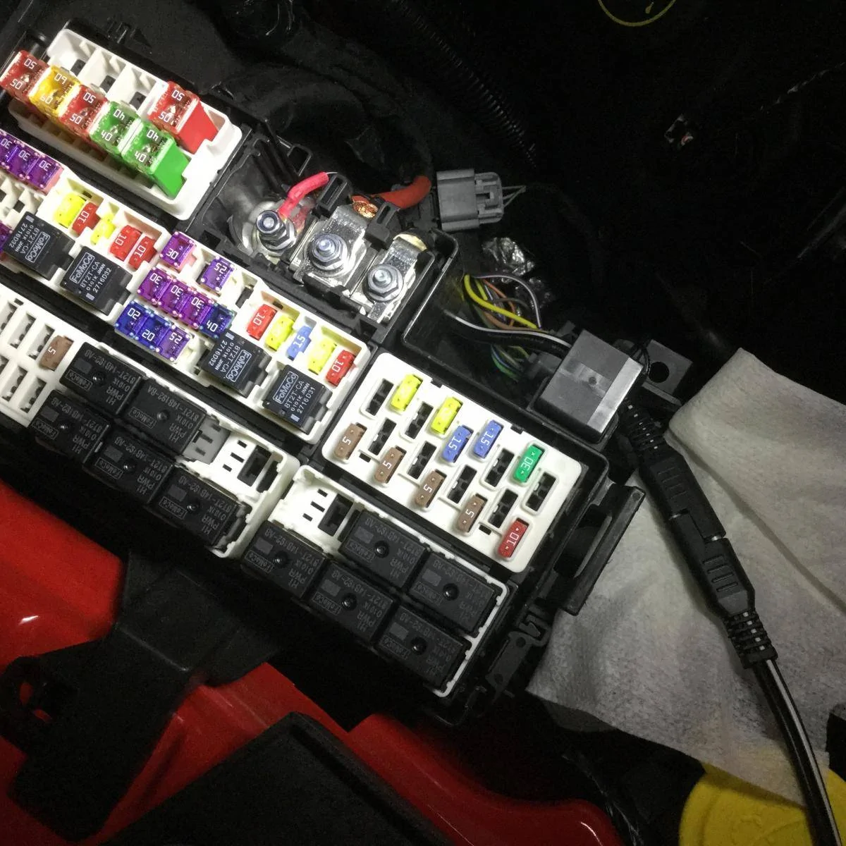

Looks like there is a “125” etched on the hot post in the top center area of this picture of the fuse box. If someone tried to jump start the car via this post instead of hooking up directly to the battery, they would probably fry a fuse below it. What I don’t know is if this can be replaced individually or if you have to replace the whole fuse box.
I can’t find a part number for this item individually.
So maybe thats why they are saying entire fusebox needs to change.
how hard is it to do this? I see 3 cables attached to it via small hex bolts. Is it simply disconnect those, remove fuse box, put new one in?

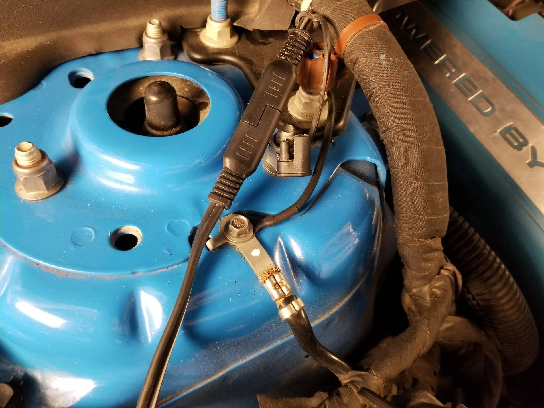

I got freaked out so I put the negative to the other ground on the strut tower. Good I hope?
c_oc=AQnExMAUUdxrgVdMkg2SuIIsuMIbBr2DJxAAD3EkGOi3tgBjqLQA5q80GOC-vNyKLHU&_nc_ht=scontent.fybz...webp
Good indeed. That’s where I have mine.

Here's a PDF of the BJB with the HIGH CURRENT, ALWAYS HOT, 125A MIDI fuse is located. It is designated as "C1035C".
Also referenced in this box and associated with limited power steering modes is 5A fuse "F64".
I couldn't get the location diagram to print so I hope the outline of the BJB will help you identify. It is on the passenger side forward of the wheel well. You can google it.
Good Luck. I hope it fixes it for you.
EDIT: It's the same diagram @The Chairman posted. It is indeed the fuse he thought.

Here's @The Chairman 's BJB photo from another thread. The right most nut on the top of the box is the 125A fuse. You can see a faint 125 stamped onto the connection.
Also, F64 is the 5A in the middle of the bottom row on the right side of the box. 5 - 5 - 5 -5 - 10.
I'd pop that nut off and see how far you can go to remove the 125A fuse. Let us know how it turns out.
