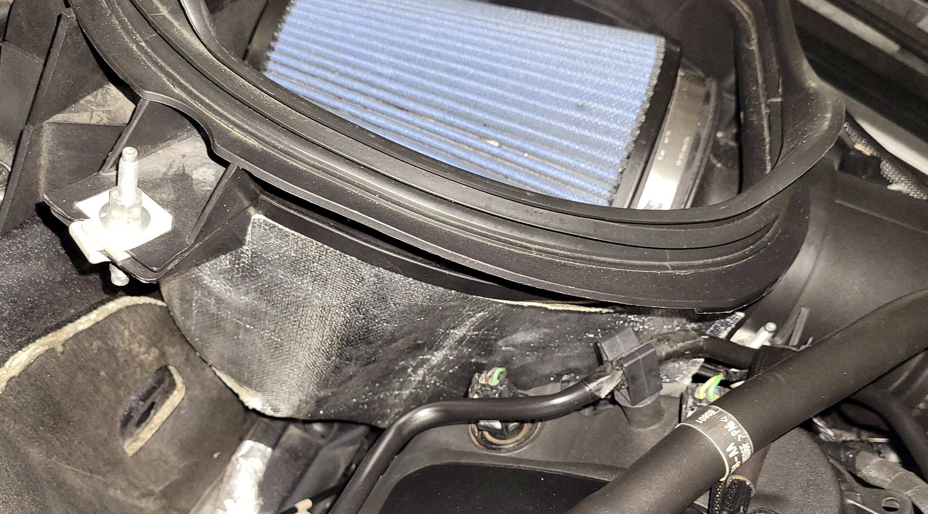

I was skeptical, but I added heat shield to the backside and bottom of the intake box. I removed the intake, disassembled it, and cut all the pieces to fit.
It lowered my air temperature by a few degrees.
Same here, using peel and stick foil shield, when I was shielding everything for track use.
Engine bay got so hot anyway that it would not stay stuck onto the ABS air box, so I gave up.
Mine is only a few weeks old... pretty sure it is going to suffer the same fate.
