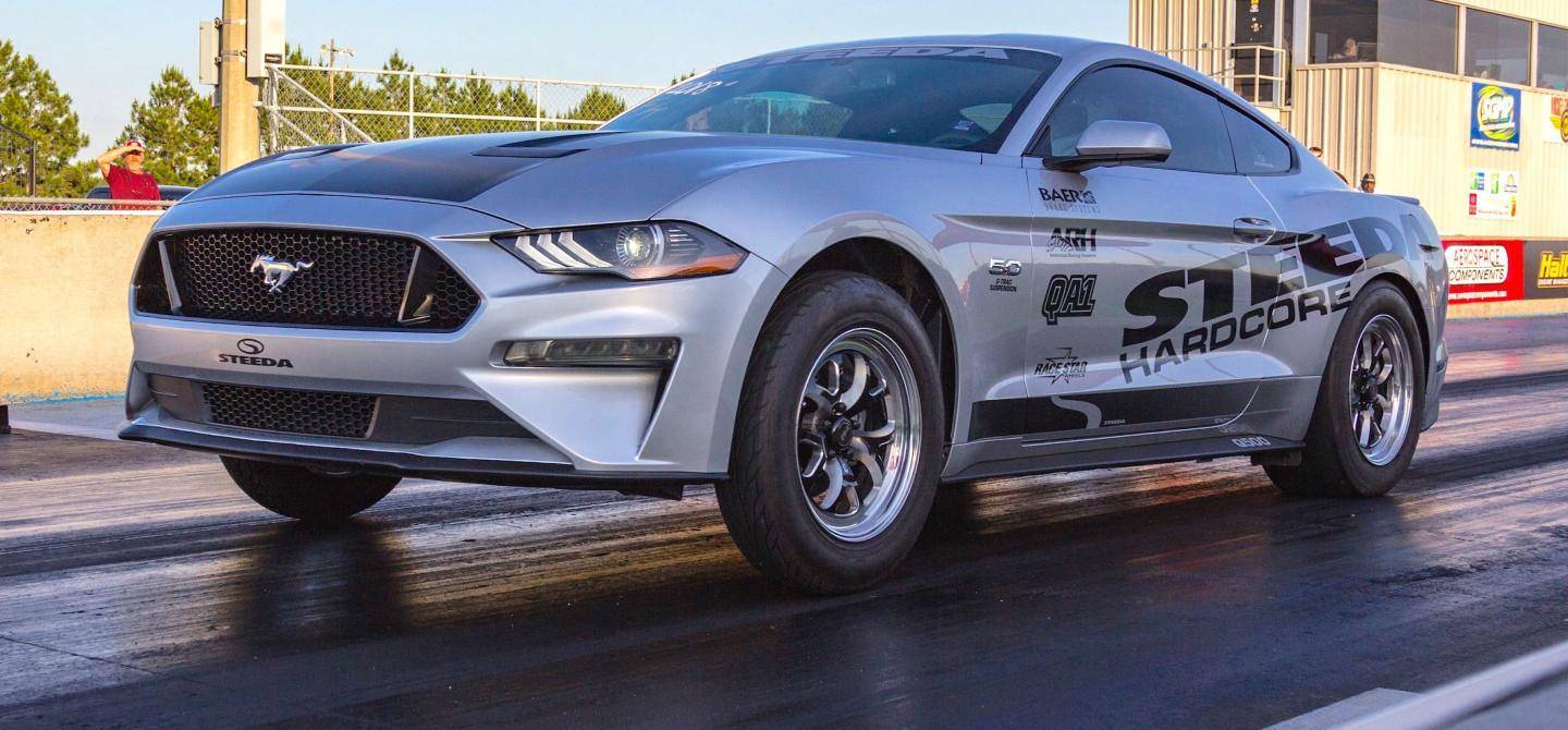

This is from July - we had adjusted some things since then ... I will have to get the updated build sheet:
2018 Steeda Silver Bullet
A10 base model, full bolt on, ALL MOTOR
3.15 gear
Circle D converter
Steeda Closed Box CAI
Lund E85 Tune, with transbrake
American Racing Headers and X pipe
Bret Barber Ported CJ intake and Mono blade
Full Steeda Suspension, coilovers and Steeda K-member
Race Stars, with Mickeys 305/45/17's
QA1 Carbon drive shaft
FRPP Half Shalfs
Baer Brakes
Anderson CF hood and deck lid
Optic Armor Windows
CM Components Rear Seat Delete
3425 race weight
R/T........ .465
60'......... 1.47
330'....... 4.28
660'....... 6.58
660’ mph....... 107.02
1000'............. 8.57
1320'............. 10.25
1320’ mph….. 134.16
race weight w/driver: 3425
Name of the track: SGMP
Date of pass: 3/8/19
Weather conditions: (include the Density Altitude if possible): +350 ft
