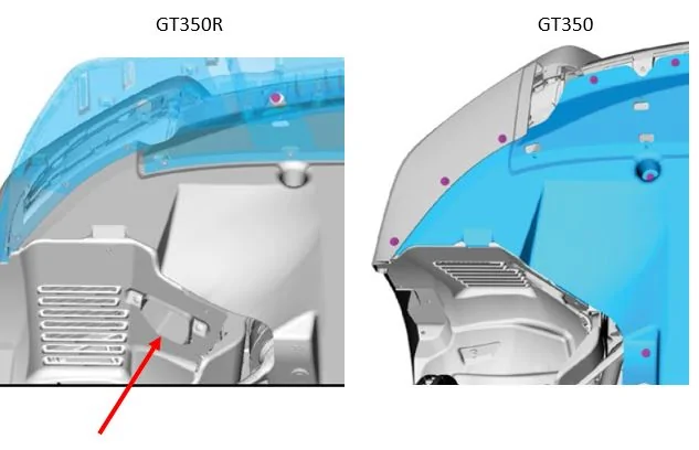

I didn't realize that the GT350R has separate brake cooling ducts. I would think they could be retrofitted to a non-R. I noticed this while reviewing the oil tube installation instructions.
I have a track pack and I have those ducts.
