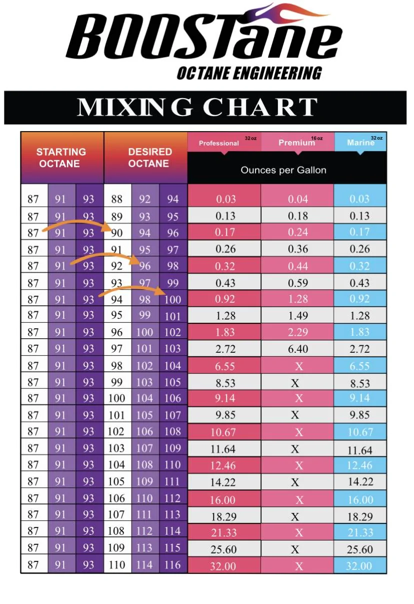

Do you dump the entire bottle since there is no mixxing chart for that? I was thinking if using the mixing chart of boostane as a reference tbh
8 oz of VP for every fill up

I use the boostane professional and decided to buy some 2 and 4 oz bottles so that I could just fill them and not have to measure from the can each time. Works for me when I want to run some.
They also sell "shots" which I believe are 4oz bottles you can use for on-the-go.
