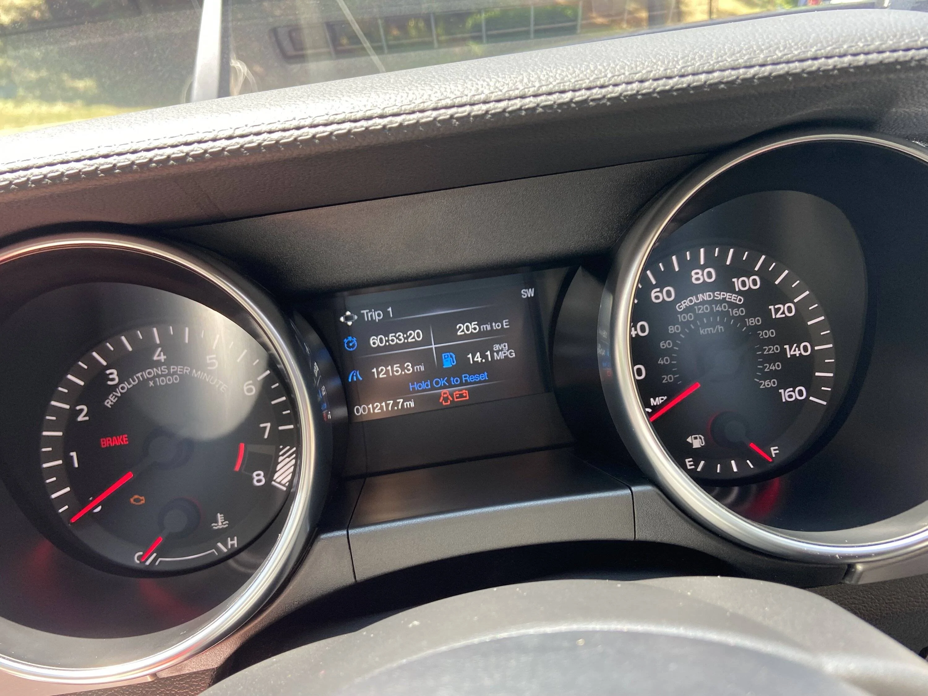

Not sure where in NOVA you are, but I'm pretty sure there is a station in Woodbridge.
that one's even farther than the royal farms in md for me lol. Now I'm debating that royal farms but I'd be getting under 200 mi per tank the way I drive... time to research who does flex fuel tunes
