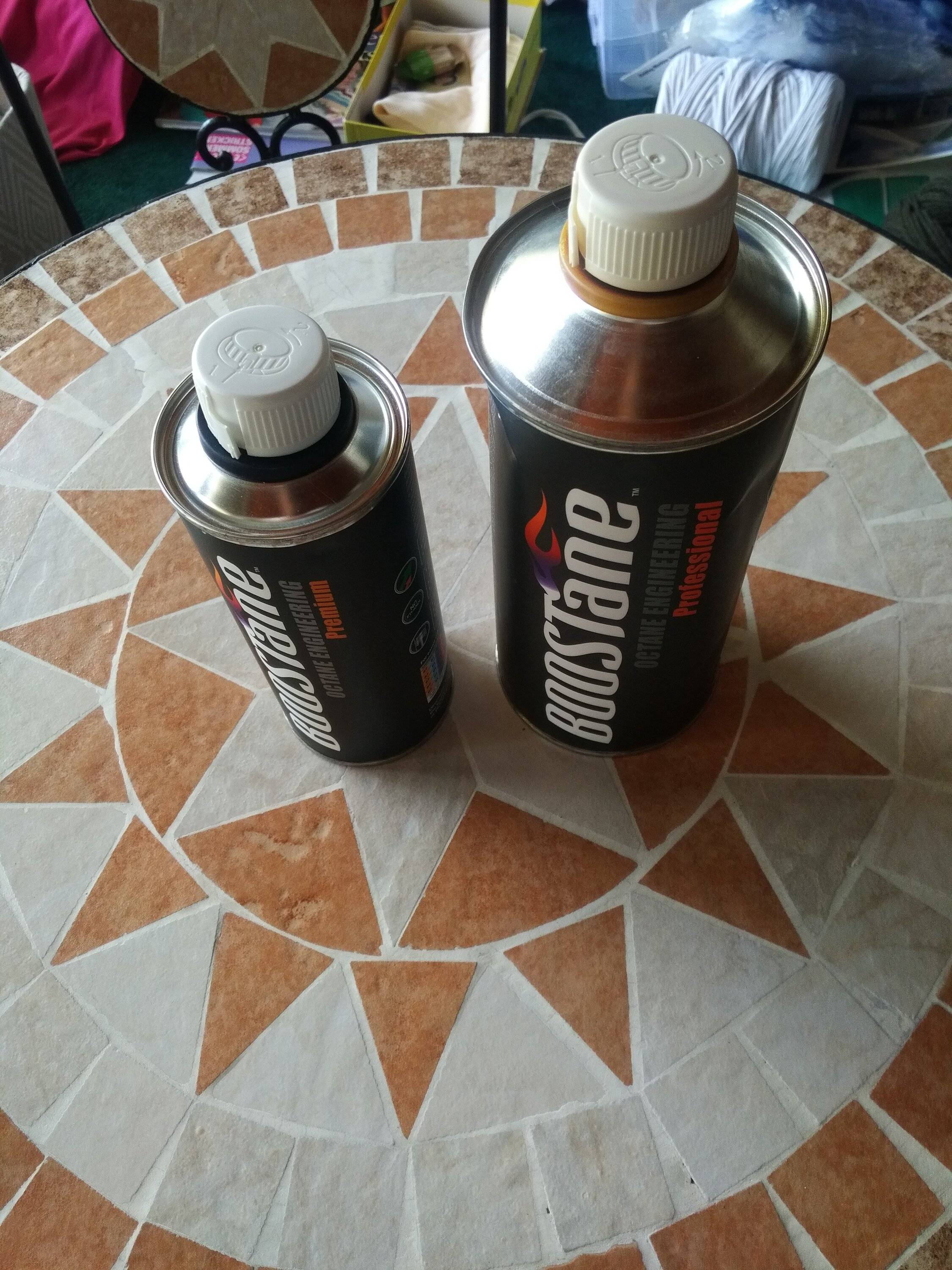

I put one can of 32oz Premium to one tank of gas on fill up. I now have a case of 16oz Professional and just want to make sure I can use one can.
Doesn't boostane professional come in 32oz bottles too? Never seen 16oz bottles. Also how much boost/ timing are you running?
Yes they typically come in 32oz cans. I've not seen 16oz cans of Professional. But that doesn't mean there aren't any out there.

I have a case of 30 little 16oz Professional cans
I'll get pictures this weekend.
I stand corrected.
