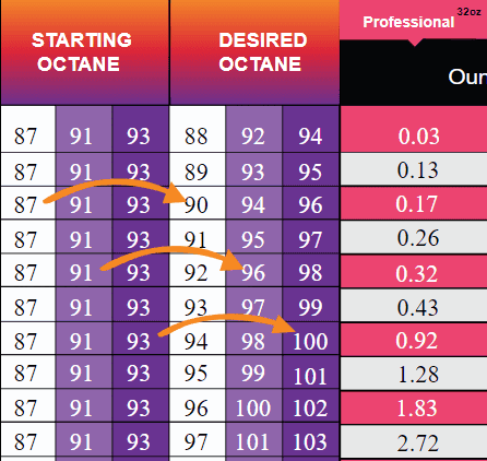

Another dumb question here but just want to be 100% sure so I'm not wasting ounces.
For the professional boostane (32 oz), I just need ~2 oz for the entire tank (16 gals) if I want to bring it from 91 to 93 based on their chart?

Correct on the calculation. I bring it to the gas station with me and put it in before filling the tank. This way it at least mixes some while you're filling. Then drive a few miles and let it rip.

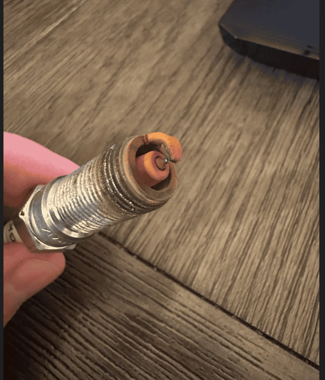

Let me give you some reality. This was half a can to a full tank. The plugs were new before that half can, and I pulled them when I was almost empty to see the effects from one usage.
MMT will turn everything orange. Plugs will live for a while until they get caked up.

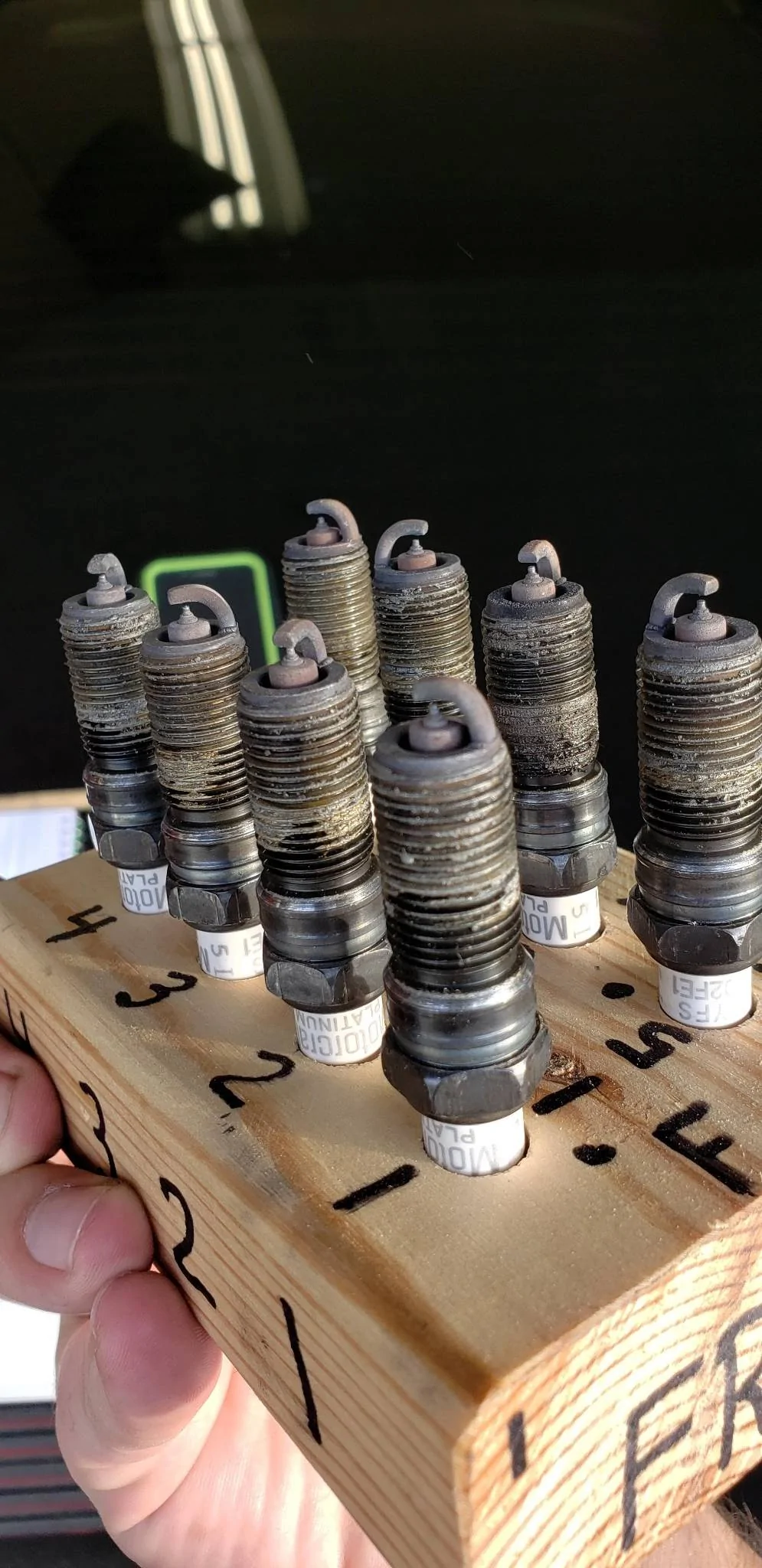

These were mine after 6kish miles of running 1 bottle of boostane shot every fill up. Stock Ford Performance Motorcraft 1 range colder plugs that came with aluminator gapped to .028 by shop who did install. Motor had some headgasket lift and several raised ringlands. Was still making over 730whp in hurt condition. 819 whp on 3.5 pulley when first broken in/dynoed.

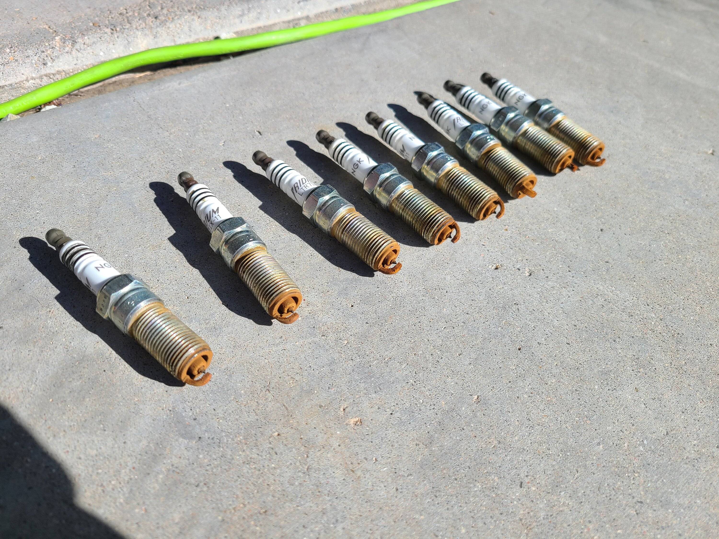

Mine after about 11k miles of running 8oz boostane professional per tank.

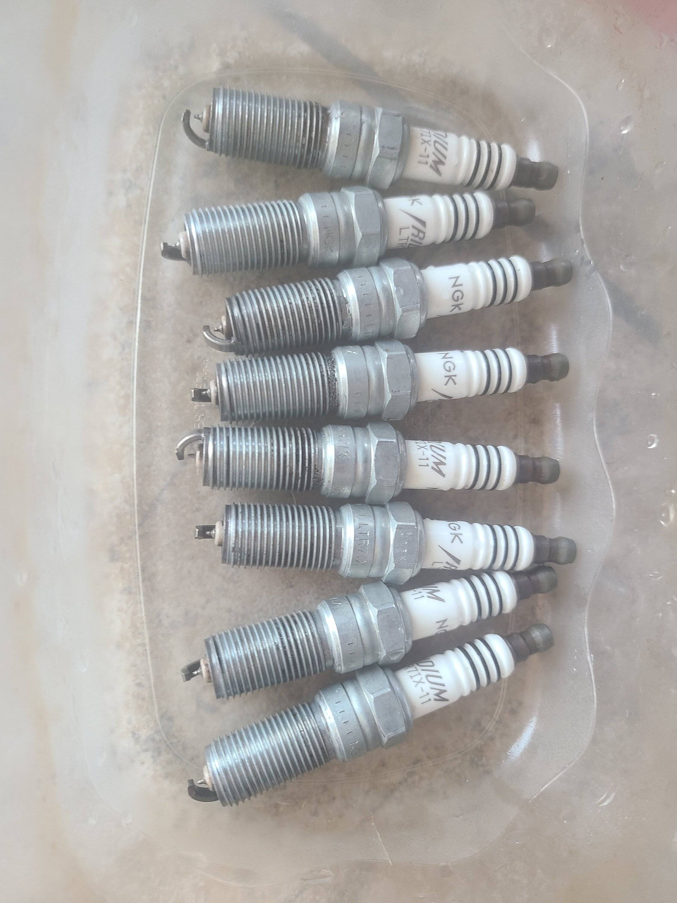

And after cleaning them so I can get another 8-10k out of them.
