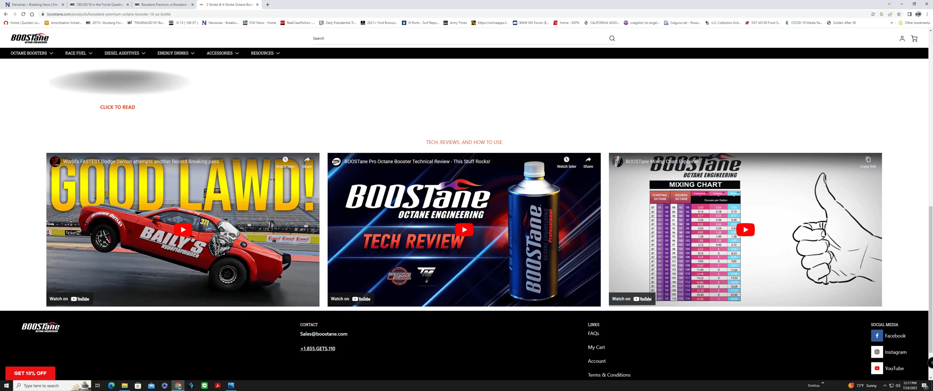

To answer your question though, here is the mixing chart. It just shows you need to mix less for the desired octane.
