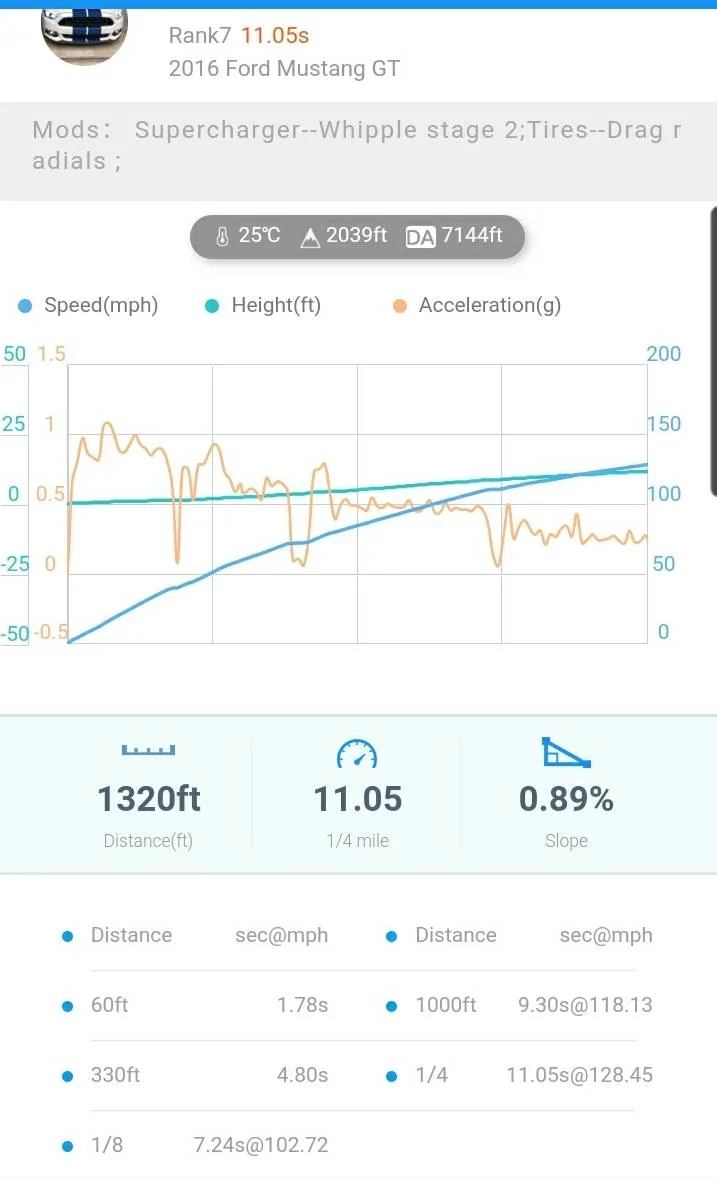

this is a whipple gen2 stage 2 with fuel style return system hoosier drag radials pbd tune on e85.
3.50 pulley.

^ Where are you located/where was this ran done at?
