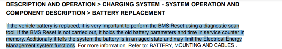

Sorry if it was burried in the thread, but where's the "why"? Why does this reset procedure need to be done? What does it accomplish? What bad thing would happen if you didn't do it after instaling a new battery? Just learning!
It tells the car that it has a new battery and then uses a charging stratagy for a new one. If you don't reset, the car will think the battery is several years old and will not properly charge it.

Because the Ford Manuals says too, doesn't matter why even though I know it is to reset the system TO relearn.

The car uses an adaptive, intelligent charging strategy, which depends on several criteria, one of which is the age of the battery. This strategy not only increases the overall efficiency, but most importantly, it prolongs the life of the battery. If you install a new battery, but the system charges it as if it were old, you won't get the best out of it and may even have other issues, like the load shedding feature activating when it shouldn't.

To me, I look at it like this. Battery dies and once that happens, the system gets drained of all power and stored energy. Thus the BCM should reset. I'll see what happens the next couple of years if I still have it by then and a battery is under 200 bucks.
