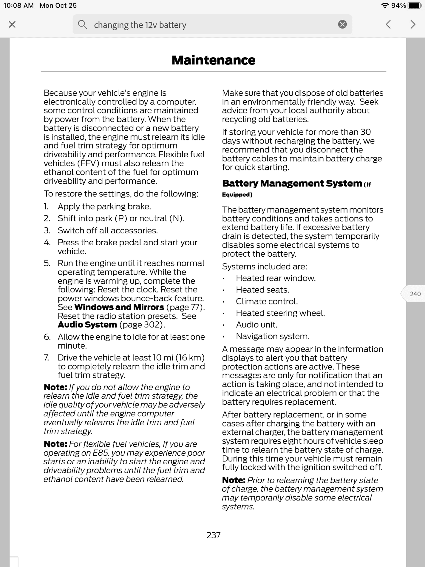

Presumably the scan tool is used because it would be available in a Ford shop. The below, from the (2018) owner’s manual.
I can honestly say I was keeping my car unlocked during the winter during charging, not charging, removing etc, I must have overlooked reading this procedure in the manual. As far as the Idol and drive after battery replacement/Disconnect/Reconnect ETC? Same, Same.

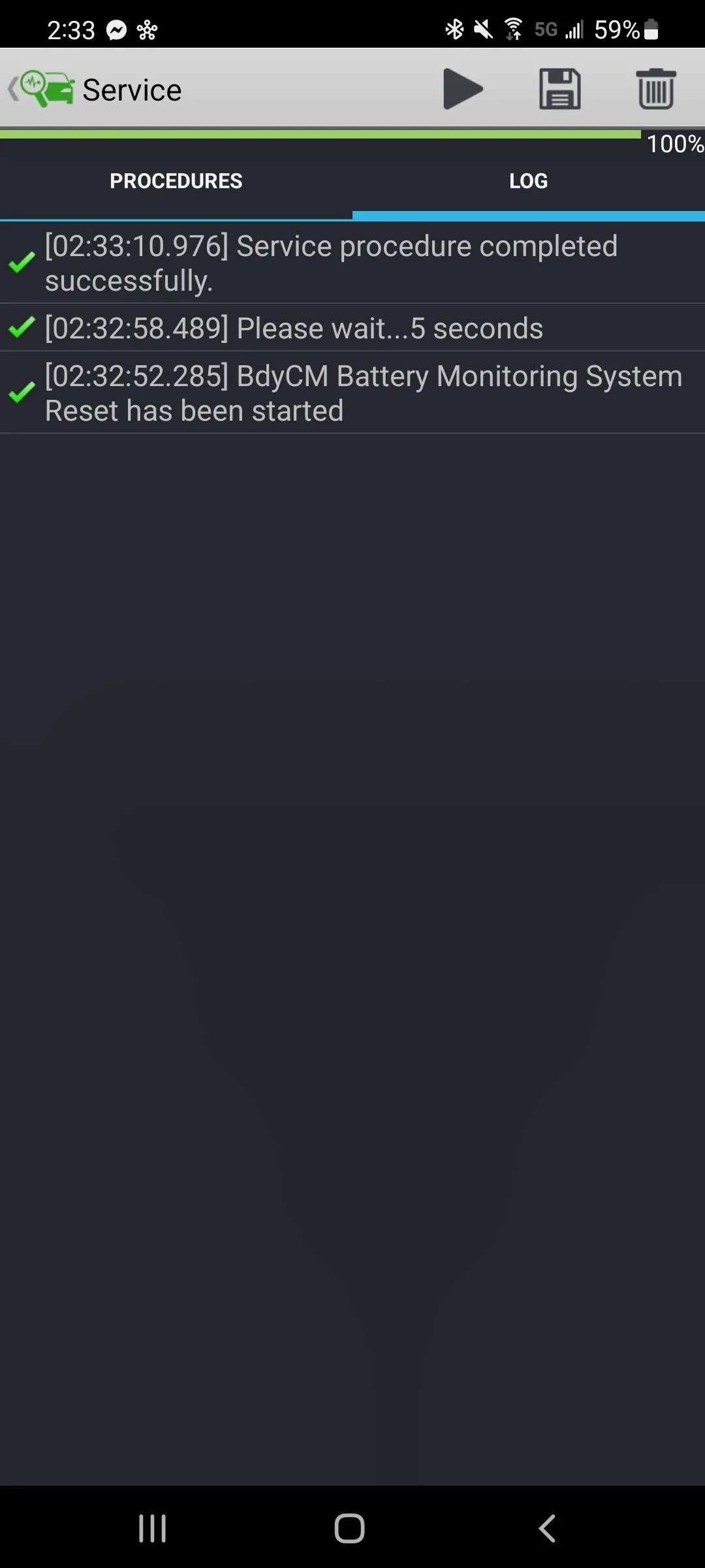

This didn't work on my 2020 for some reason. But luckily, ForScan Lite does have the BMS reset function under the Service section. This is something that wasn't immediately apparent from casual googling, so hopefully this helps someone, eventually. As far as if it's actually necessary versus the 8 hour magic wait time, I would think that it's necessary to do both based on what I've read. The car can't determine battery age from learning its state of charge (although it can probably determine the battery type since AGM cells have slightly higher overall voltage).

I happened to try this when I swapped my battery out. I got the flashing battery light, but can confirm this did not reset the bms nor did letting it sit for 8 hours. Forscan is easy and thankfully I have it. If you switch different batteries like to an agm I would do a proper reset or let the dealer do it. If you notice your battery voltage varying and not staying study that's a sign the bms needs a reset.
