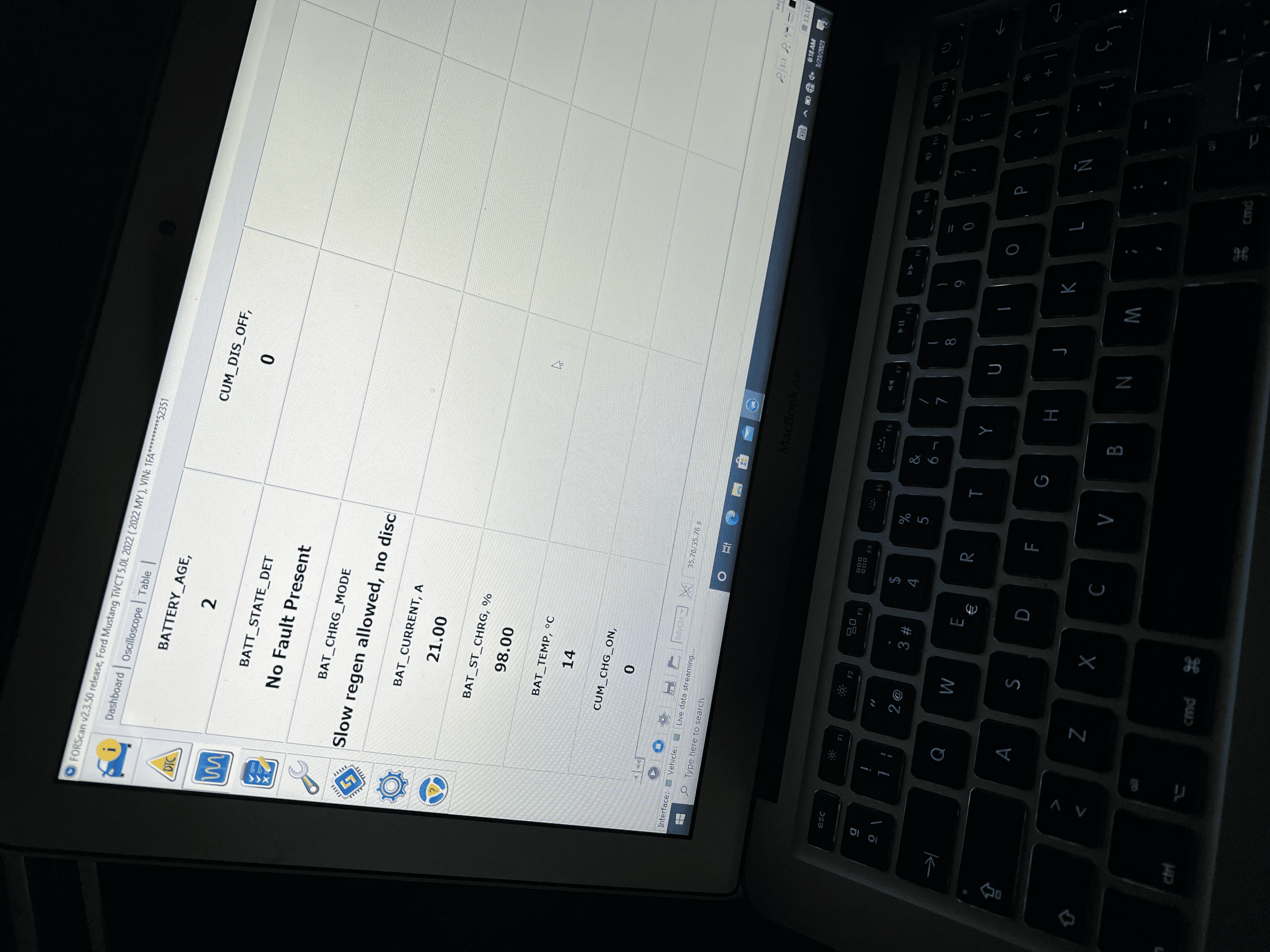

********UPDATE MADE IT WORK*********
OK, so in order to make the variable voltage from the alternator work, you need to do the following after swapping the battery, changing battery type in forscan or making a bms reset.
1. Leave it for at least 10 hours fully locked and charged
2. Reset PCM, resetting PCM without making the car go to sleep for 10 hours wont work... after this it should immediately work .
Reason is when monitoring BMS via forscan the Battery State Detection algorithm it requires around 10 hours to calculate the real state of charge of the battery, if it doesnt know it, the variable voltage will not work, it will default to 14.5 volts constant.
Why you need to reset PCM for it to start working is beyond me...
So I installed a AGM battery, modified the as built data from flooded battery to AGM, waited 10 hours, made a PCM reset and it works.
It was a bit of a pain to experiment and find this out, so I hope it really let's the engine make more power by freeing the alternator.

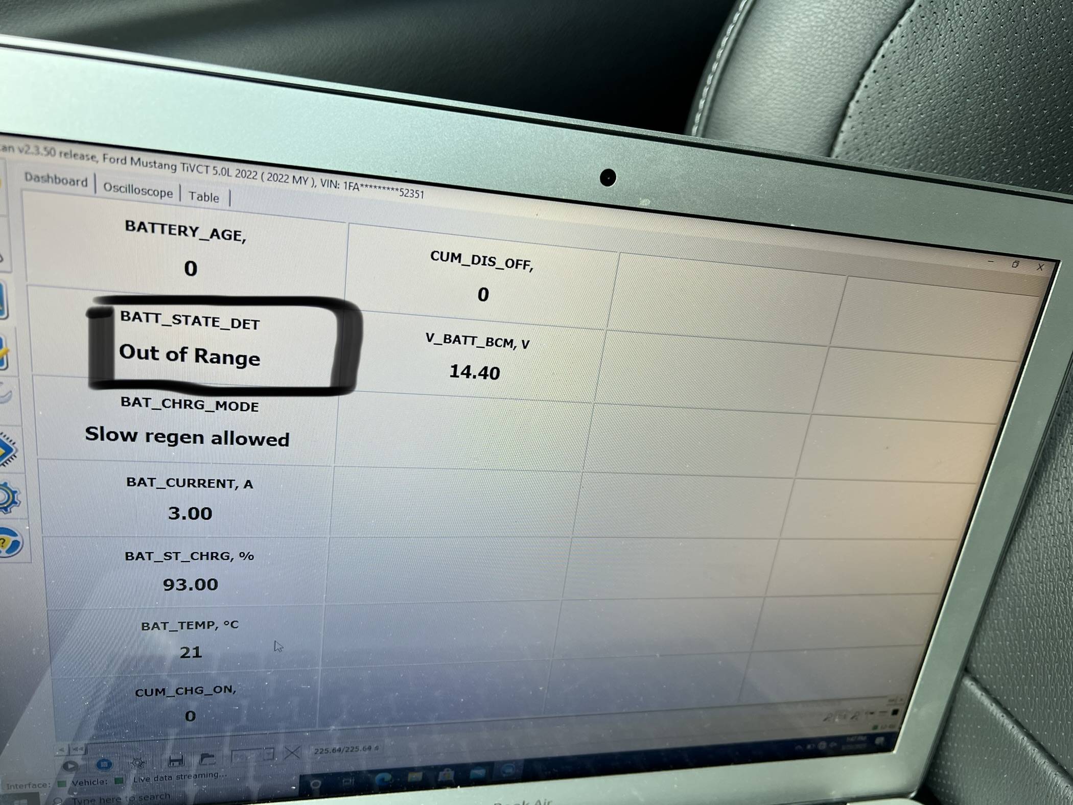

Thanks so much for your comments:
I did charge the battery several times…
Battery state of max charge is set to 80%
What I find strange is the value squared off in black:

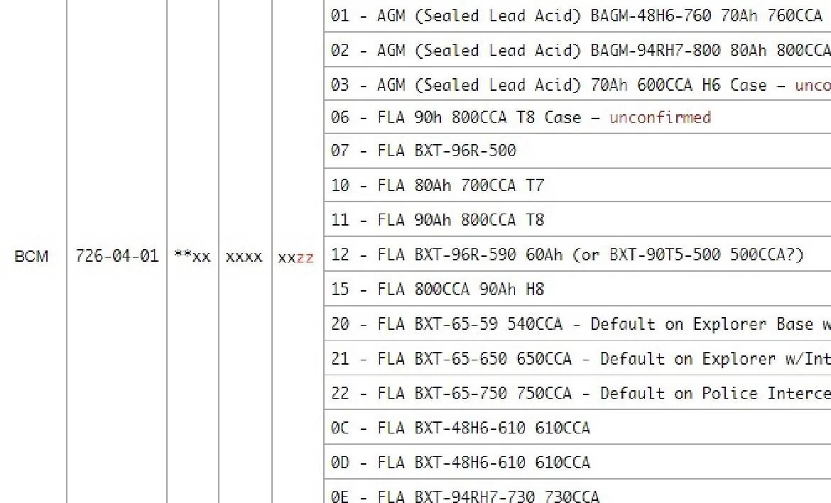

That is very unusual. Can you see what type of battery the car thinks is installed anywhere?
Yes… Flooded as it was the OEM one.
My factory OEM data shows “15” but not sure it applies to the mustang, mine is a 2022 Mach 1.
