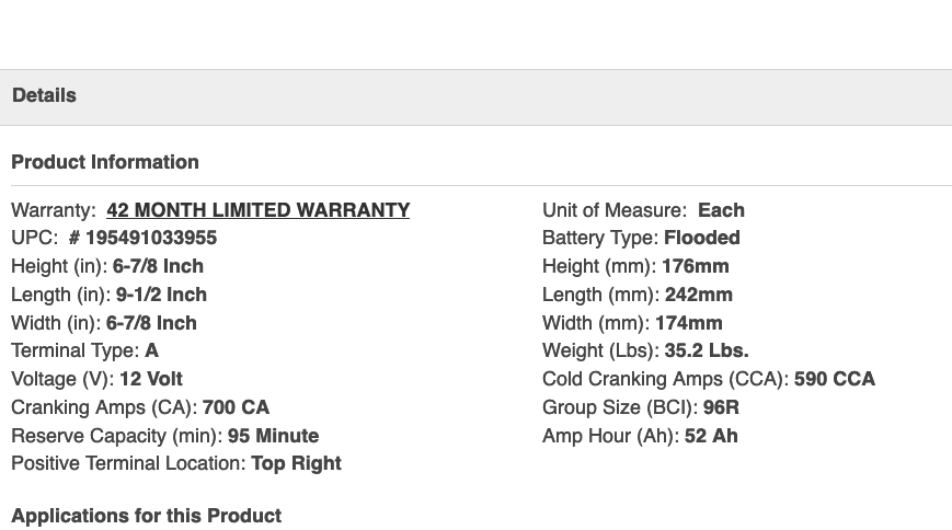

General brand battery knowledge, cause I just discovered it. Replacing the battery in my wife's car. 10-year-old battery, working just fine. The age and the fact that it's in the rear, in the trunk, behind the PS fender, is the reason for the swap.
AC Delco removed, and replaced, lots of opinions about battery brands tossed around on the site.
It struck me, that the AC Delco has not been mentioned.
So I did a bit of what is offered for the Mustang. After all, I just replaced a 10-year-old Delco for no other reason than its age.
Here is what I found and think might surprise, or at least enlighten some.
Exact replacement for the factory box:
ACDelco Size 96R
pn # 96RG flooded
$169xx
It gets better V
IConclusion, not too shabby I'd say
Cheers

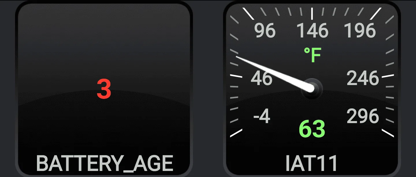

I installed a Ford AGM battery and tested this method. Confirmed with forscan that it worked.
Rapid Red
Nov 4, 2019
5,049
4,096
Woodstock GA
Greg
Interesting did not know that was possible with Forscan :thumbsup:
