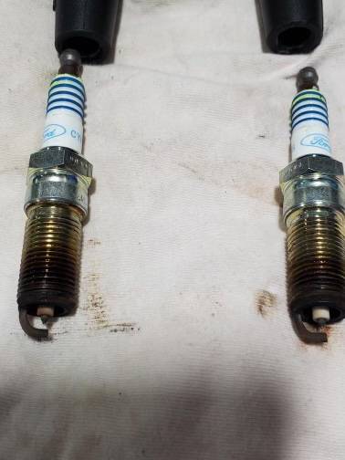

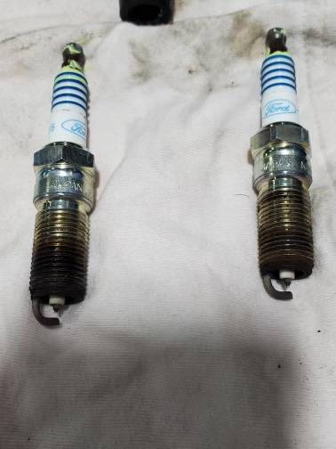

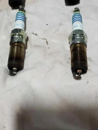

None of the plugs really look too terrible. Blue smoke on startup and after sitting is usually valve guides, just because the oil drips through the seal and either sits on the valve surface or drips into the combustion chamber. Technically you can replace the guides without removing the heads if you fill the cylinder with compressed air and get the right tools.

Yeah those plugs are as soon as we noticed the smoke, might be pulling them this upcoming week to check them out now. But none the less, I’m thinking it’s the valve guides.

Ok your on the wrong track. Blue smoke is fuel white/grey smoke is oil. This is not a oil problem if the smoke really is blue. Those plugs look fine no signs of burning oil
Start looking at injectors, tune

Where did you hear that? Grey/Black smoke is fuel typically. There's no absolutes with oil smoke, because often it depends on the situations in which it's burning, which oil, etc. But blue and white are possible colors. But I've never heard of excess fuel smoke being blue.

No you’re right I got turned around. There’s no sign of oil burning on the plugs. So if this is a cold start problem all there is valve guides or fuel. If a leak down test is good look at the smoke close because it is possible that fuel is the problem
