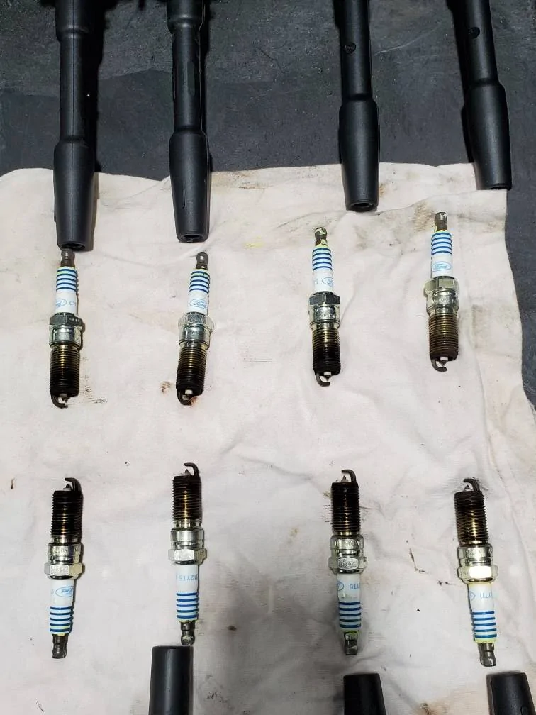

What were the compression numbers ? How'd the plugs look ? Valve seals tend to foul plugs quickly. Worse case is the cylinders took on a 'barrel' shape. narrow top and bottom fat in the middle kinda thing.
To be quite honest I forgot the compression numbers, I vividly remember only one cylinder being about 3-5 PSI lower than the rest. However, check out these plugs.
