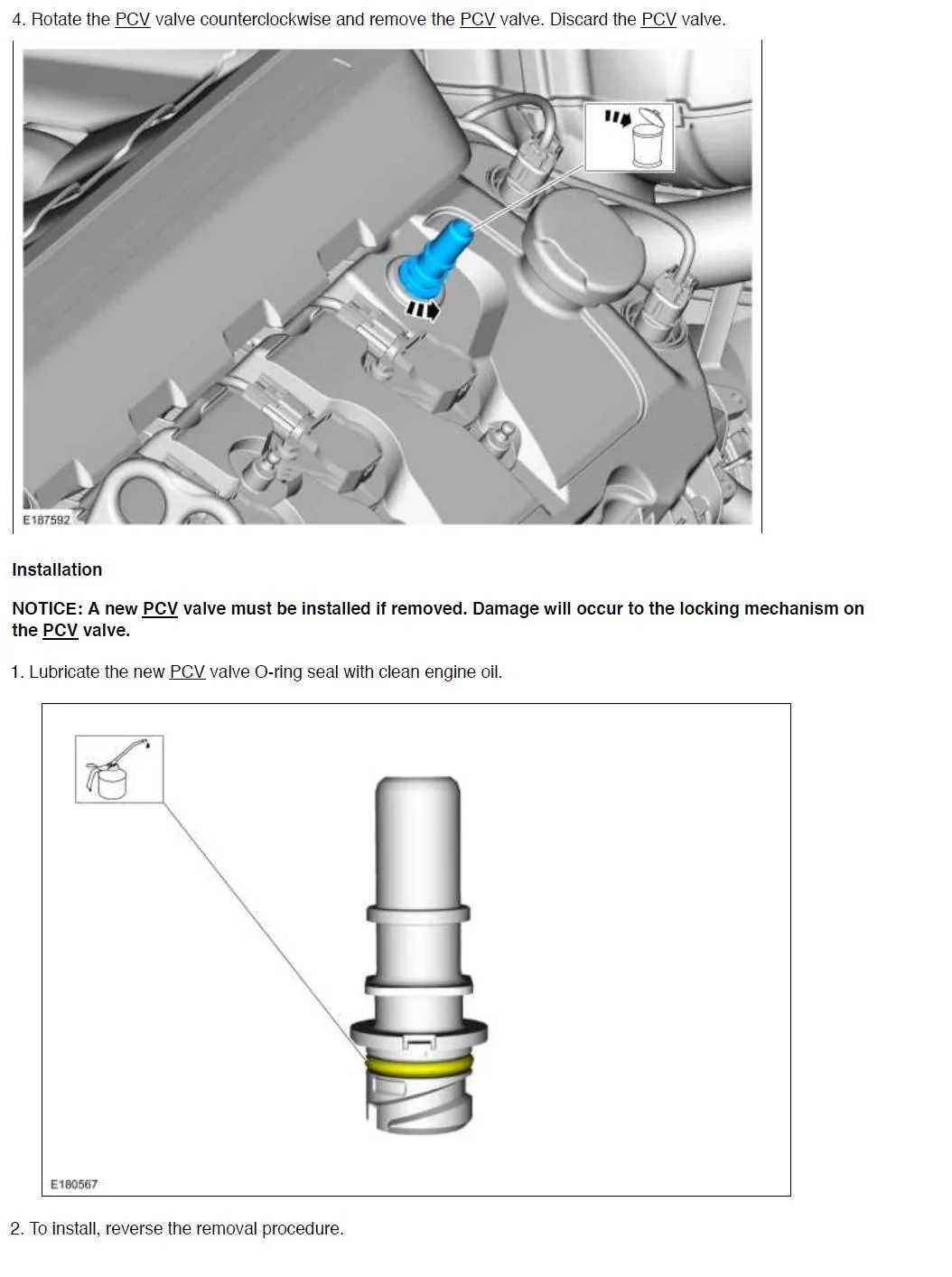

HI EVERYONE
I have been concerned about the oil consumption.
It's been stable so far, but it is high.
Then, I went to dealership and talked to the "master technician", which is not a shadow of a "master"; maybe not even a good technician.
He disconneted a double-edged hose and had access to the pcv valve, which he did not take it out for some reason.
I was along with him asking why; he DID NOT EXPLAIN WHY.
But I could notice that he did try to take it out but pretended he did not with the excuse "not necessary".
And the PCV valve was left loose.
He blew inside it with his mouth (YES, HE DID THAT) and said it was all right.
I was expecting him to really take it out and test it, by shaking it and hearing the sphere up and down.
Then he put on the double hose again.
The minute I left the dealership, I noticed the car running not as sharply and quickly as it used to be.
THE THING THAT CAUGHT MY ATTENTION WAS THIS: the PCV was kind of loose.
Now, I ask you: MAYBE IS THAT THE REASON THE CAR IS DIFFERENT?
I cannot think otherwise.
Probably some air escaping?
I am very annoyed by that situation...car was flying like a rocket.
Now at aroung 2kRPM I feel some hesitation; not a immediate answer like before.
Mainly with high gears.

Here's an important note in the manual. If the tech removed the PCV valve, then the locking mechanism might have been damaged and it's now not tight and sealing well. Manual says to install a new PCV valve if the old one is removed.
I would go back to the dealership and point this out and have them install a new PCV valve for free.
Installation
NOTICE:
A new PCV valve must be installed if removed. Damage will occur to the locking mechanism on the PCV valve.
