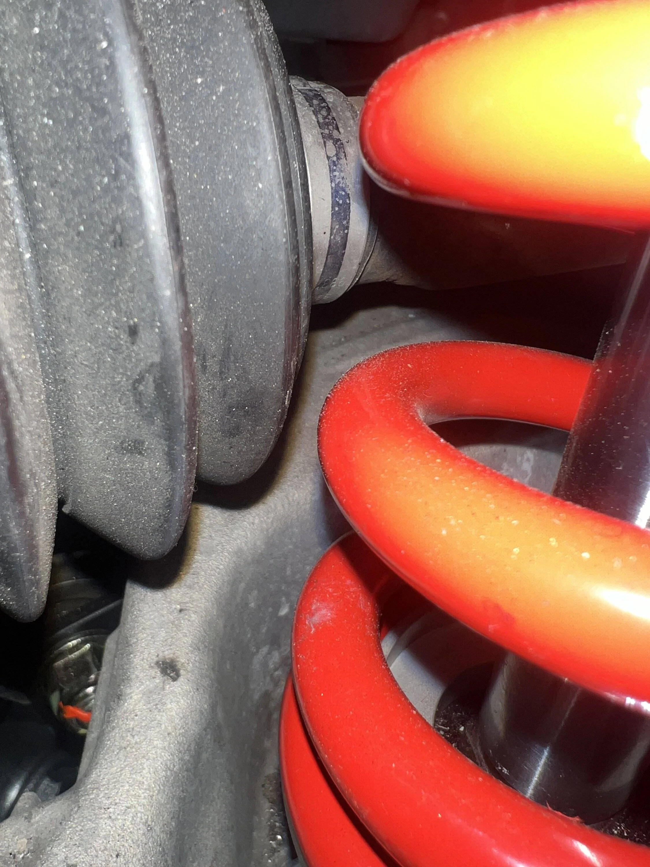

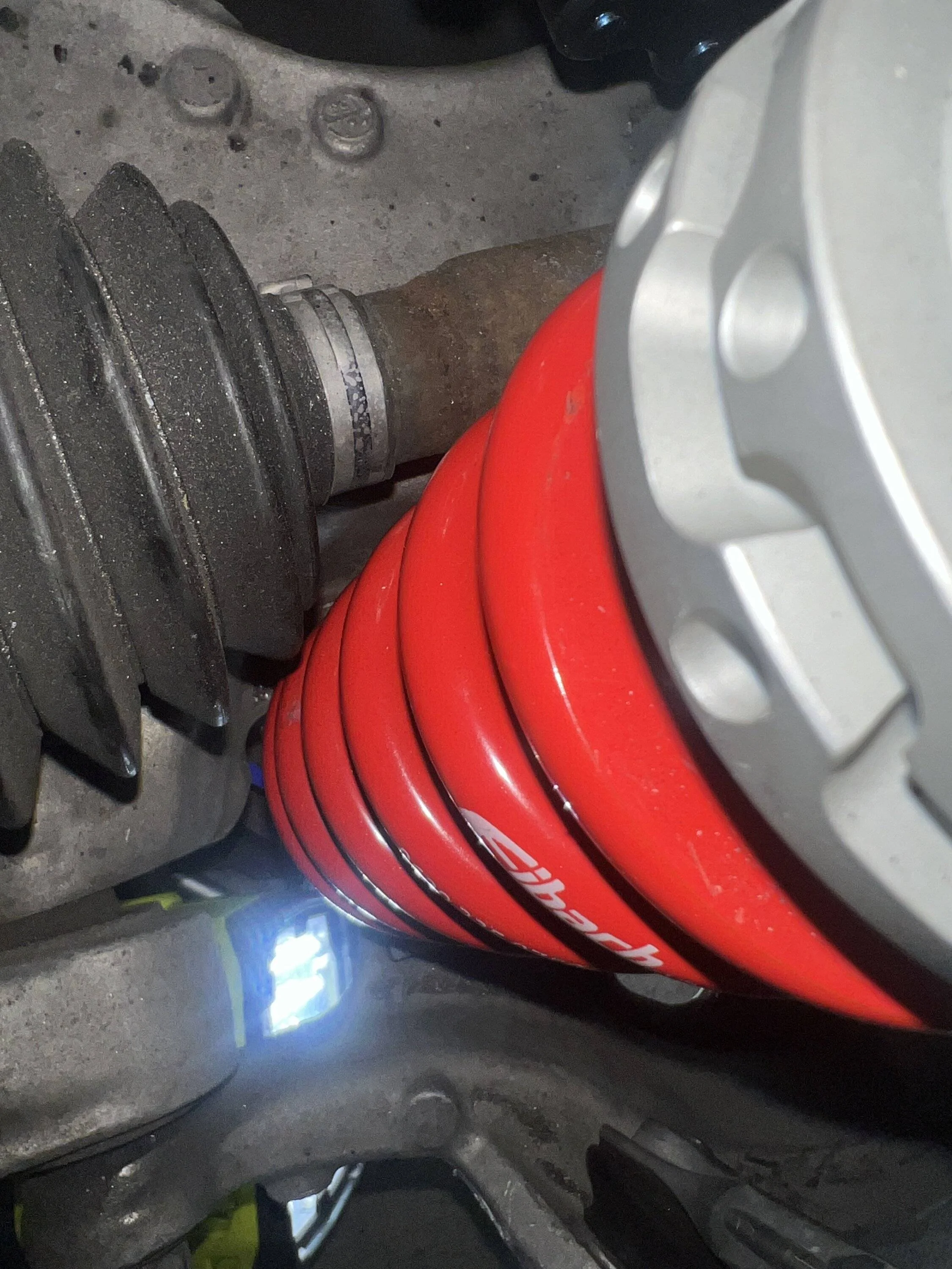

Just seeing this. Were you looking at the MMR kit or just MCS in general? The MMR kit seems to not be favorable for non 350 and PP2 cars. Im not to worried about the spring choice because they give you the option to select your own rates but I just think the need to be longer. The biggest issue right now is the clearance to the CV axle. Vorshlag sells their kits with a "super offset" which they produce in house for this very reason. They won't sell it to me. I have about a millimeter of clearance. I was advised to shift the subframe but I feel like I should t have to do that to get this kit to work. Or run low profile axle boots which come at a nice cost.

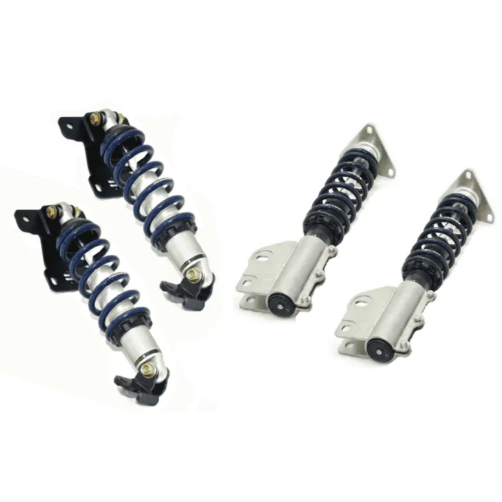

I’m looking at the Vorshlag kit. If funny they won’t sell you just the mounts. My ridetech coilovers I have now have a similar offset bracket in the rear. Maybe try them to see if they’ll sell just that piece?

You can see the offset mount for the Ridetech coilovers to the left.

They are 2.25 springs. But after talking with a few others and looking at their pictures, the clearance is tight but it’ll work. The kit has been out for this long so I’m sure it works but comes with precautions. If ride tech or cortex will sell me their lower mounts I’ll be willing to try it out.
