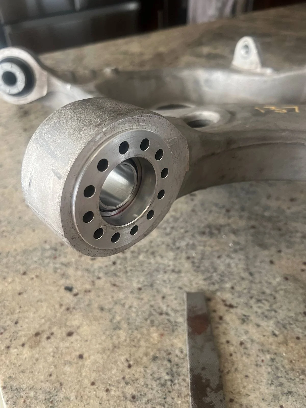

Im still not comfortable with the CV boot clearance even though some say its fine. I know myself and would be pissed if I end a track day early AND have to replace the entire axle. GT350 cars and PP2 cars do not have this issue and have more clearance from the CV boot. I am going to swap my LCA to GT350 LCA and run the mounting bracket for a 350. Part of me doesn't mind because I have been wanting to swap out my Steeda RLCA bearing for a Cortex one due to the design differences. I talked to both MMR and MCS and both were supportive of the idea. I know other options like from RIdetech were mentioned but the way the MCS is assembled I rather just go with new LCA.

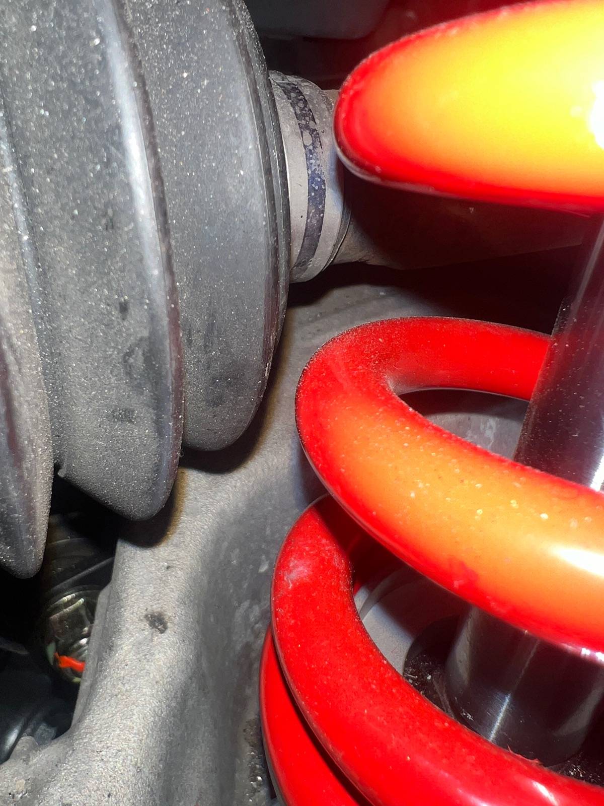

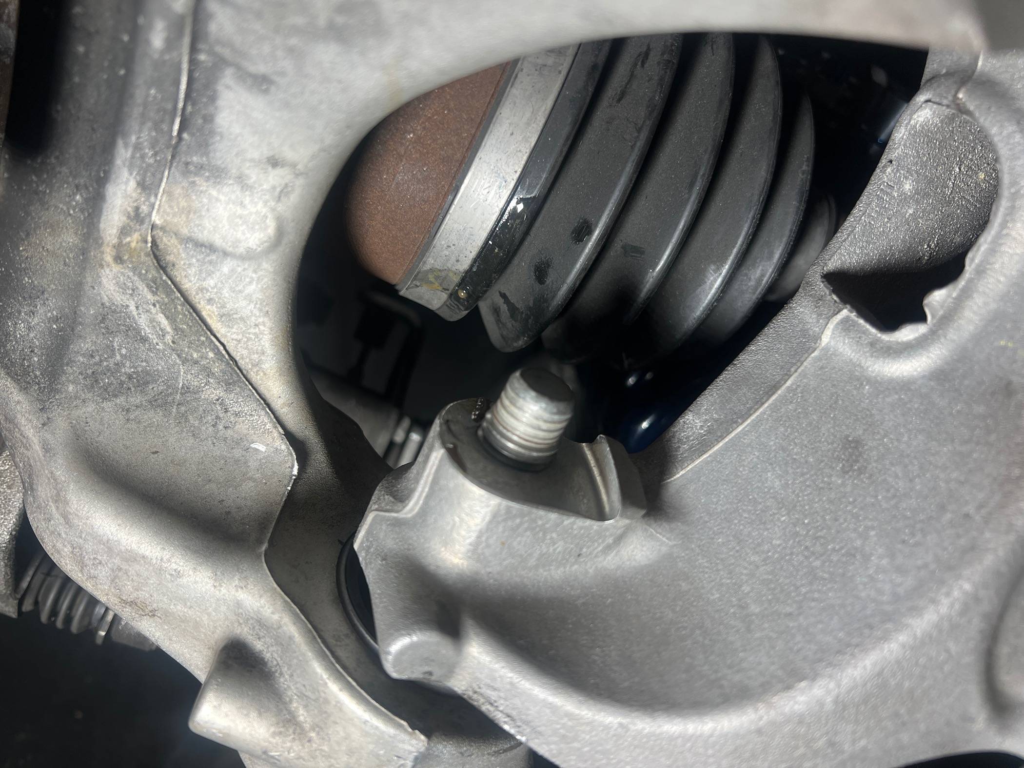

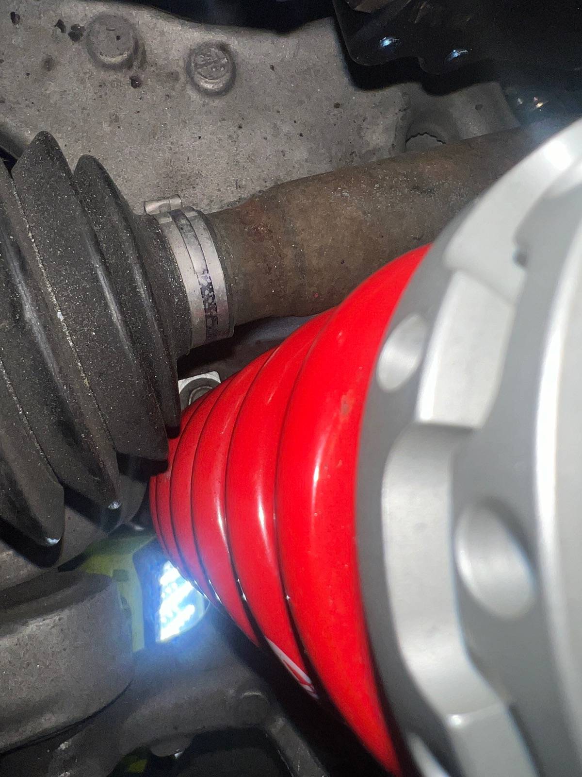

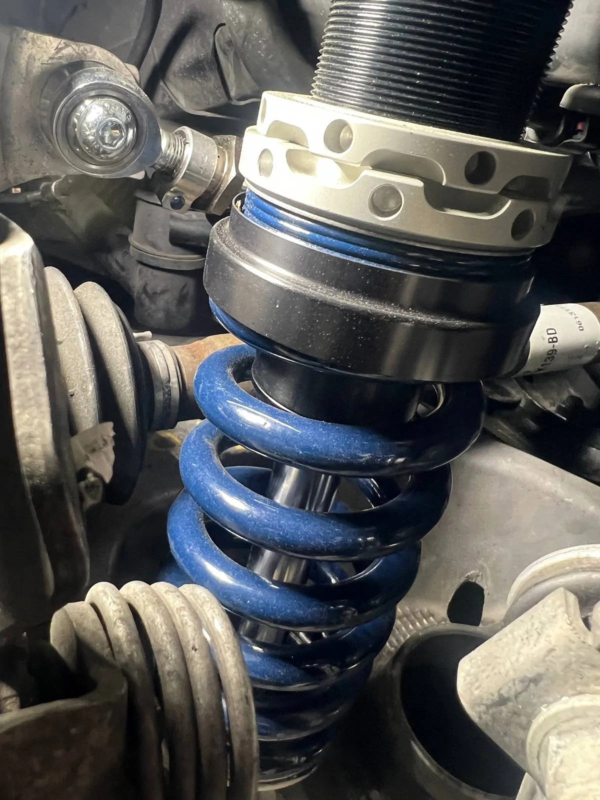

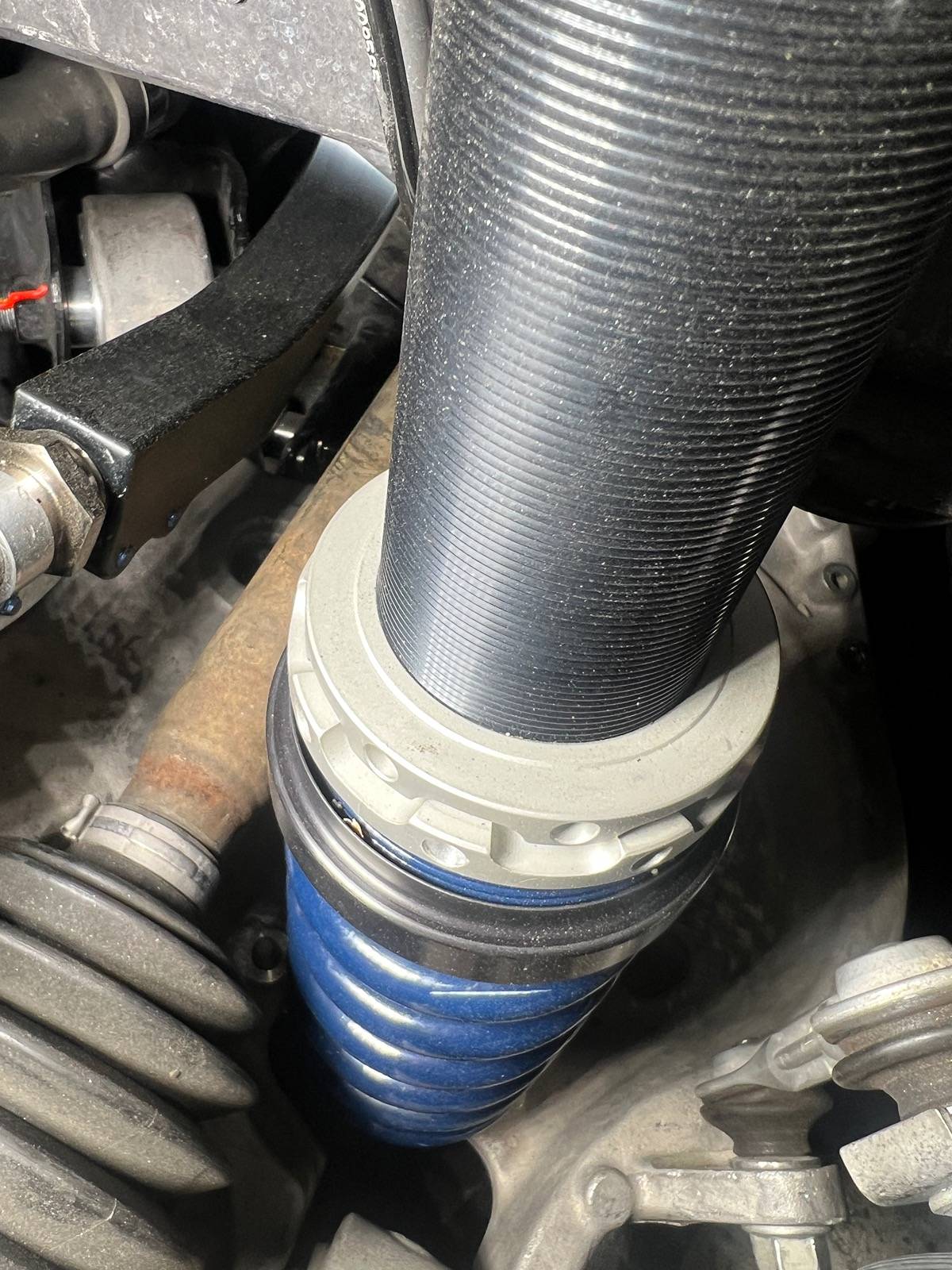

As I stated before, I was uncomfortable with the axle boot clearance. For the non MR cars Vorshlag makes a T bar that has a larger offset than the ones that come with the kit from MCS. I was lucky to find someone who bought a GT350 kit and swapped to a GT because man these little pieces are expensive. Also the springs from MMR were too short so I went with a 7” spring and a helper. Much better. You can see the difference in the clearance of the two set ups.
I bought GT500 LCA from Midway Mustang and put in SPL bearings.
funny thing is I did all this work to prevent having to deal with an axle boot tear but when I finished everything I saw some grease coming out of the passenger side axle boot lol. So I replaced that.

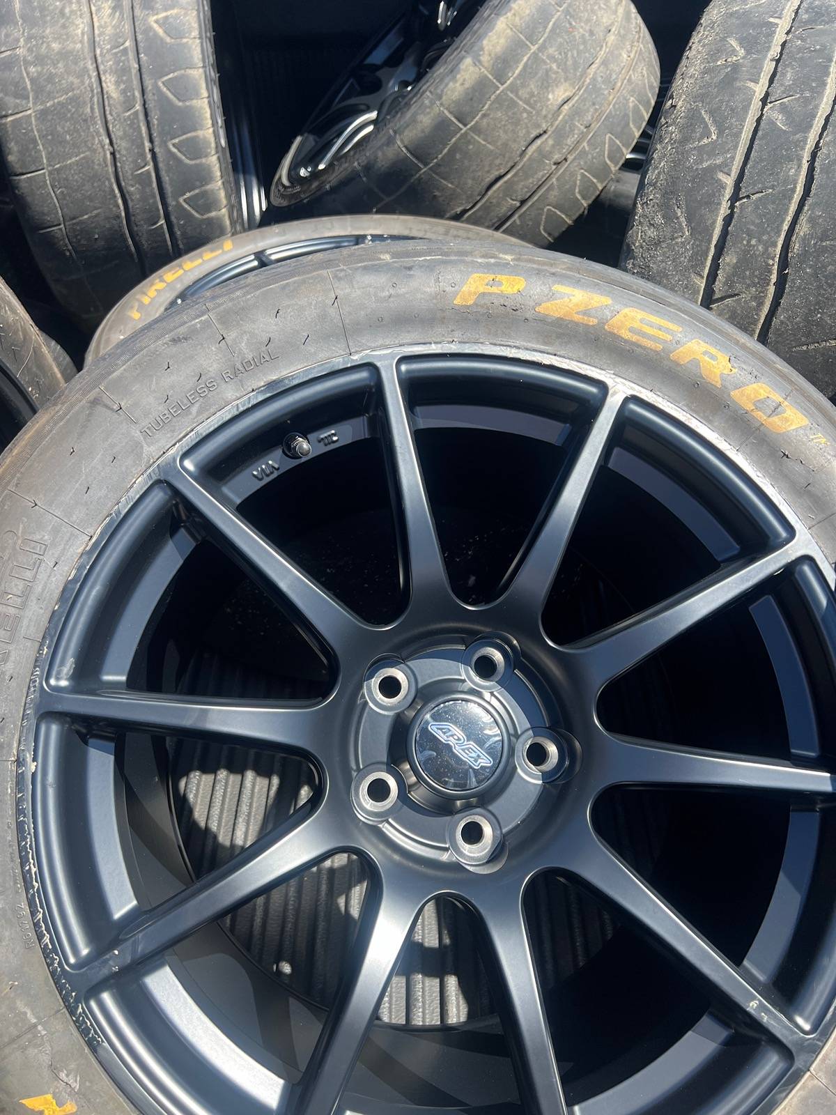

took advantage of the Apex sale and went to 18s and Pirelli DH scrubs. Guess they will go in storage for the time being. Don’t worry @shogun32 I still plan on shopping at your store. This guy just basically gave them for free.

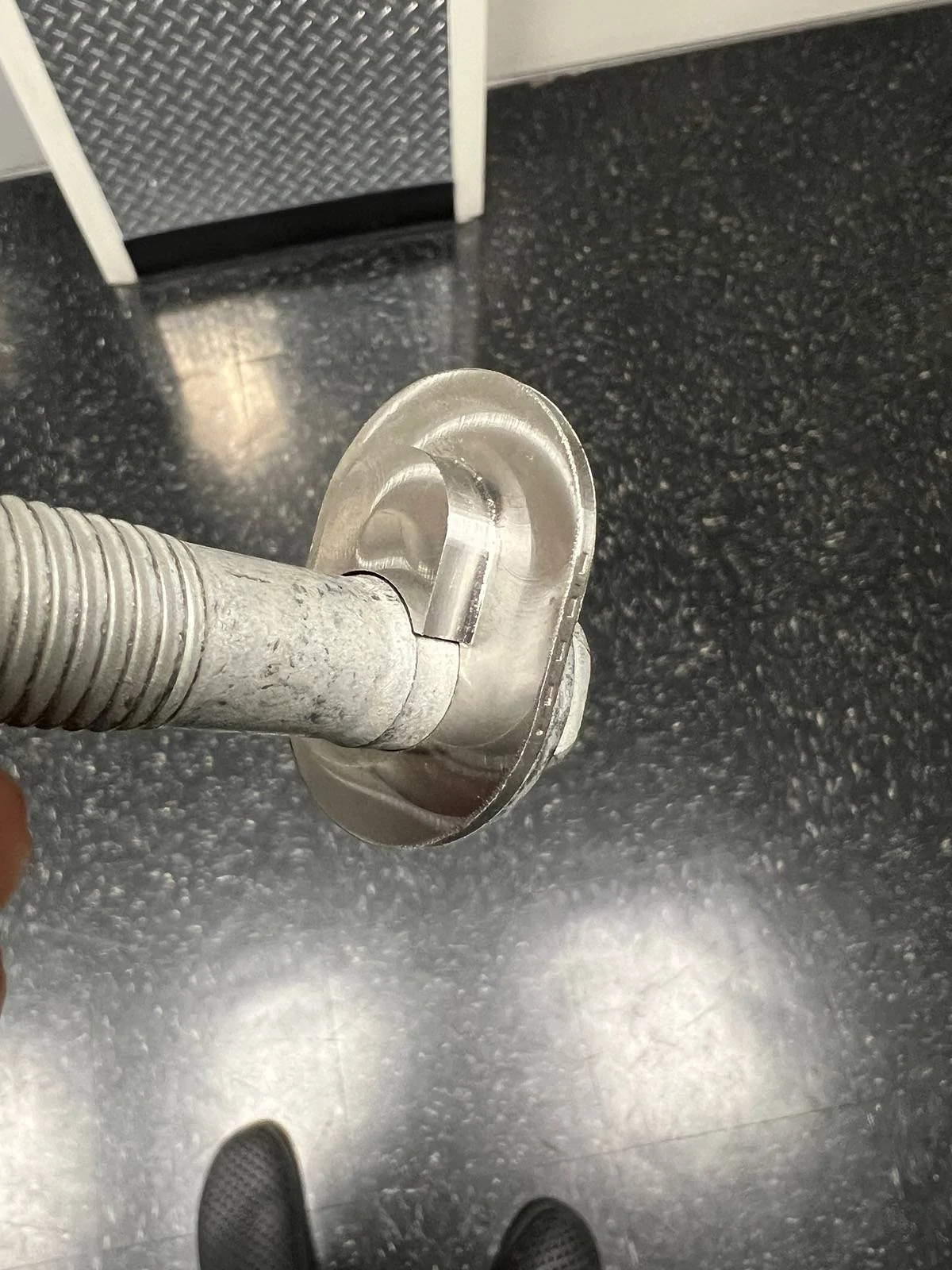

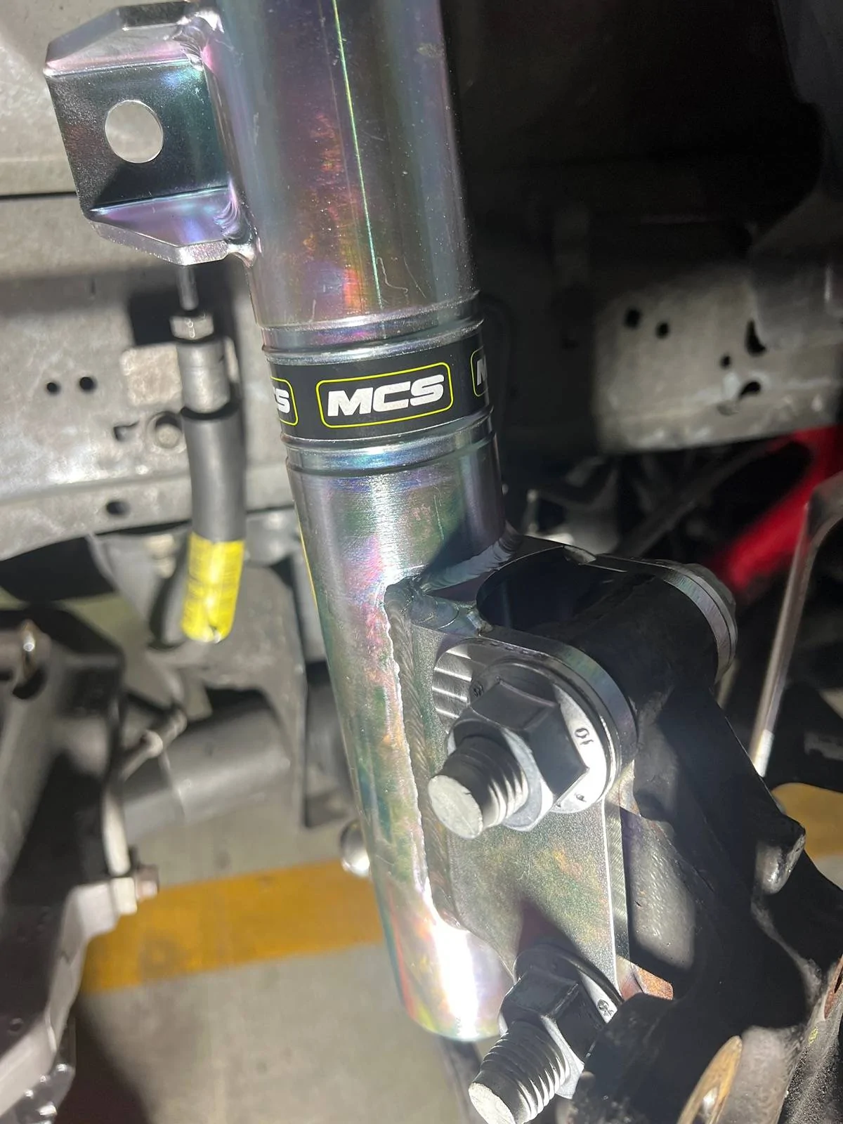

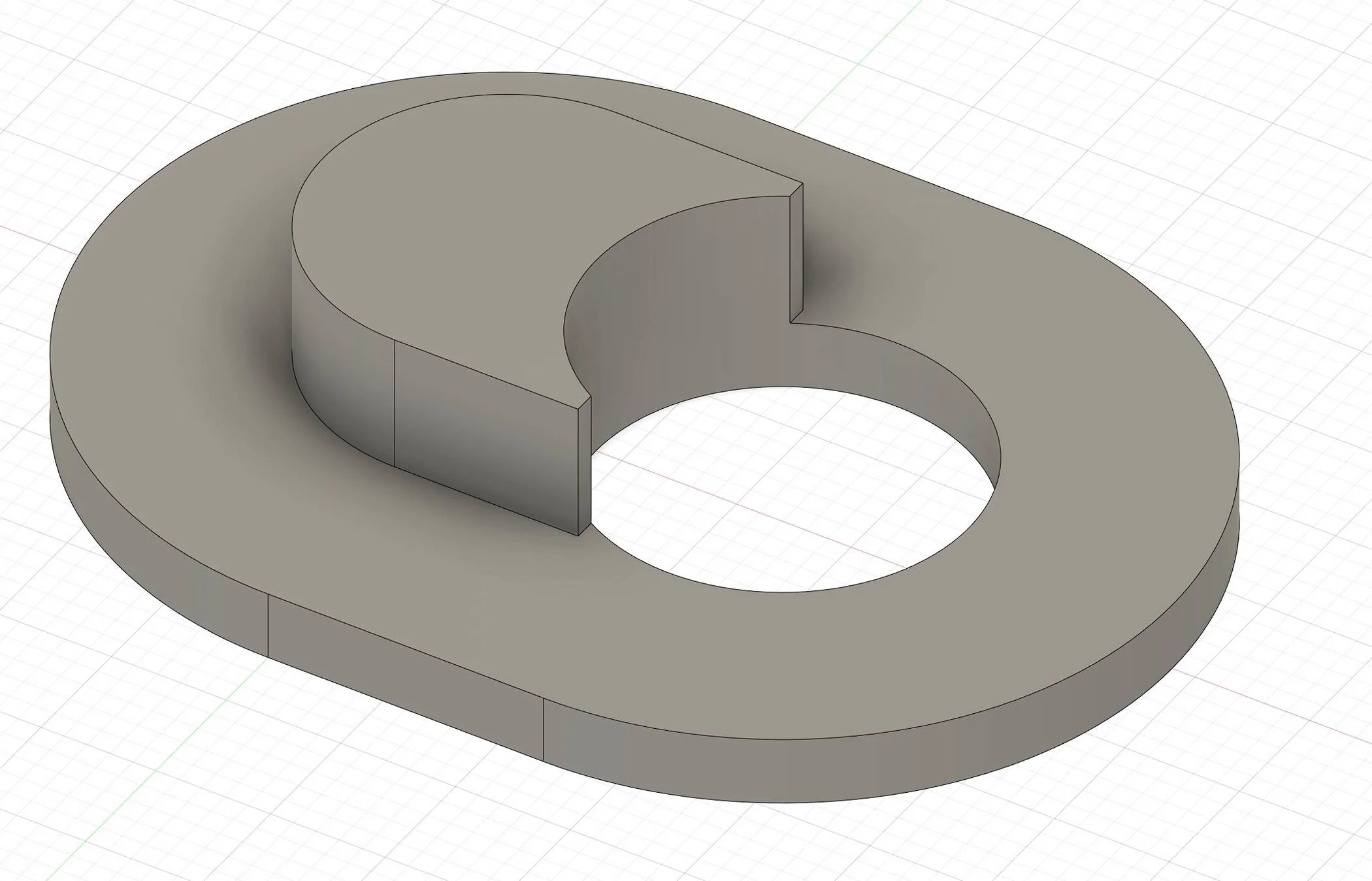

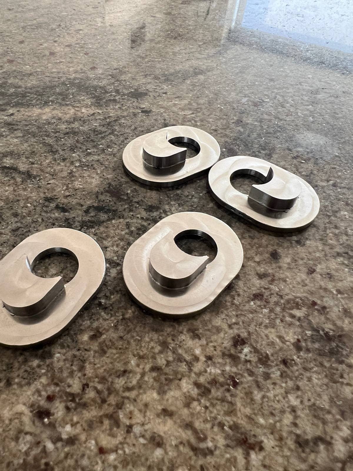

The MCS front struts have a slotted top hole for camber to be adjusted at the spindle. This minimizes wheel and tire clearance depending on how pushed in the strut is. Since I already have camber plates and want to run wide tires, I decided to lock out the camber to prevent the bolt from slipping. After have a camber bolt slipping on me and ruining one of my wheels I have been traumatized. So I made film first CAS model a few months ago and found someone in one of the track enthusiasts FB groups who was able to cut them for me. Came out perfect and a very tight fit.
