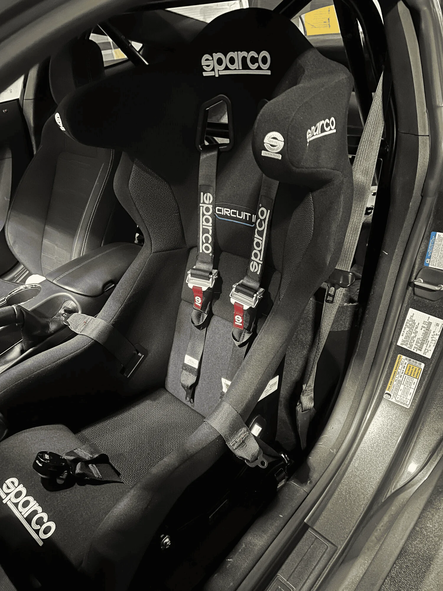

I didn't plan on going with a roll bar+seat+harness system just yet because I wanted to use those funds for track time. I ended up getting a local deal for a Chromoly Watson roll bar that I couldn't pass up. I plan to run TT with NASA either this year or next so I have been careful about adding weight to the car which is why I went with the Chromoly bar. Ended up getting PCI fixed mount, Sparco seat and harness. Man does the PCI mount really sit you low. The good news about the roll bar install was that I didn't knick any brake lines but the bad news is the drill bit walked on me so ended up having Revolution Automotive in Baltimore finish it.

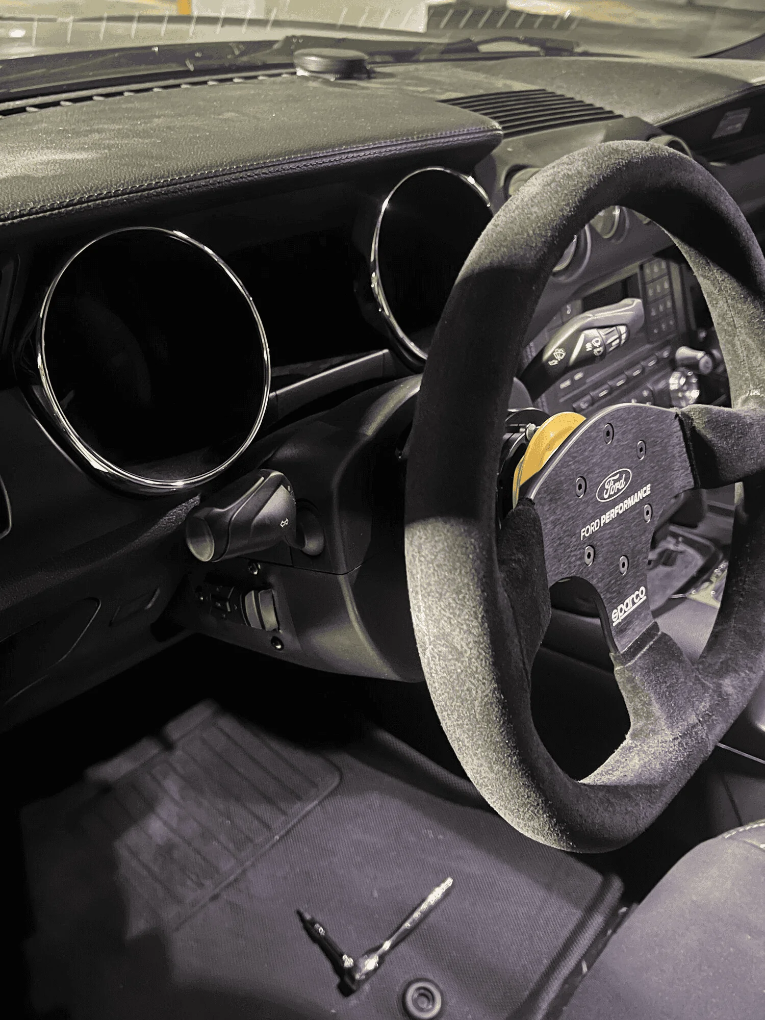

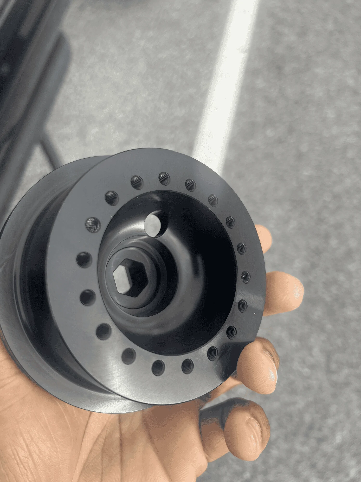

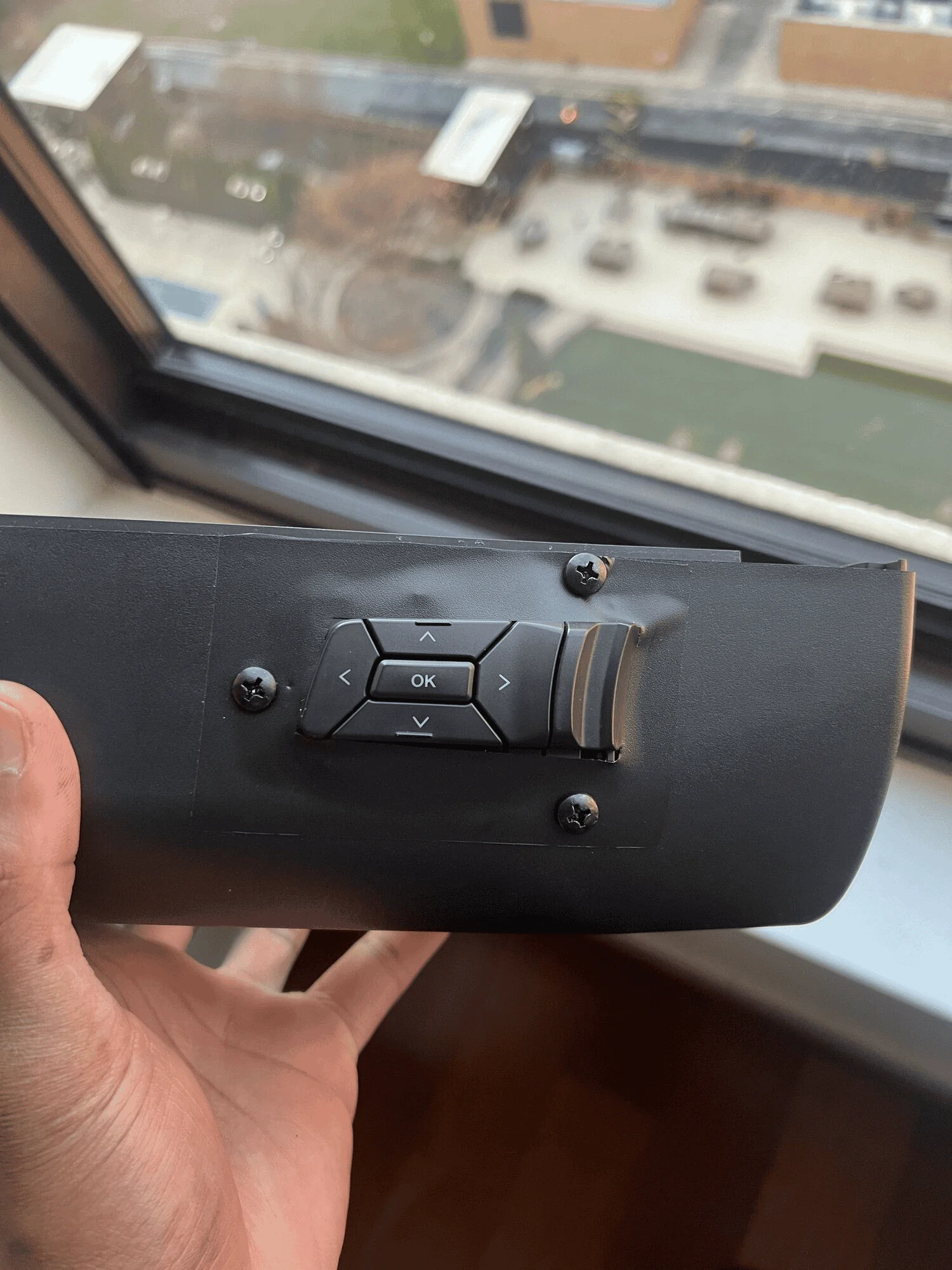

With the new seat, I noticed that my elbow kept hitting the center console and would put my right shoulder in an awkward position. To fight the ergonomic challenges, I swapped out the standard handle MGW for a low profile one to reduce the throw. That way when I go into 4th, my elbow doesn't go far back behind my shoulder. The next thing I did to reduce elbow interference was to replace my CF steering wheel with the FP Sparco wheel. This should reduce the steering input needed for turning. I went with the MMR aluminum hub which is a solid piece of work and Krontec Quick Release. As we all know the challenge with this is relocating the steering wheel buttons and all the effort associated with that. I wanted to be able to access the buttons while being strapped in. Its documented in another thread that its 5 buttons but 4 wires (voltage divider network) so its not as simple as replacing it with a digital joystick. I ended up taking the switch apart and it is a PCB so if I were to have access to the schematic, I could replicate the switch but use a joy stick to be mounted on the center console. But again, that was a distant thought. I liked the idea of mounting to the side of the steering column. I cut the hole, then found black craft paper with adhesive backing from Michael's to match the steering column. Came out very clean. Wanted to retain the horn so I added a momentary switch for that. Now I can get in and out easier with the seat in.

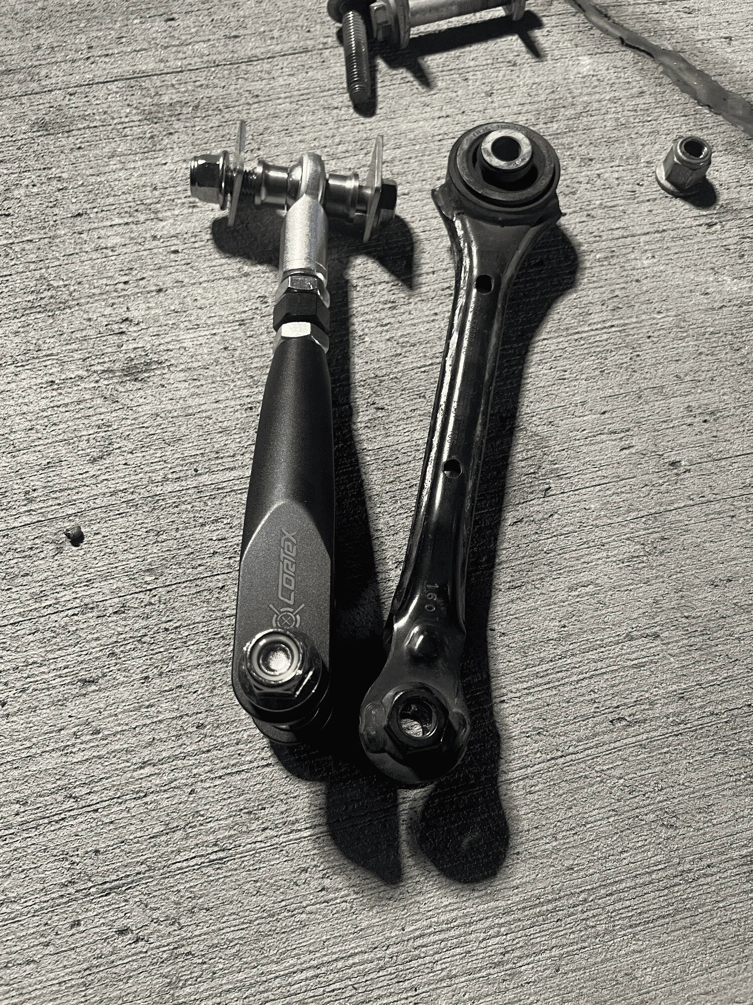

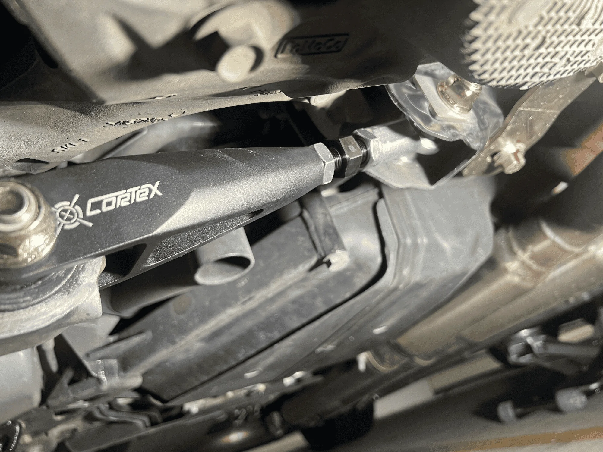

Swapped out OEM PP rear toe links for Cortex offering.

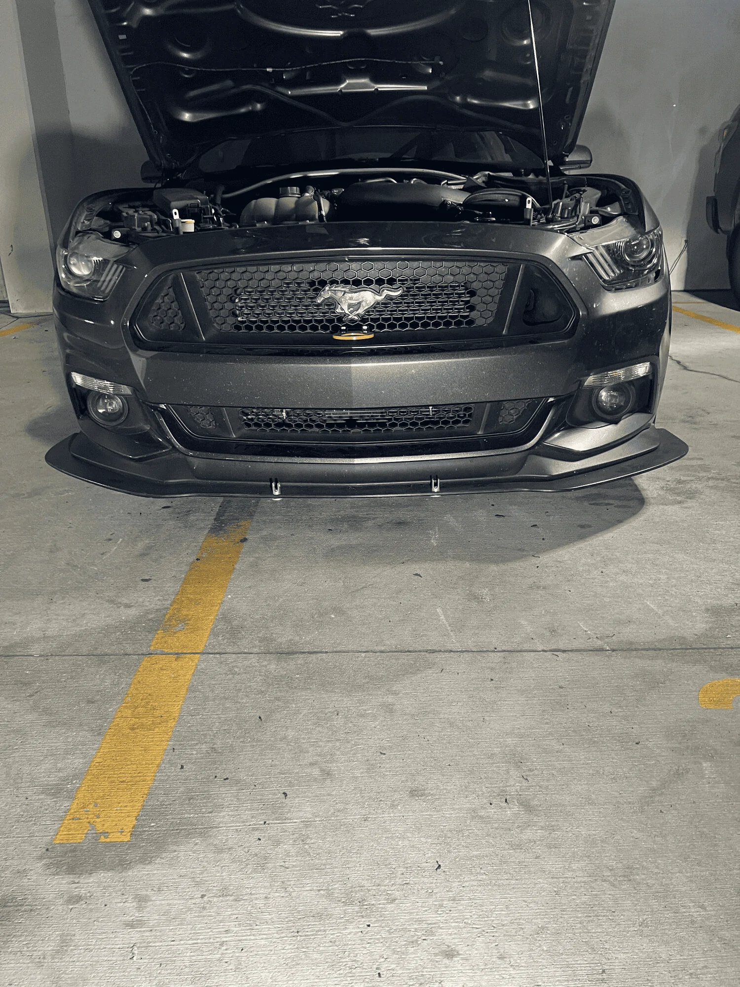

I changed the front tow hook to the GT350 tow hook. The previous one looked like my car was sticking its tongue out so this looks much better to me.

So I had my heart set on Sabelt seats(Taurus Max) and Sabelt enduro harness. I knew I wanted an enduro harness because of aluminum vs steel and because the pull straps have loops which make it easier to pull with gloves. I also knew that I wanted pull up style lap belts. Schroth enduro harness I believe is only pull down plus its $200 more than Sabelt enduro. I like that Sabelt gives you the option to run pull up and/or pull down without buying additional items. When I went to try out seats, the sparco circuit II fit me better than the Sabelt Taurus. So to cure my OCD, I decided on Spacro harness but my second choice was the Sabelt Enduro which is the best bang for buck harness. If Lifeline Copse came in pull up I wouldve considered that. Kohr and Tuner Motorsports both use Lifeline Copse in their GT4 cars
This is the Harness i have
Sparco FIA Prime H-8 Endurance 6-Point Racing Harness – OG Racing
I have the Stand 21 HANS device. It is lighter than the Hans III and the ergonomics are a bit better in my opinion
Stand 21 Club 3 Head and Neck Restraint – OG Racing
Hope that helps
