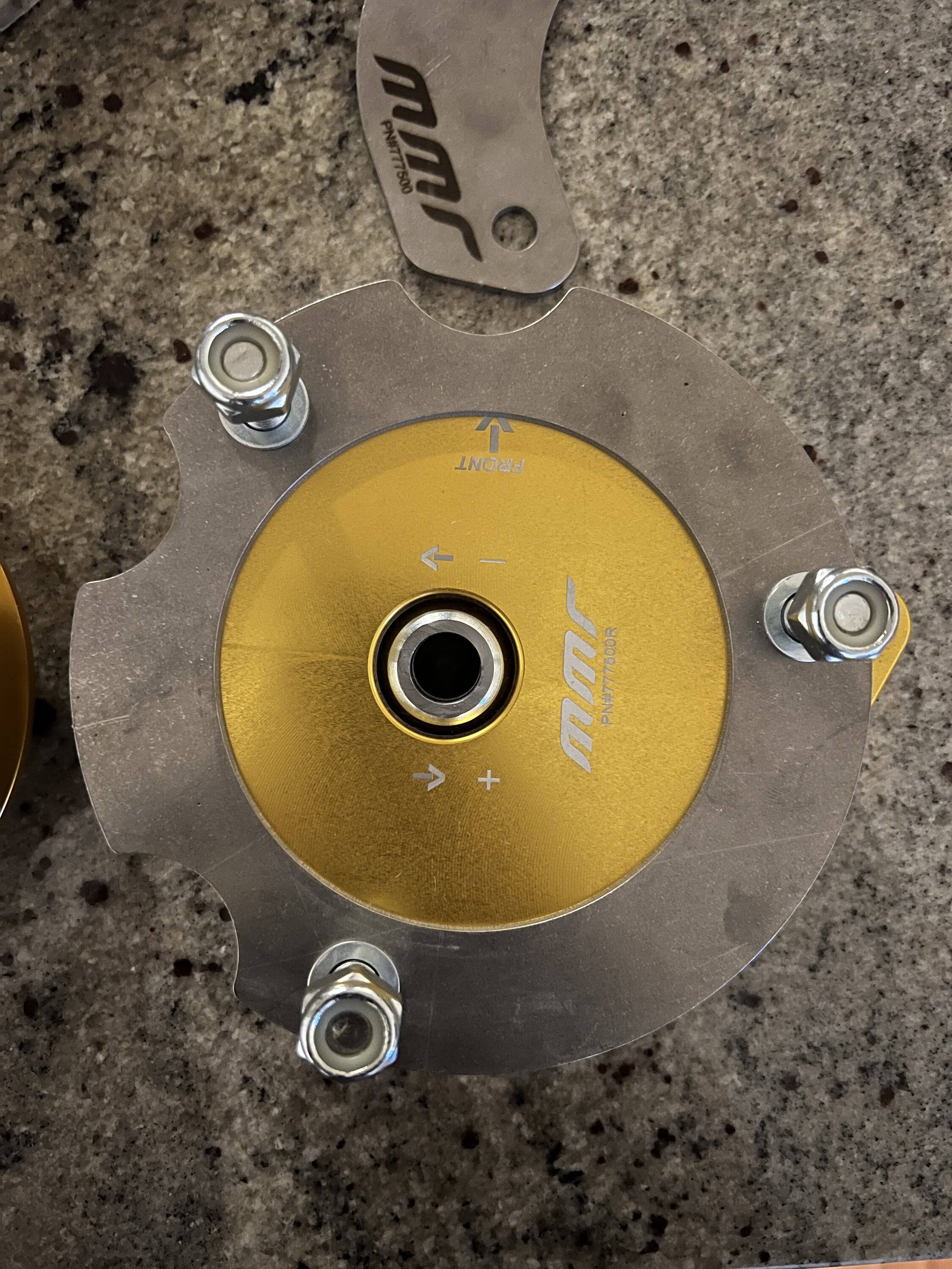

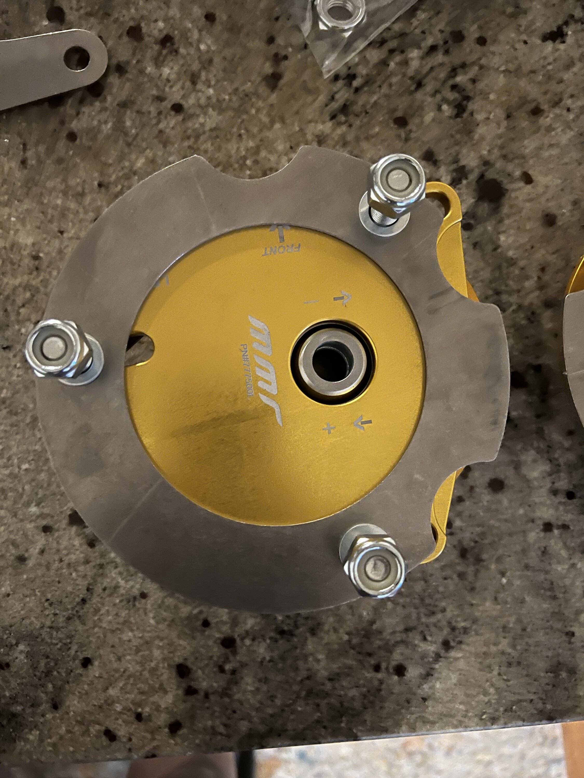

Oh awesome! Thanks for the quick reply, was gonna PM you the details instead. Makes me feel a bit better knowing yours looks the same as mine now. Now to get them in and test them out.
Yea you will get some good adjustment out of them.
Make sure you orientate the ring properly.

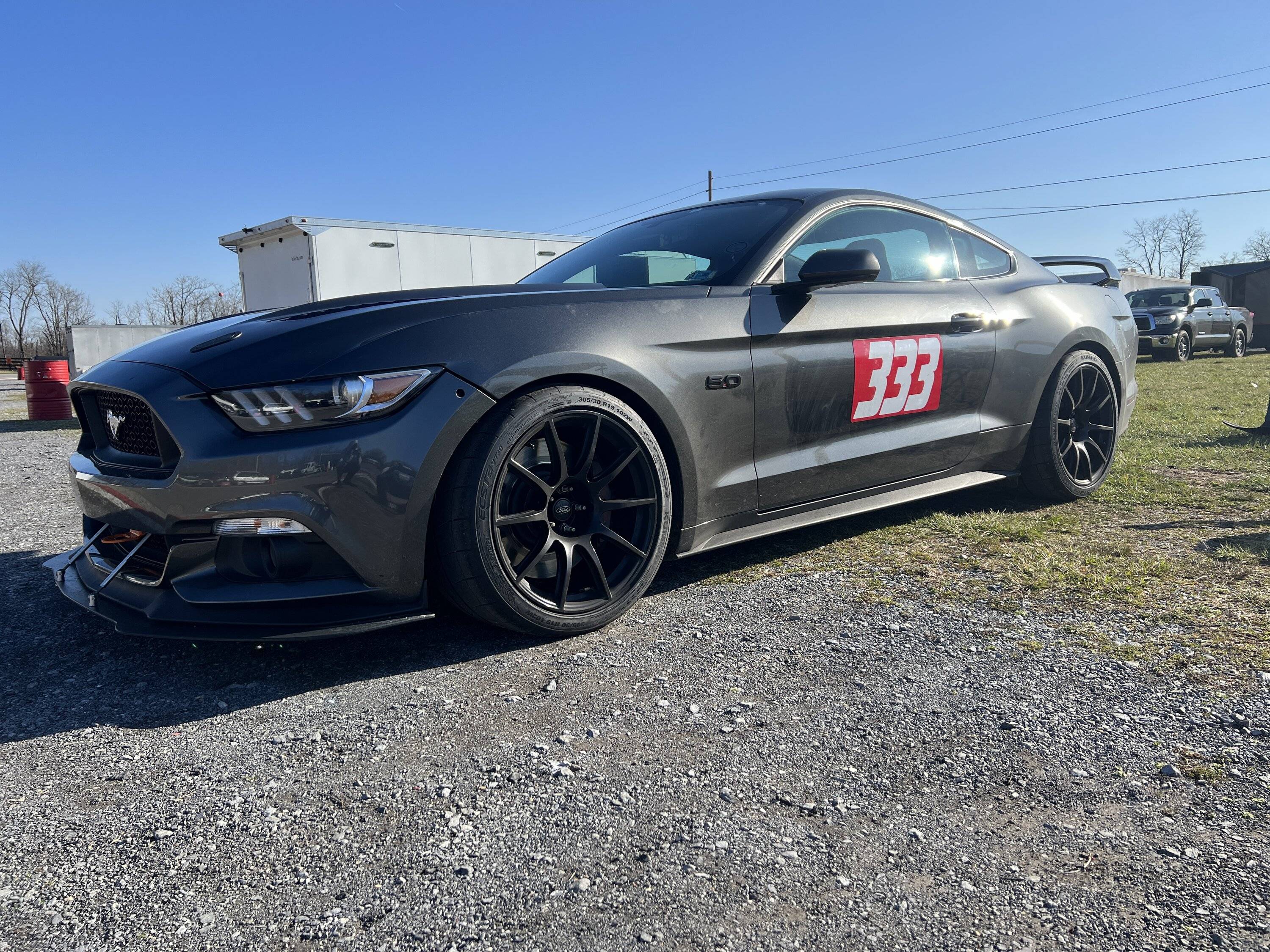

Okay so I started my track season last weekend at Summit Point with SCCA. Had a great time and met nice people. The best car out there was a Trans Am car that was doing some testing. I've never heard a car sound that amazing when upshifting. On the from straight it was doing about 175 that day and 1:12s with traffic in the advance group. This year I will be using a dual duty street and track tire, Kumho v730 because of the price and performance. They were amazing in my opinion and if simple tire continues to sell them for the price, I will continue to buy them.
A couple notes about the weekend:
-Set a PB of 1:27:20. After watching video several times, I know I can get sub 1:25 at least. I became more confident in the tires and brakes
-The tires love low pressures. I went out on 23 cold to get around 31 hot
-first time on a set of Pagid RST3/ RSL29 and wow. I was surprised how much stopping power the pads have. I usually brake at the 4 board but I was confident enough to brake just before or at the 3 board. I went from 138 to 65 very quickly.
-Those Veloster N cars can move lol
- Was also shifting at 7k to keep temps and engine in check
Solid day all around. Next event will be with NASA at Summit or SCCA at Summit in April. Overall very pleased with Tires and Brakes. The trust is there in the car so I know I can push a bit more. With a race seat and harness to keep my 255lb body in check, times will also come down.
