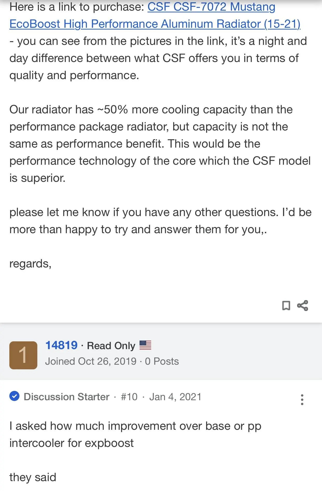

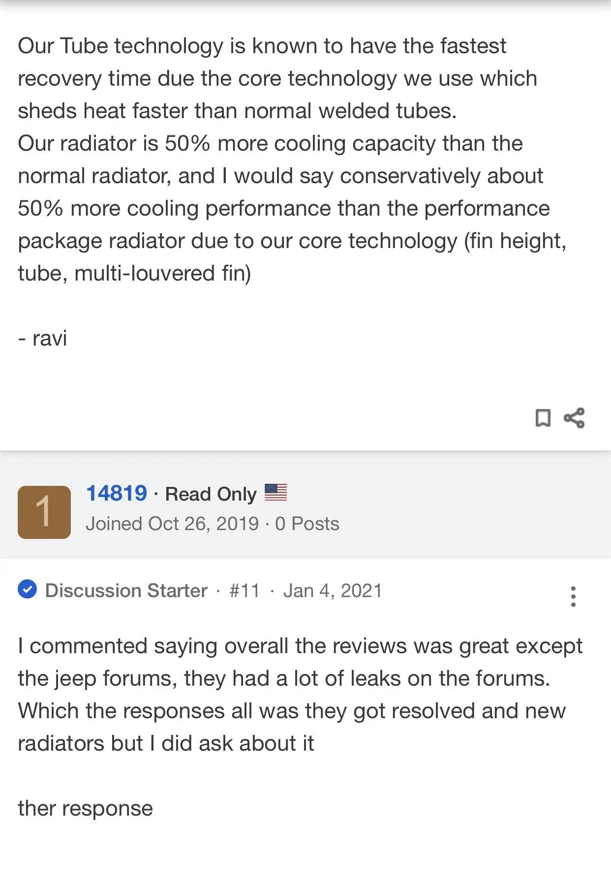

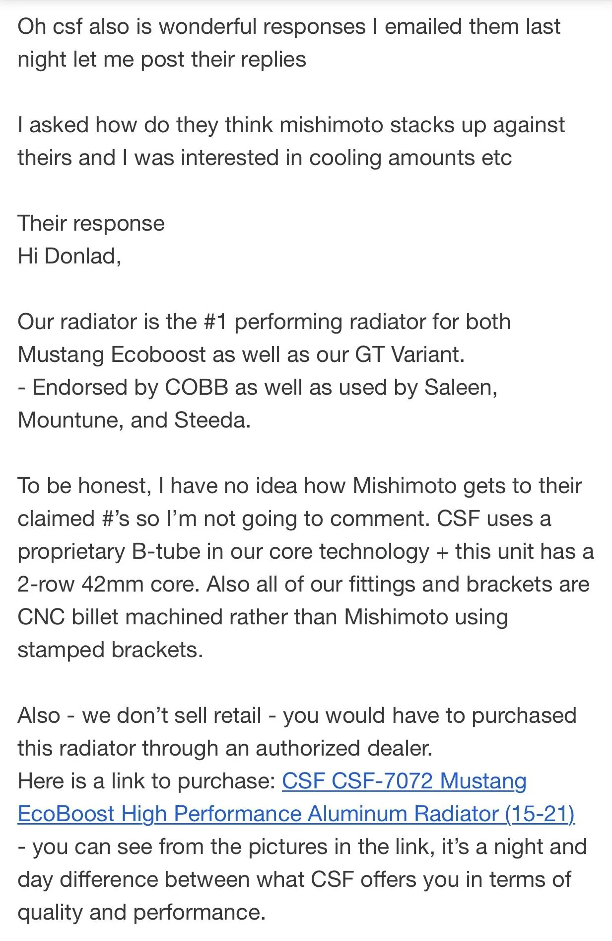

The csf High performance radiator was custom made just for the newer mustang platform. And the specs sound great!! About exactly the same dimensions as the Mishi as well. It’s two row vs three. They (csf) claim it’s the #1 performing radiator available. And it’s 200$ Cheaper 🤔😀👍 I believe I’m sold. Has anyone upgraded from pp1 rad to csf? I’ll add a forum post of csf salesmen stating more information. But I’m pretty sure I made the right decision.

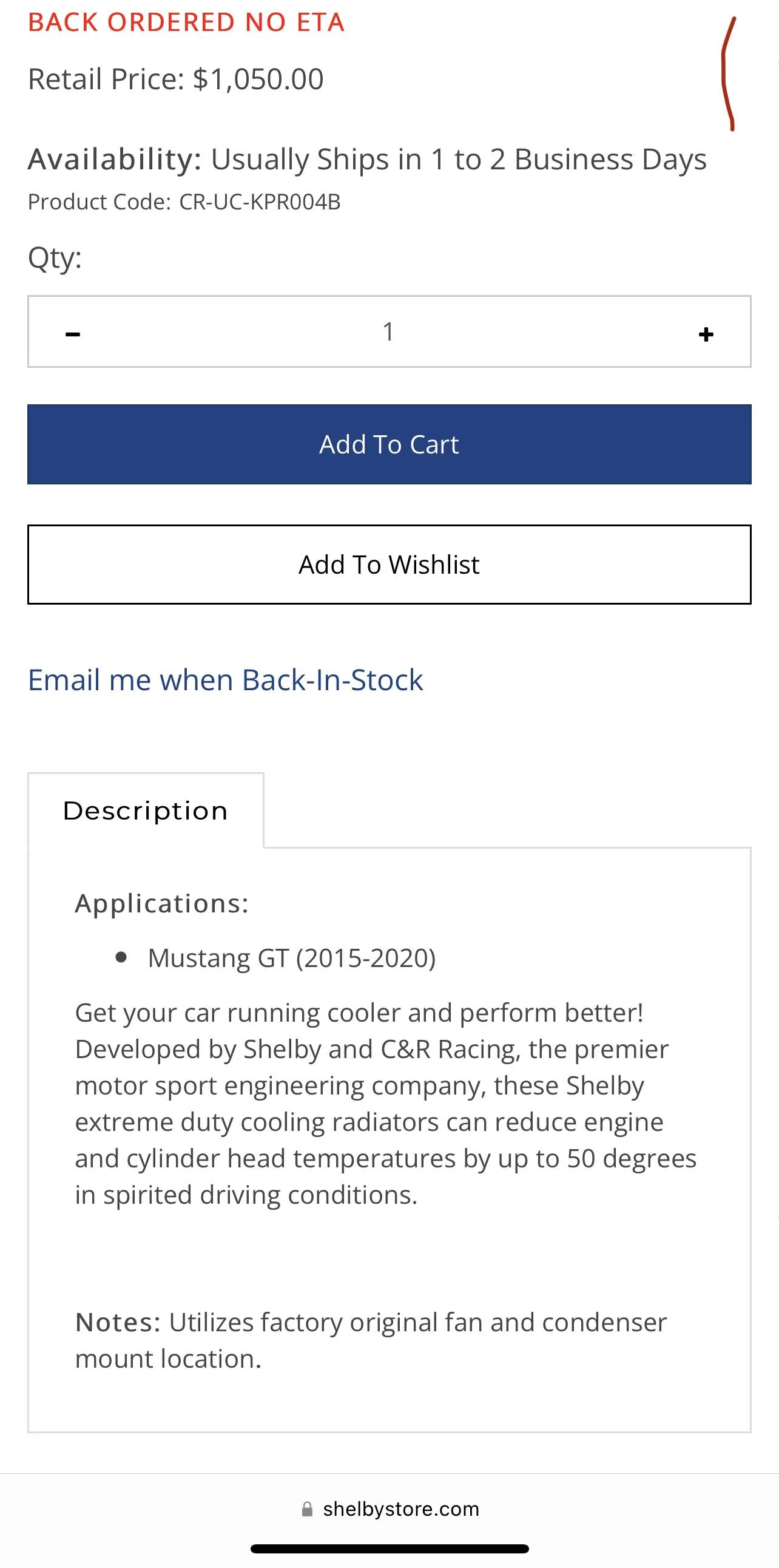

I believe CSF also manufactures all of the radiators for Shelby American and all of their performance packages as well.
Decible
Dec 27, 2020
52
932
500
Georgia
Sam
2023 Mach 1 HP
I was wrong C&R does
