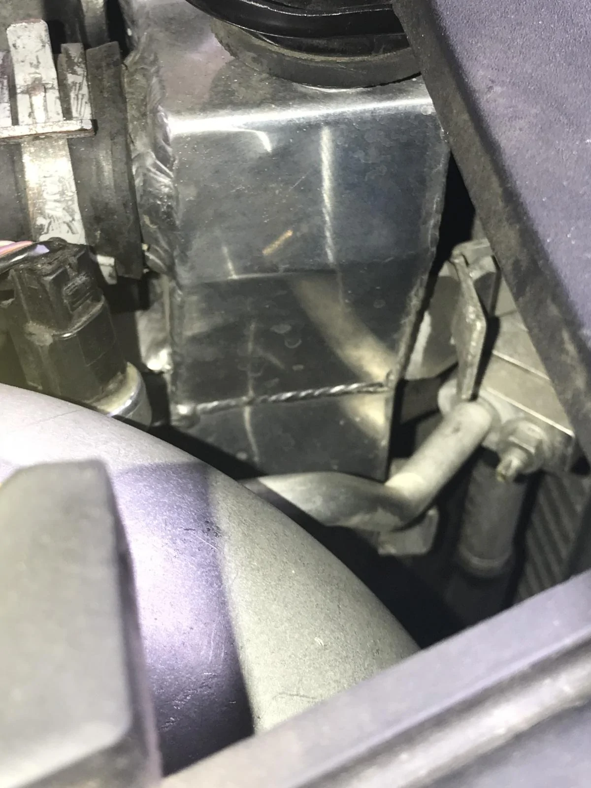

My oil cooler is between radiator and ac heat exchanger, fits if you bend the tabs a little. I also boxed in the radiator to make sure no airflow leaks around it.

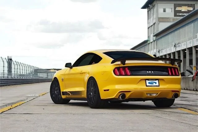

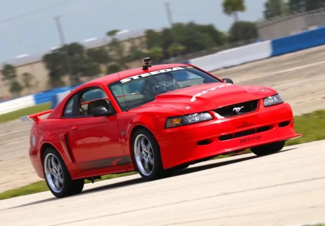

Hey DS, we have had great success road racing our cars over the years with Vortech blowers on them. Our s197 BIW car has done quite a few enduros with its centri making over 570whp, and we Used to run the same setup on our #20 s550 before moving the car back to SCCA T1 class rules. Let me know how I can help you out
And not to forget our old Vortech supercharged New edge
