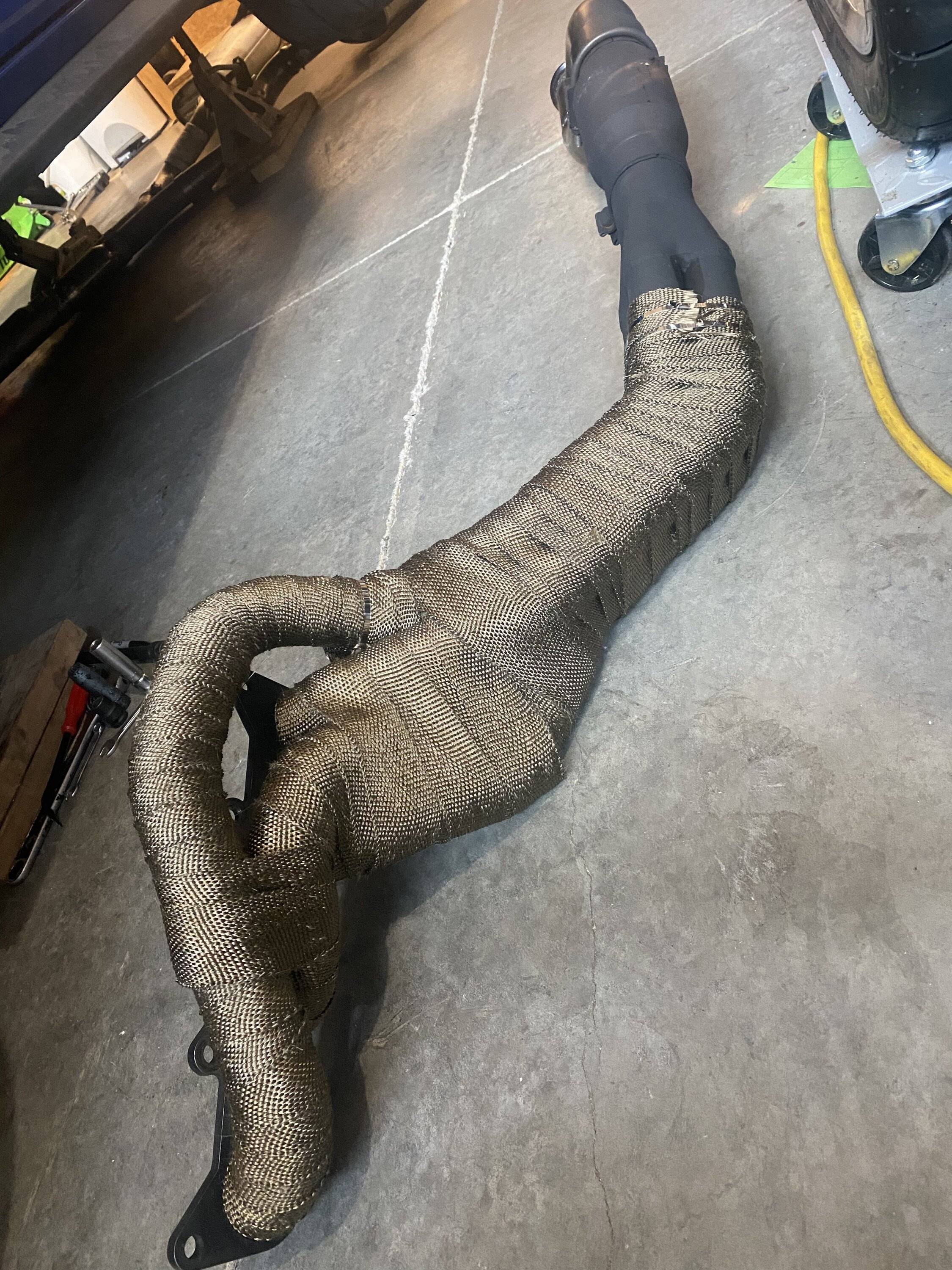

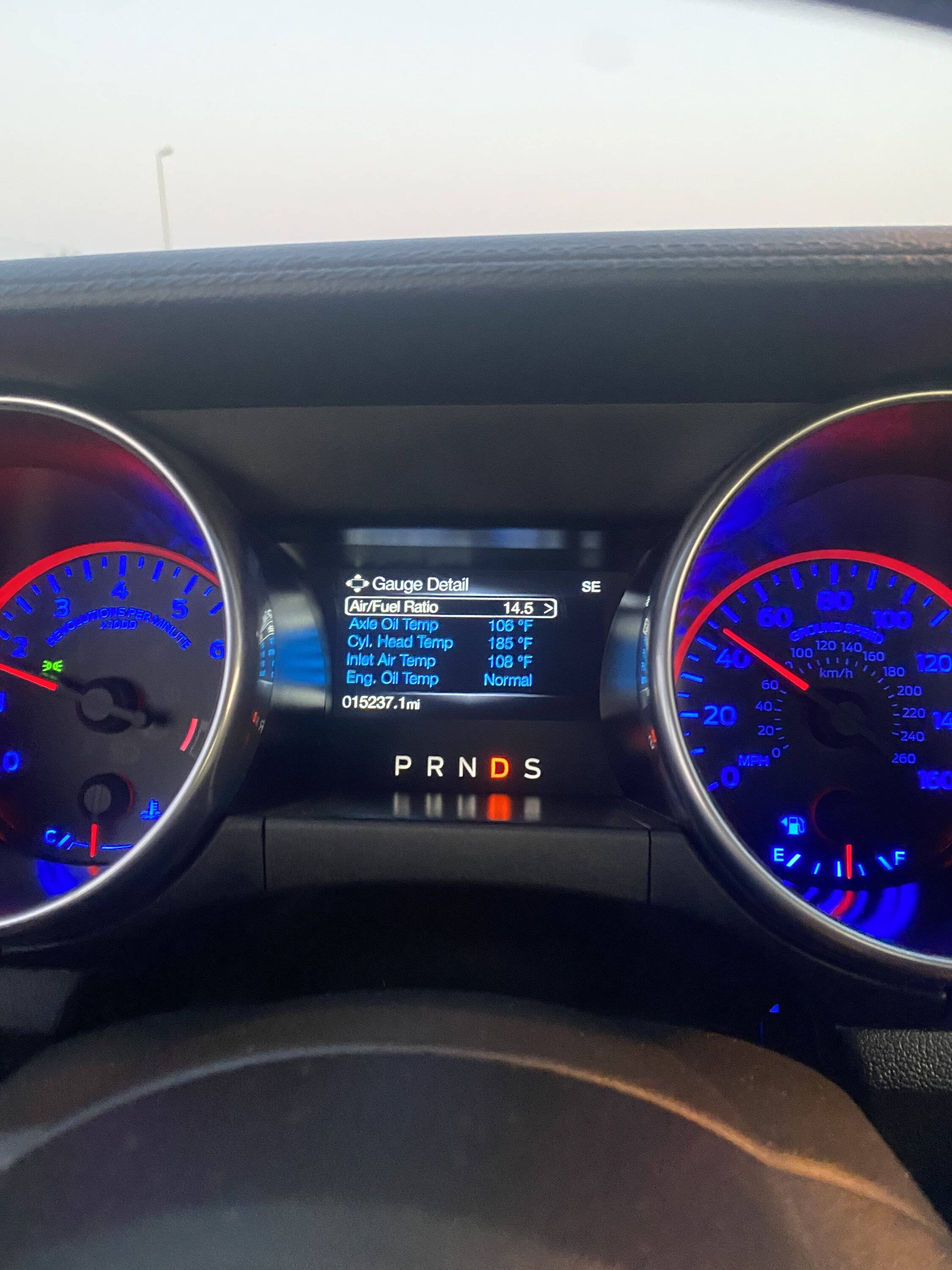

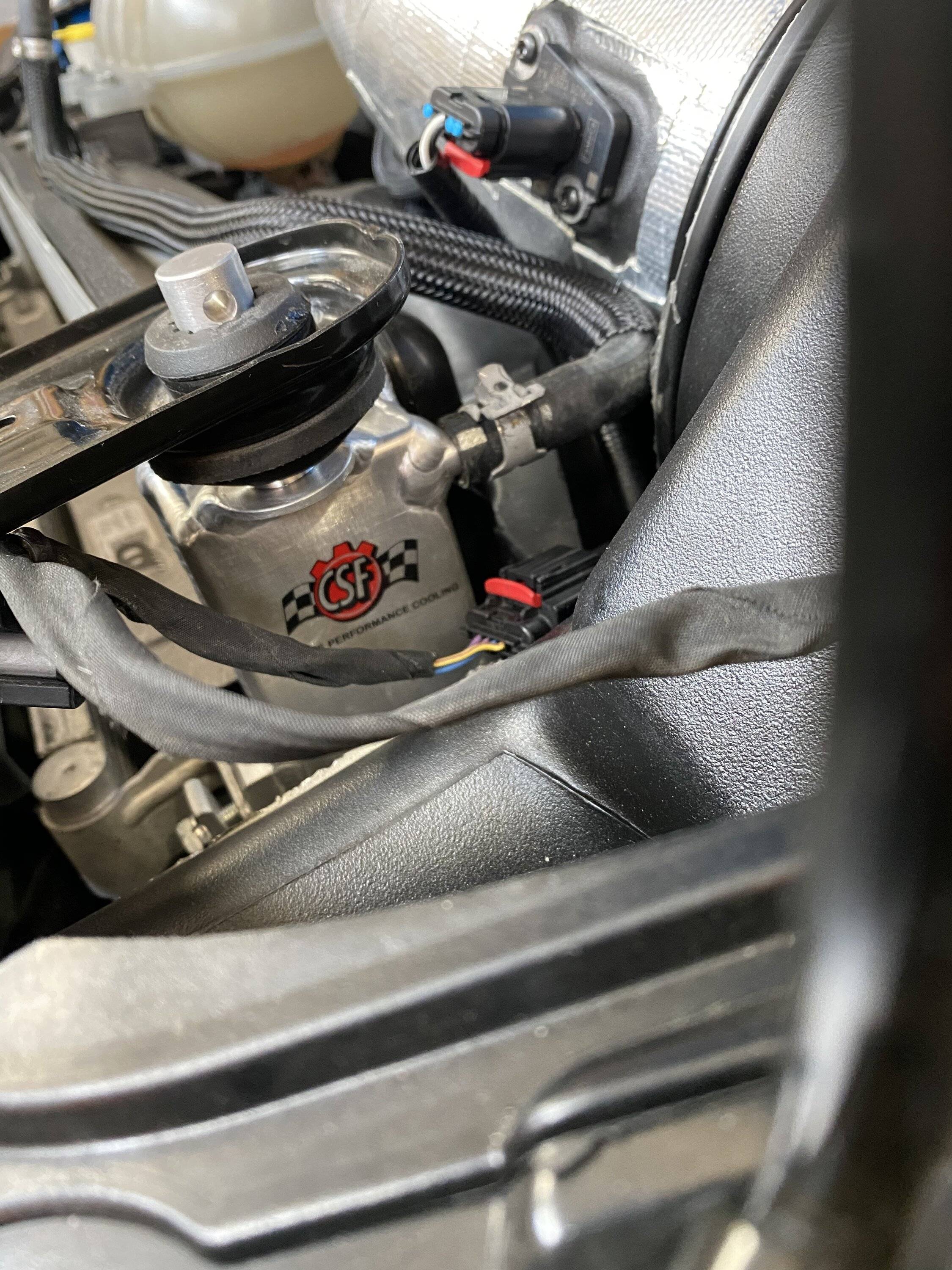

Wrapped headers along with heat products header blankets. And new csf radiator along with upgraded intercooler pump. My cylinder head temp was avg @185-187 didn’t get above 190 not once. (Already had 170 t-stat) Went for drive. Even let it heat soak while I ran into Walmart. Recovered way faster than before! Car is running great!! Everything combined really cooled everything down!!🤓👍 Seems like the radiator helped with trans temps even. Especially my iat’s average around 107 degrees with outside temp of 85-87.. Thsnks for everyone’s input. Heat kills!! Cooler temps =Mo Powa!! Especially with 90+ Temps

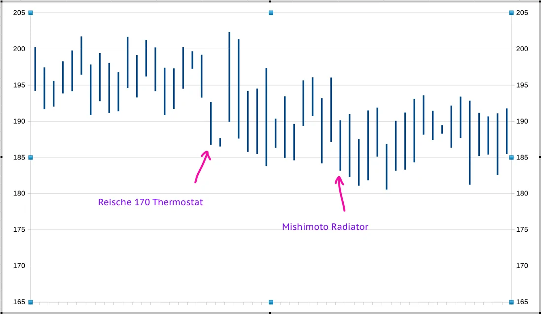

High and low coolant temps of datalogs, stock rad/therm, then after changing to a 170 thermostat, and then after adding the Mishimoto radiator
