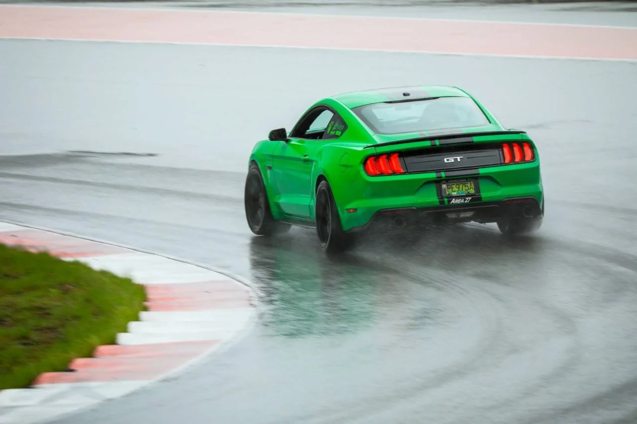

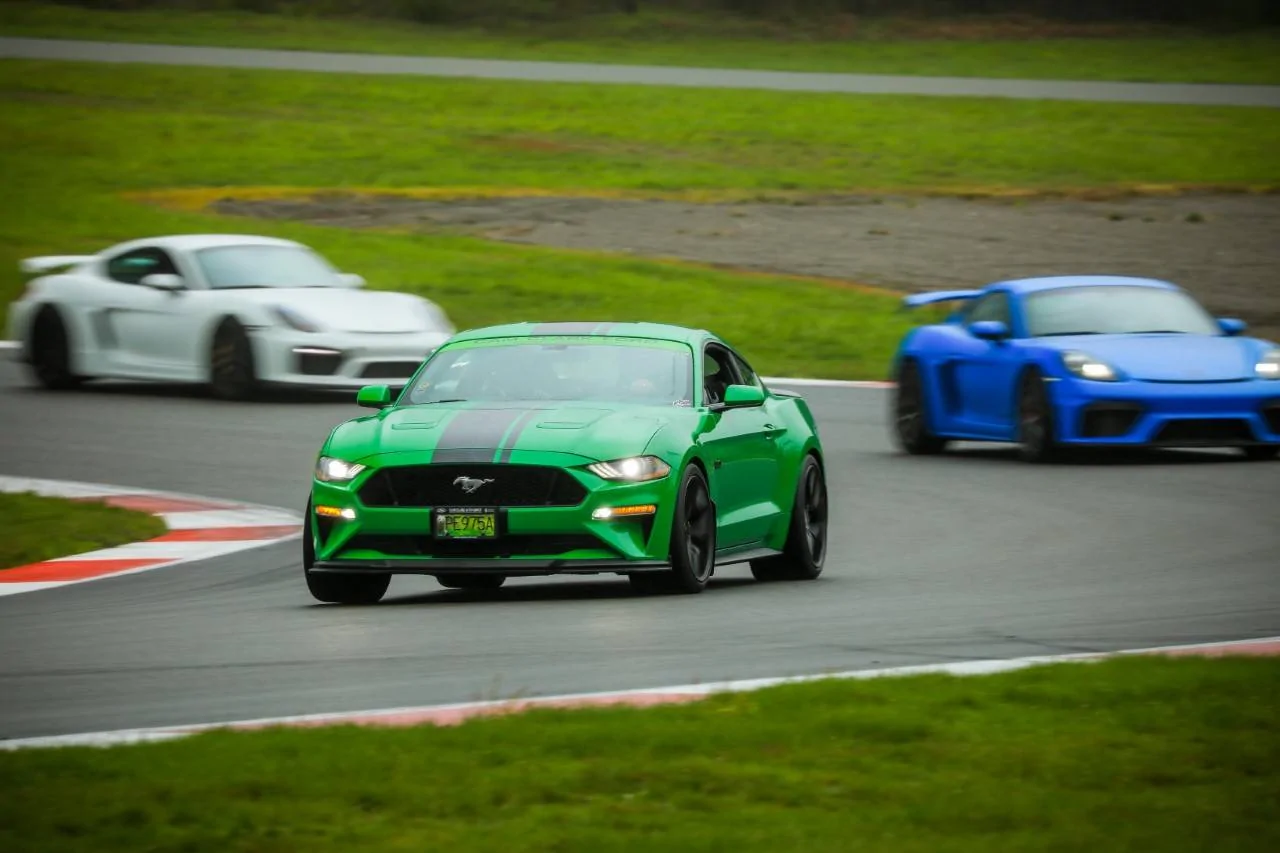

I run the square set up on my PP2 and it has amazing mechanical grip in the wet or dry. I run the OEM sizing, 305/30/19, Michelin Sport 4S in the rain and Good Year F1 SC3 in the dry. It makes for an incredible momentum car at the track.

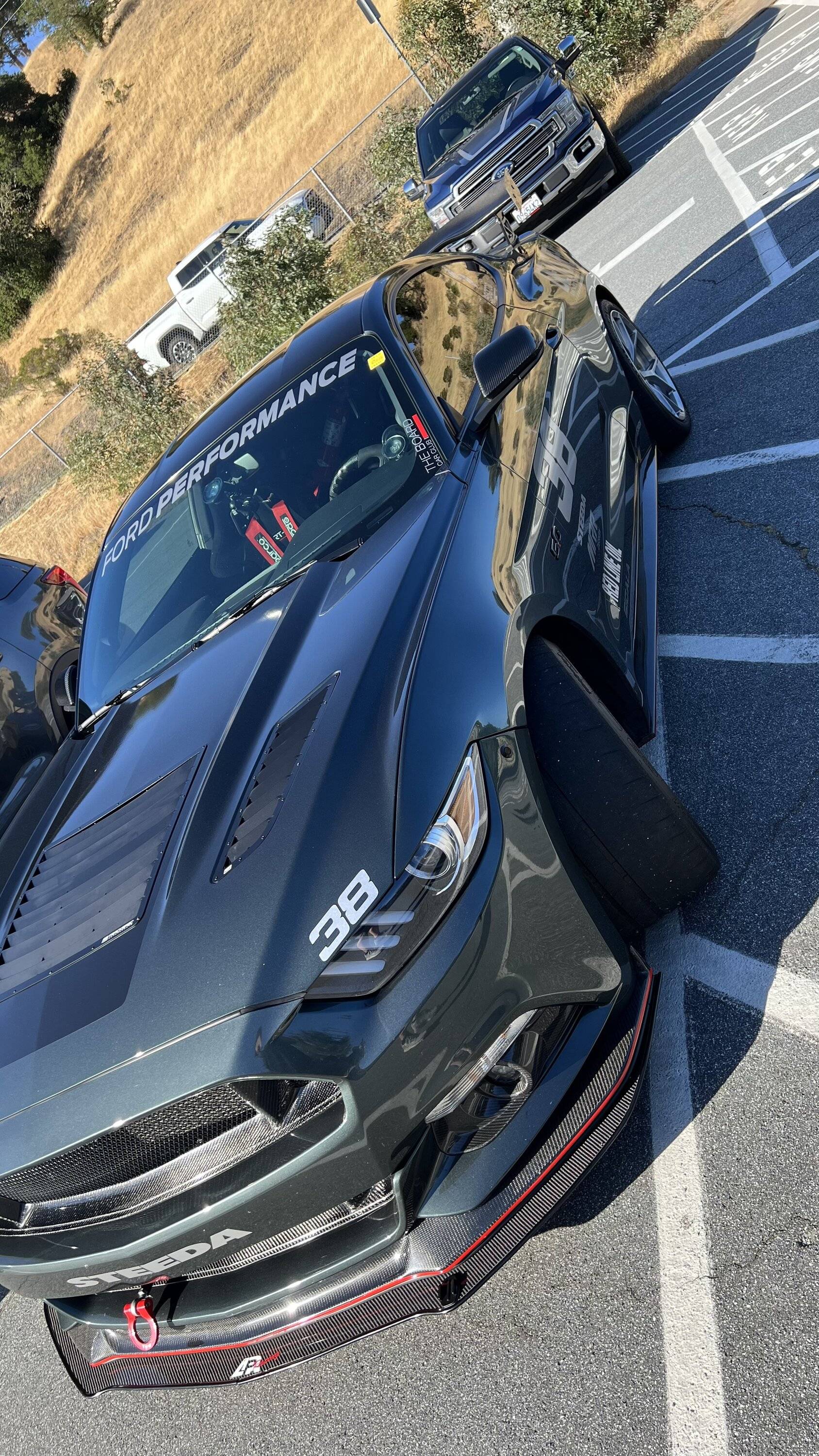

Square all the way! I’ve never liked how the 255’s fill in the front wheel well. For me it’s an improvement in look, feel, tread life and performance. I’m currently running 275/40 R19 square with longer studs and spacers up front. At Big Willow, I’ve been pretty hard on the stock 255’s but the 275’s are faring much better so far.
