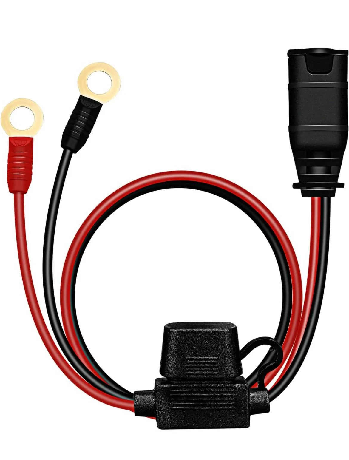

I connect my pig tail direct to the battery and run the plug end out under the cover.
Then I tuck it under a wire loom until I conncet to the tender.
I do not see any problem with going straight to the battery, am I missing something?
Thanks
This is exactly what I do on all my cars and bikes. I have over a dozen charges set up and had no failures so don’t understand why do it any other way irrespective of opinion.
Not saying the other way is wrong, rather this is what I’ve done for decades and never had a issue.
Just sayin.

Necessary like a mofo, but thought I'd share thr thread that helped us most (with pictures). The trickle charger we used is the CTEK comfort panel and CTEK MKS 5.0 charger. Used it on our 2019 it's whole life, installed same to our 2020. We replaced the FoMoCo batteries (they were merde in our experience). We got Everlast, and they're been amazing. Hooe this helps anyone who gives this thread, it's another option easy, permanent, and no pigtails/alligators. 😀

Why not just straight to the battery terminals? I use the NOCO bolt-on plug to the battery terminals.

I have similar setup with Ctek. They said positive to battery positive and negative to a body earth somewhere. With the negative not on the battery the BMS is working correctly.
