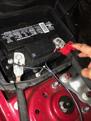

I connect my pig tail direct to the battery and run the plug end out under the cover.
Then I tuck it under a wire loom until I conncet to the tender.
I do not see any problem with going straight to the battery, am I missing something?

Yes. The car has a smart battery management system and your connections leave it in the dark about how the battery is being charged.

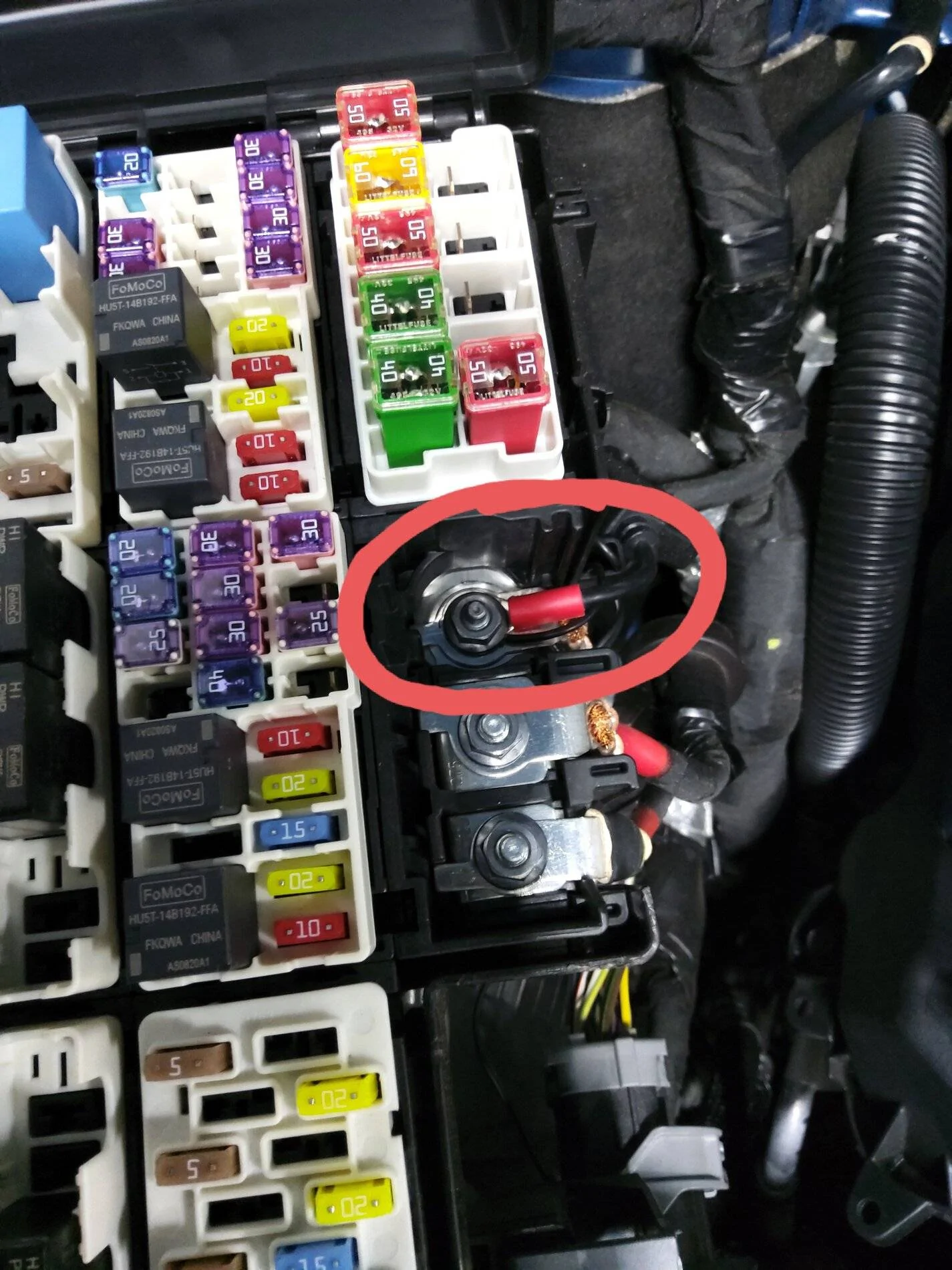

2. Of the 3 terminals at fuse area the terminal closest to firewall (as Dr. Norts so adequately and repeatedly described) is the optimal connection point as this terminal leads to or actually is the battery circuit effectively unencumbered by sensors or other electrical interventions like fuses, etc.

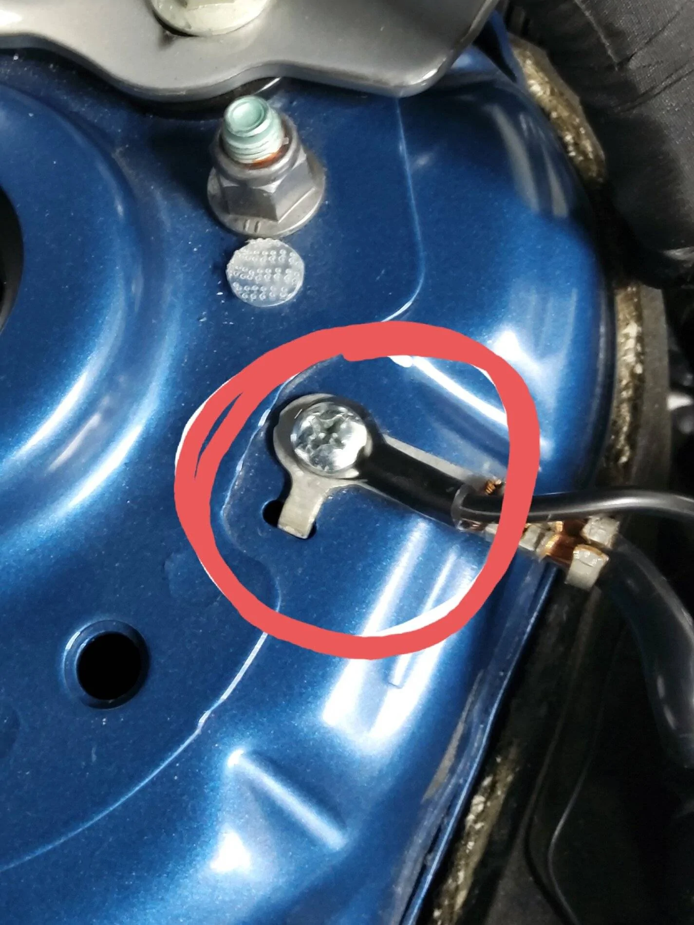

3. Grounds - shock tower existing leads or access to truncating the ground connection remain as a reasonable location.

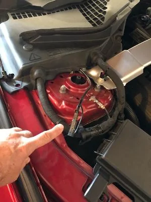

CTEK manual said to connect both '+' and '-' directly to the battery terminals.
All my cars owner manuals(nothing in gt350 manual about this) instruct to connect '+' to the battery and '-' to the ground. All German cars have dedicated ground bolt for '-'. I've done my CTEK connection: '+' directly on the battery terminal and '-' to the ground on the tower strut bolt - easy enough.

It's been a while, but i don't recall there being as easy of a connection directly on the battery vs using the terminals at the fuse box. Maybe I'm thinking of a different car though! do you have a pic of what you did?

I just switched it to (+) connected inside fuse box (top one in the photo), (-) on the strut tower ground.
Hooked it up and should be fine now.
Of course I made sure the spots I connected to were good, also use a tender,
not a trickle charger.

Same. Use the one closest to the firewall. That's the one that goes through the current transformer and connects to the battery.
I'm an electrician by trade but feel free to do what you want. Lol
That's the one I use. In my case I didn't know any electrical difference and chose it because it's lower so the fuse box cover puts less stress on the wire.

can you guys post a picture of this point? ive been using the strut tower bolt, that has the little black ground running to it as my grounding point. if this is not the correct one, interested to see the other point.

These are the ones I use and others here say to use.
