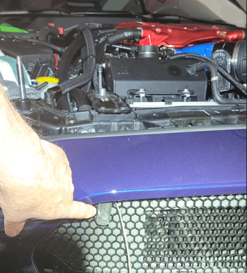

Of these three post near the fuse box in the picture which one post us best to connect the positive lead of my pigtail connector to? Or should I not connect a trickle type charger here at all? I’m assuming it’s ok to place the negative on the negative ground on strut tower where there is already a screw with what appears to be a ground? I want to leave the battery box cover on so I’m hoping to hook up a quick connect pigtail to my Noco G3500 for storage charging.
I think I used the front one for my Charger Cable. I have the connector coming from my grill so I don't have to open the hood to charge/trickle.
