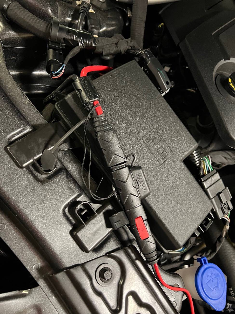

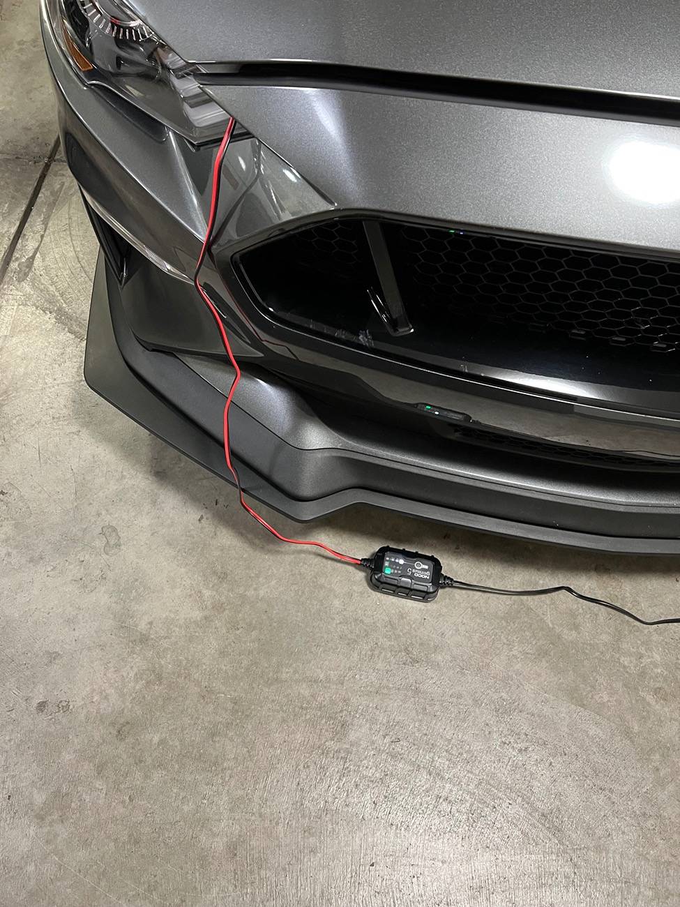

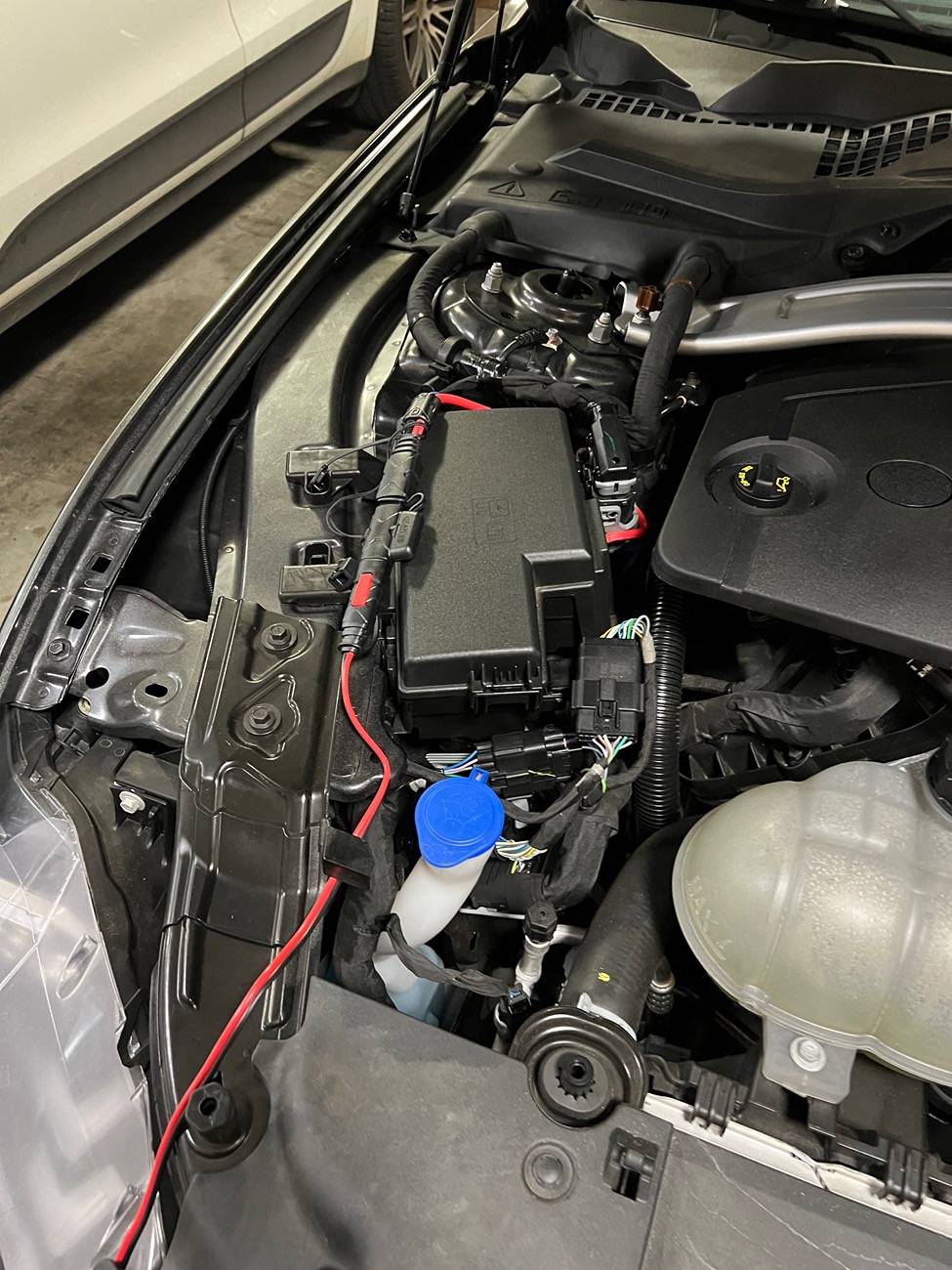

I realized I needed a battery tender on my s550 as I have not been driving it this winter (I had the ignition on while installing a A10 shifter ball and the battery died in about 45 mins). Installed a wired hookup that lives under the hood and also works with my boost jumper.
