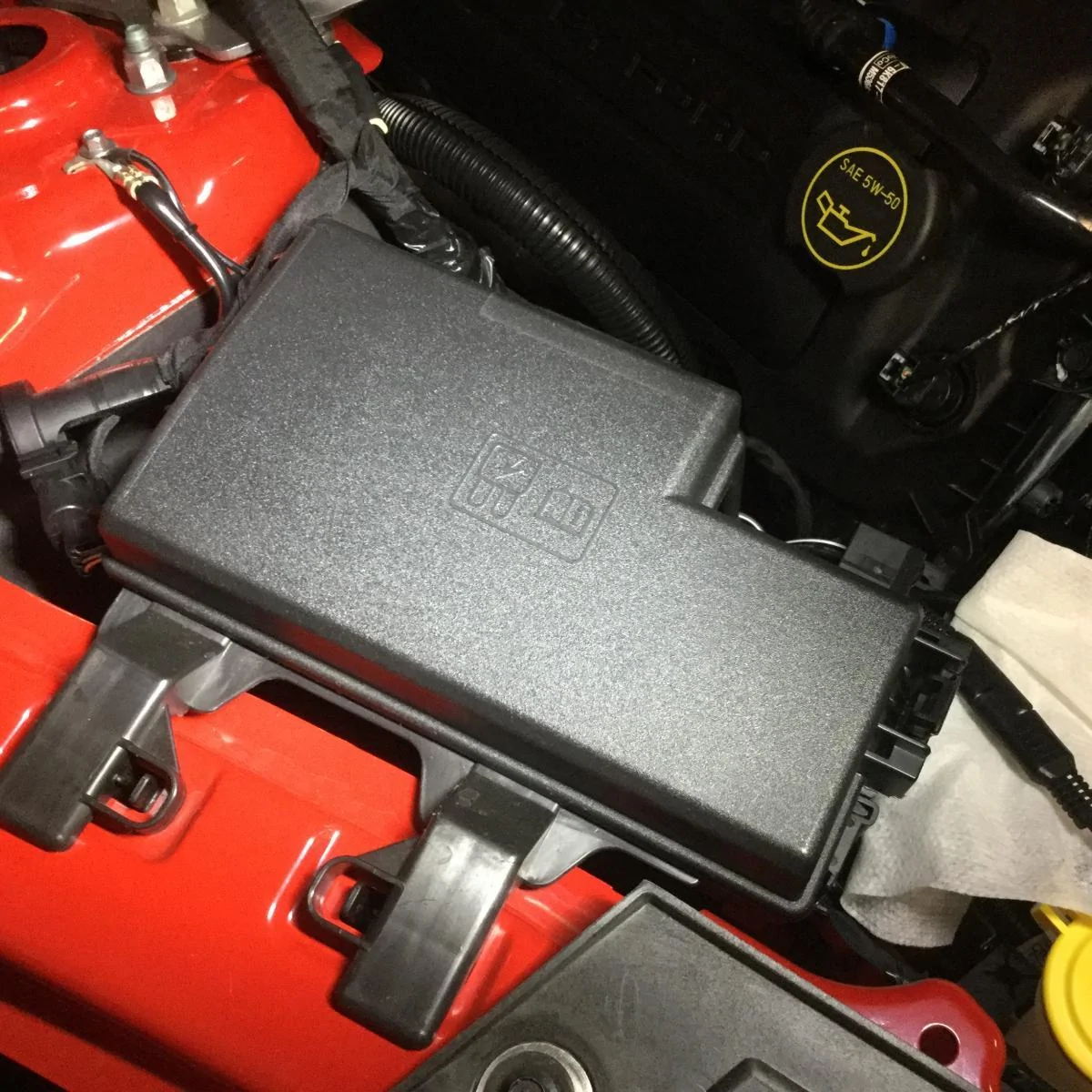

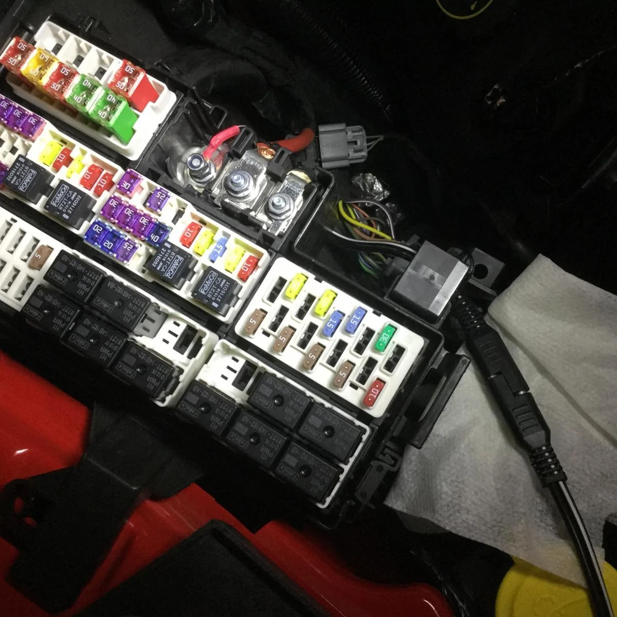

I hooked up the supplied disconnnect to the red lead on the fuse box and the closest ground on the shock tower. That way the disconnect is up front and accessible (placed the white paper under it so you can see the connector).
Ditto, I did the same exact CTEK wiring setup to the fuse box last November for winter storage. The battery was kept fully charged all Winter long. I found using the motorcycle setting works the best for a trickle charging.
Is the red (+) lead on the fuse box the one in the middle or the one on the left in your pic?
They both look red (well, I guess the one on the left looks a little more pink).
Has anyone hooked up the CTEK 3300 with the supplied eyelet terminals like The Chairman has done with his Schumacher tender? If so, any concerns? Thanks in advance?
Edit: I did this..works flawlessly. No need to get any other extentions or connections.
