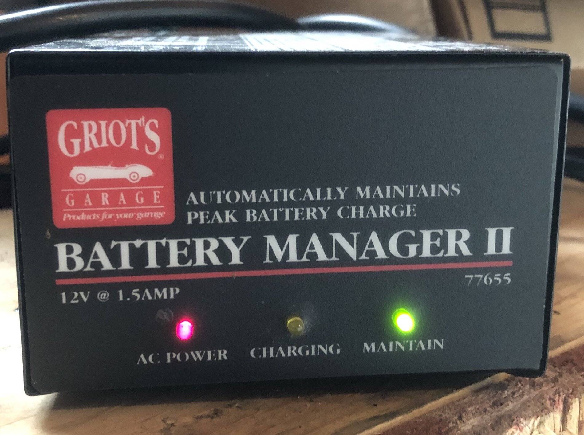

I had this one for almost 20 years. Works great.

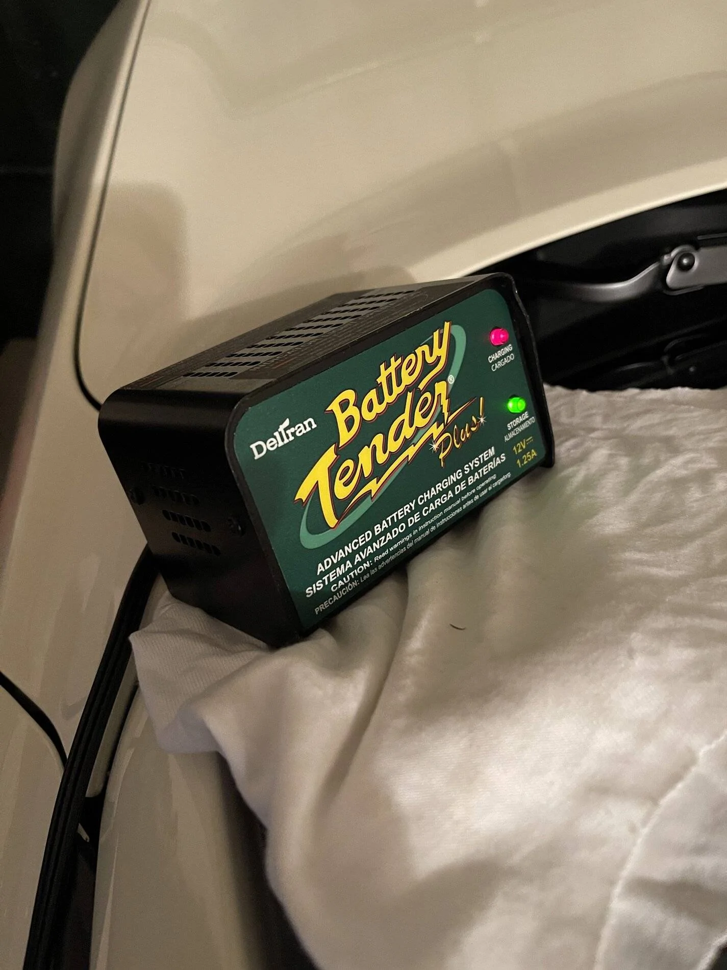

I have a 1.5A. Factory batteries these days suck. My R drains down after a couple weeks and won't start. Same with my wife's Corvette. I put my tender on and in 12hrs it's fully charged and in maintenance mode. I like the slow trickle chargers for the battery's long term health as opposed to something rapid. Been using it for 3 years

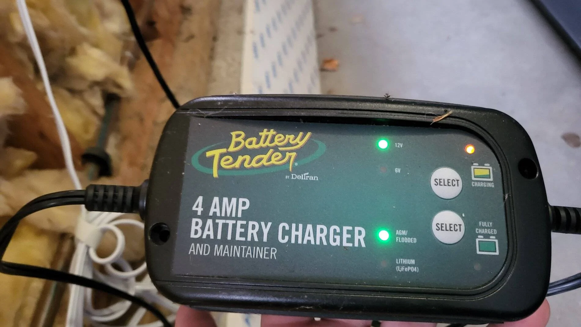

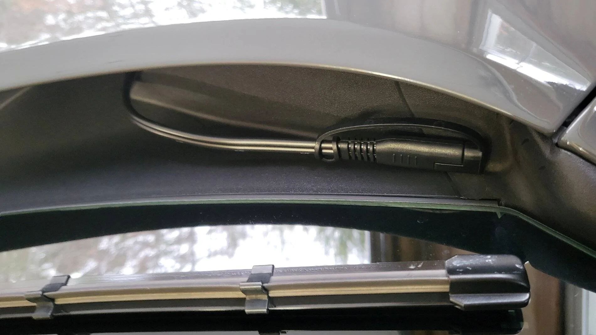

I use a 4amp, comes with a ring terminal adapter so the adapter is mounted to the battery and sitsright below the passenger wiper hidden from view unless you look down under lip of hood.
Just remove cover and connect if it's going to sit a while
