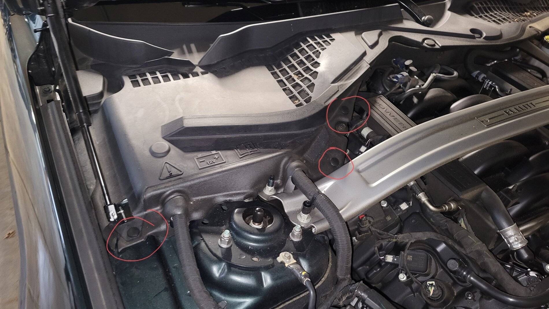

How were you all able to take the 2 clips off that near the battery and fuse box?
There are 3 clips. If you look closely, there is a little narrow slit in them - put a thin flat blade screw driver in there and pop up slightly. The clip will loosen and then you can pull them out and take off the cover.
When putting back, make sure you rotate them in a way that you can always see the little slit.
If you still are not sure, I can take some pics when I get home tonight. :)
Edit - that ^ sounds REAL dirty. :crackup:
That would help if you could share pictures of it. I find my car shutting down fast after stopping the engine or dome lights not wanting to come on until car engine is started

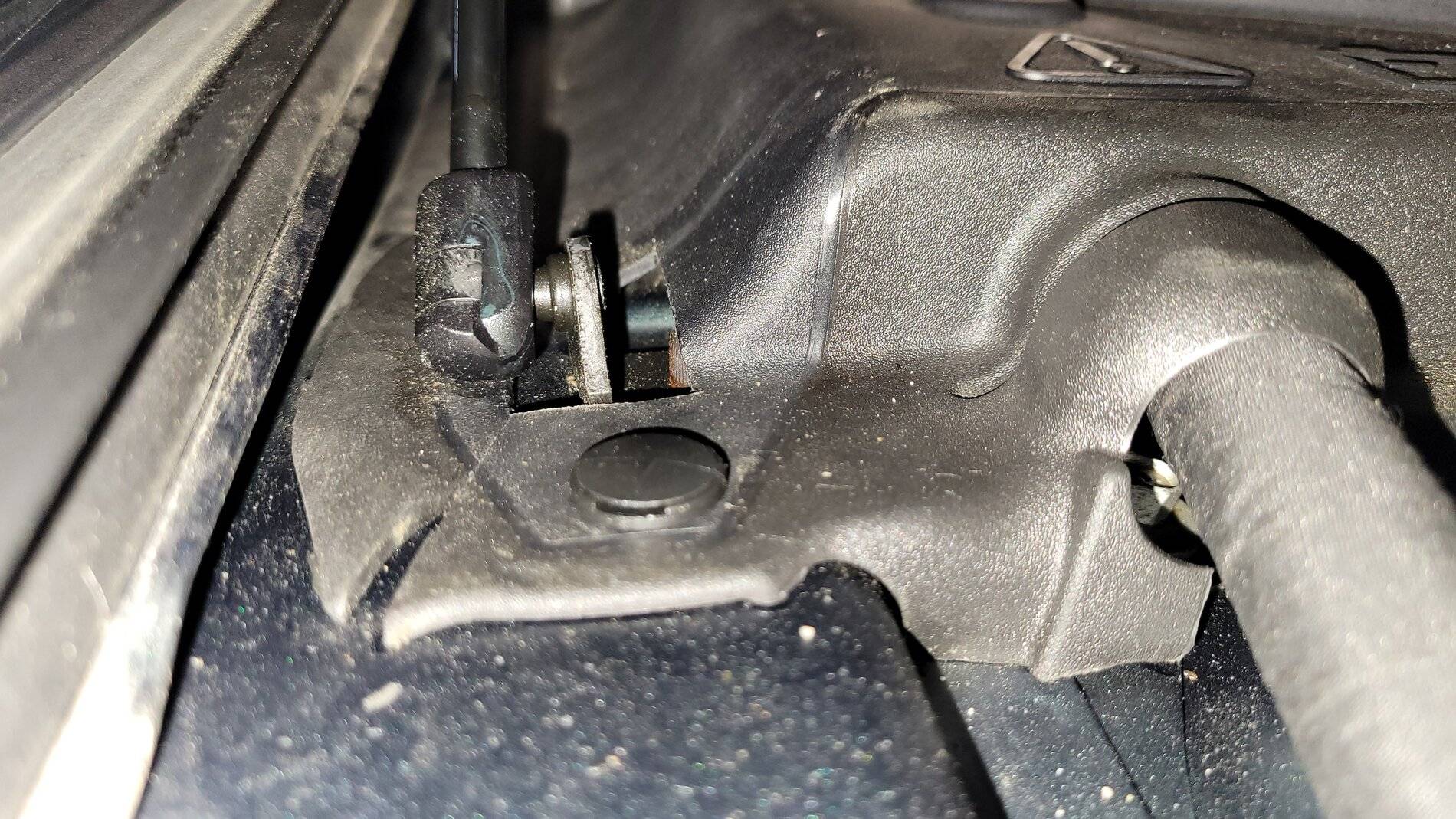

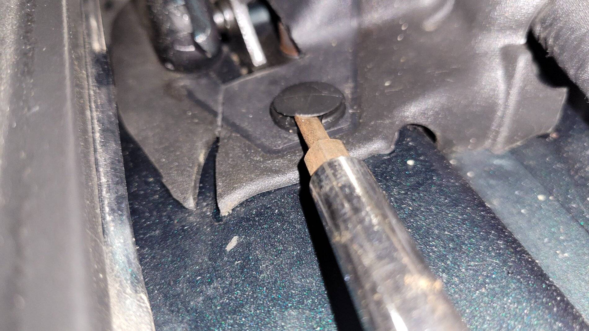

In my pics, the 3 tabs (at least on the Bullitt, but pretty sure same on all S550 Mustangs) hold the cover on.
Find the little slit/gap on each plug. Insert a flathead small screwdriver and slightly twist. Plugs will half pop off, pull off by hand.
When replacing, put them in a way that the slit faces out so you can get at it next time.
