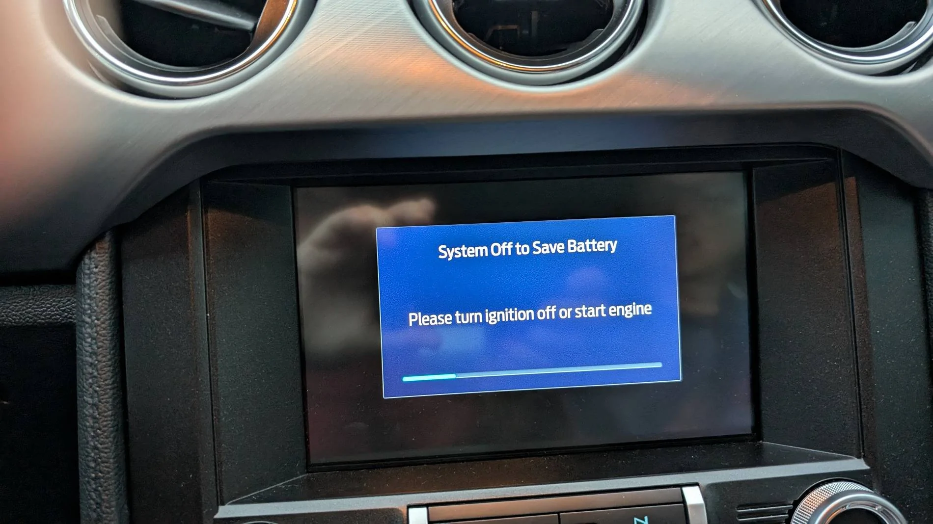

So I noticed for awhile I would get the system off to save battery message so I replaced my battery (battery would die every time it got coldish or sat for more than 1 days) got an xs power 4700 per alot of recommendations. No issues for a week.
A bit goes by and the messages come back but the car starts fine. But now it's maybe 6 months later and the temps are low 30s and highs of 60-80s here nn Pennsylvania. Car cranks super slow after sitting overnight to the point I think it's dead. 1 crank and then like 5 seconds before it'll crank again almost as if there's no power. Had a mechanic check the battery and alternator both are fine. The only other thing changes is state of charge was changed from like 70% to 90% and the battery type was changed to the closest size I could find for the new battery via forscan. When I installed it. Any ideas why the slow crank/dying battery.
Accessories are very simple, uniden r8 radar detector hardwired into the rear view mirror (shuts off when the cars off) and a viofo dashcam that turns to parking mode with the car off but turns off at a set voltage (usually I set it to 11.8 or 12.0). And it's hardwired into the fuse box on the passenger side. I have tried unplugged both and still have these signs. Per the cars instrument cluster voltage tonight reads 11.8 right after shutting the engine off and after having driven it for about 30 min from work to get gas and home. (Feel like 11.8 is already a bit low but I don't really know anything about batteries). I will update in the morning what the cluster reads when I put it in acc mode to check the voltage (with dashcam and radar detector both unplugged). Parked it at 5pm and will start it around 6am.
Please help me figure out this nonsense because when the temps drop below 30 im concerned it will need a jump every single time.

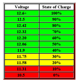

Assuming your instrument cluster gauge is accurate, 11.8 V is really low after shutdown. I would also double check using a multi meter to make sure the cluster is correct.

If your battery is reading 11.8 V right after shutting the engine off you have something other than a parasitic load. Either the battery is kaput or the charging system isn't doing it's job.
What is the voltage at the battery terminals with the engine running? If the battery is initially at 11.8 the charging voltage after start up should be at least 14.5 V, maybe higher as the system is trying to jam juice back into a heavily discharged battery. You should also check the voltage at the terminals after a long drive. The quirky on/off charging system in new cars will complicate this measurement but you should see about 14 V part of the time.
If you have a battery charger or tender you can try disconnecting the battery terminals and charging the battery overnight using the tender. Disconnect the tender and let the battery sit for a couple of hours then measure the voltage at the terminals. If the measurement is low then the problem is the battery.
