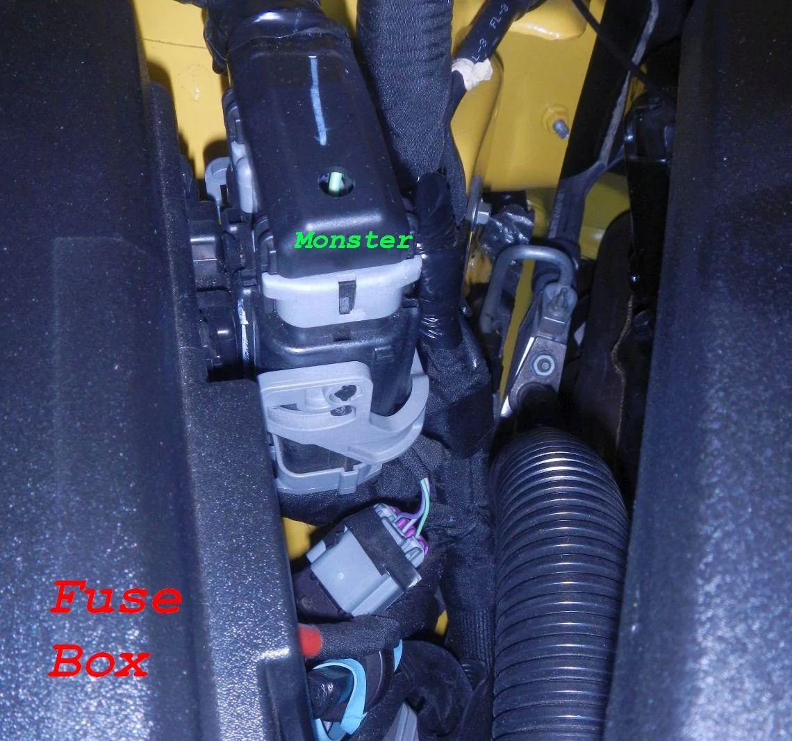

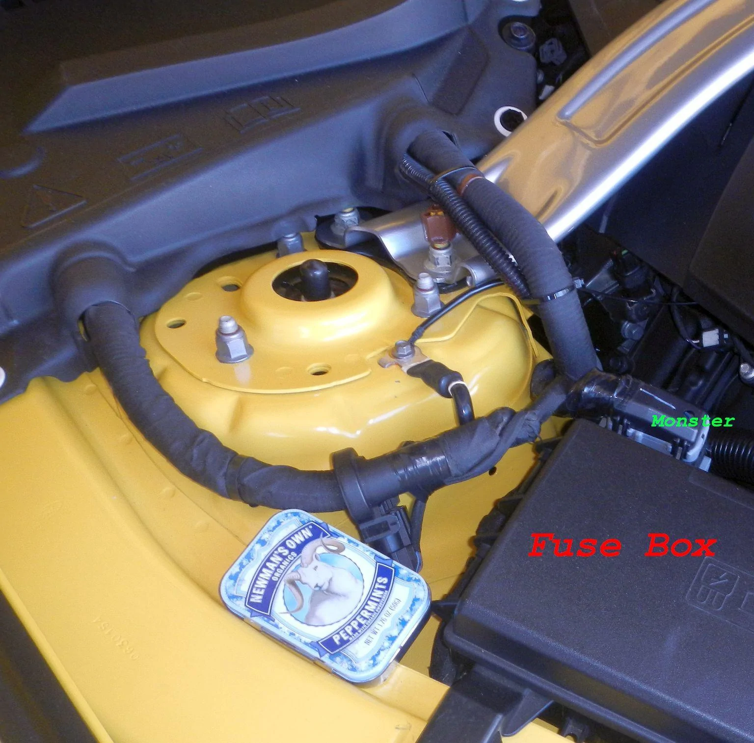

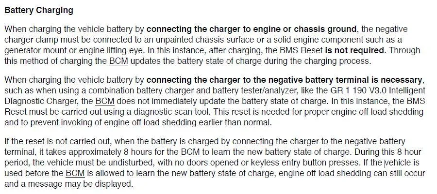

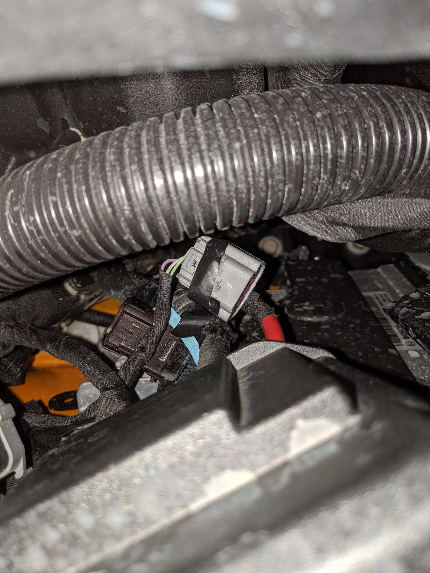

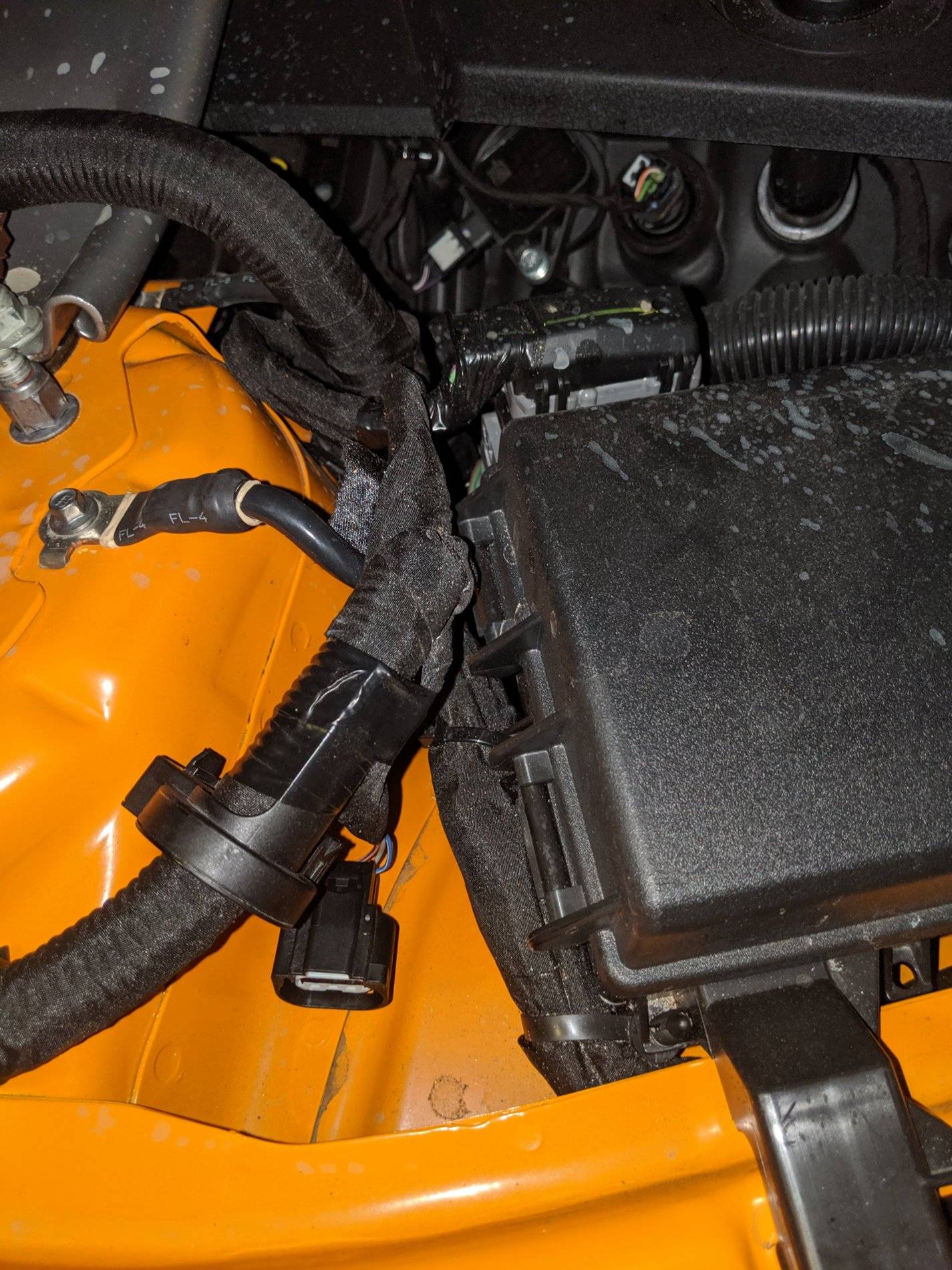

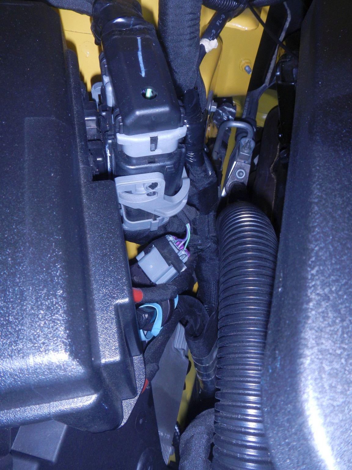

That monstrous piece of equipment is called a fuse box. I have found my car seems to idle and drive better without my voltage continuously going up and down with the battery mgt plugged in. It now holds consistent 14.1 to 14.6 volts. The lowest I have seen unplugged was 13.9 and it quickly popped back up to 14.1. Prior plugged in it would drop down to 12.1 to 12.5 which is dead battery range. FyiJust curious and looking at the location of the sensor plugs in my 2018 automatic's engine compartment, I was dismayed that the positive connector wasn't visible like Smokey's. I found it under a monstrous piece of equipment. What the heck is that? Seems as if someone drew a line on it with a silver Sharpie™. Negative cable sensor looks normal.
Not that I'd ever consider disconnecting something Ford clearly invested a great deal of engineering in, just to get my possibly innocuous gauge readings in a line.![]()
