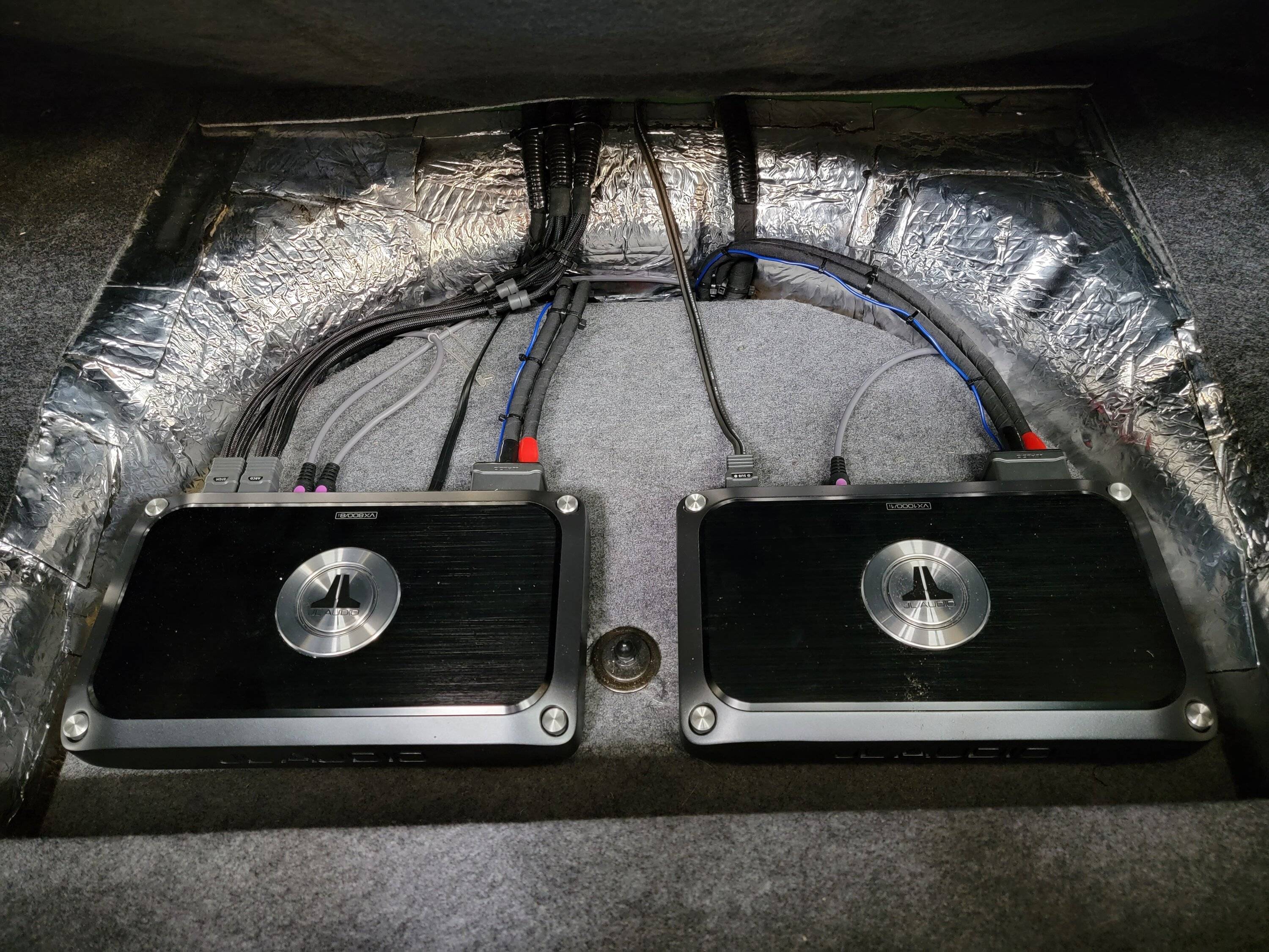

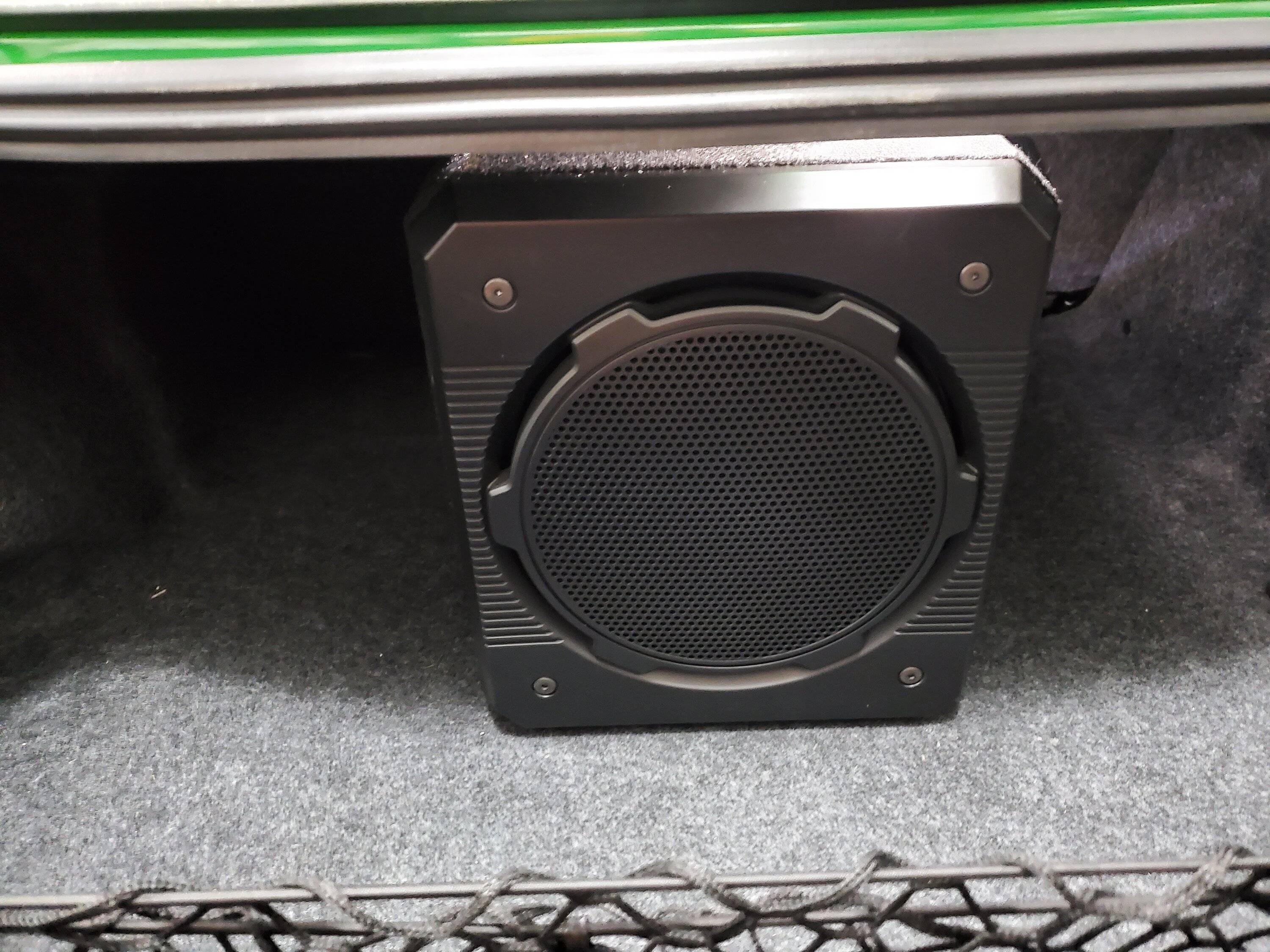

It's been 2 months since acquiring everything for my system upgrade and getting it finished and tuned. I had the tuning done at Auto Accents in Lawrenceville, GA. A great shop with a great crew working there. For those that haven't seen the other threads, I posted in. I replaced everything except the head unit. The front stage consists of Focal Flax EVO PS165F3E speakers and the rears are Moral Tempo Ultra Integra 602 MKii. I know some don't see the need for rear speakers, but I like rear-fill. The subwoofer is a JL Audio CS112GW6v3 Sealed. I have JL Audio VX800/8i and JL Audio VX1000/1i amps powering everything. The tuning and RTA session took almost 5 hours but man, does it sound great now. It is night and day between the stock B&O and this system.

@m3incorp, sounds like you‘ve got some wobble, wobble, shaky, shaky bass now! Did you replace the tweeters in the A-pillars too? How about the sub, we’re you able to anchor it down somehow, so it stays put during spirited driving?

Good questions. Yes the tweeters were included in the Focal 3 way component set.
I have the the TKO Performance Sound Deadening Mat that helps with the Subwoofer moving around. But If I get on it real hard, it will shift rearward some. It's not in the pictures but I have two leather covered blocks that extend from the subwoofer to the rear and won't let it move. These get in the way, so I am thinking of ways to keep it from moving. Since the subwoofer only moves towards the rear (has never moved towards the sides), I am thinking of fabricating something that is about a half inch in height and the width of the subwoofer which would have to be glued or velcro onto the Blockit mat. The key is it has to be just tall enough to keep the sub from moving but yet, not too tall, that I can't remove the sub when I want.

Only downside I could see to that is that it will block radiant heat from escaping the spare tire well where your amps are.
Keep an eye on your amp temps if you go that route.

I agree completely. I don't drive the car much except on weekends but I think if I took a road trip in it, I might remove the blockit. I will definitely keep an eye on temps though. I've had plenty of people tell me that is why they wouldn't mount an amp rack in the spare tire well.
