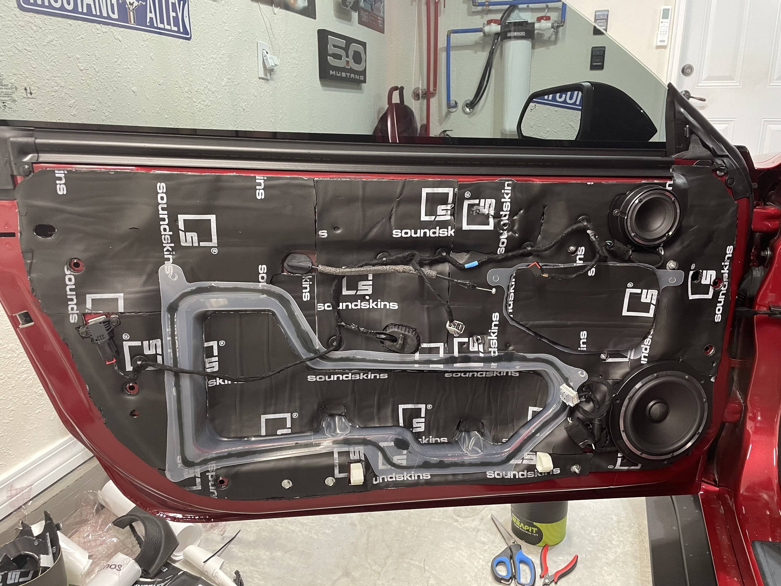

You've reminded me I need to take my Mustang to the audio shop and have them dynamat the passenger side cause the B&O causes a rattle/reverb with bass.
If you’re comfortable with doing the work you’d save yourself some money if you do it yourself. It’s quite easy and you could do both doors in one evening. Trust me, you’ll notice significantly more bass from your door 6.5s with proper deadening not to mention the solid “thud” the door makes when you close it lol.
Here’s a pic of my door while I was sound deadening. All you need is a roller ($10) and a sharp pair of scissors like you’d find as a hardware store (not some cheap paper cutters). Also, Dynamat is a bit pricier than many other companies and their product isn’t any better than other popular brands. Save a few dollars by going with another popular brand.

Go with Resonix. Probably the best on the market in the US right now.
