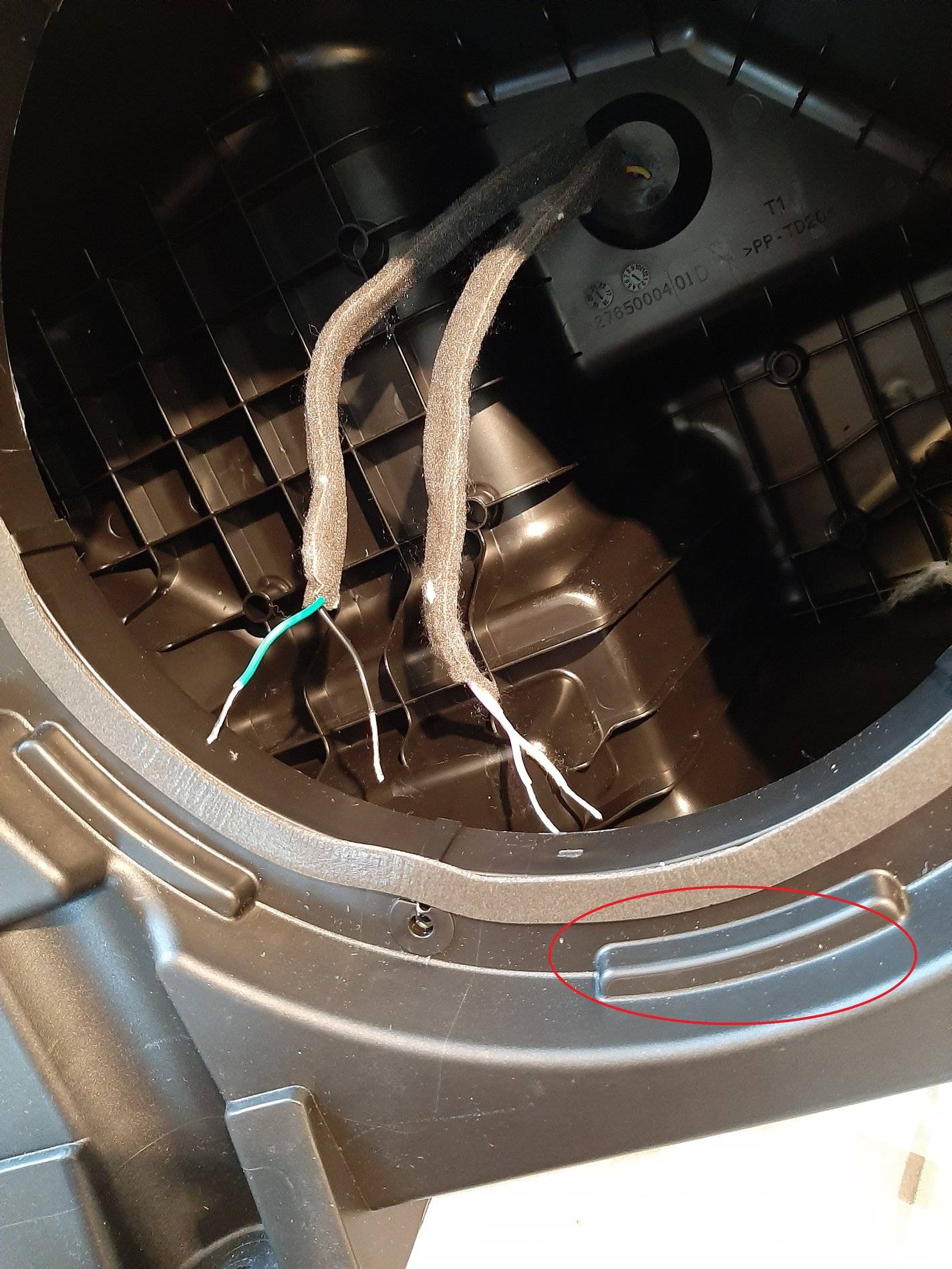

The RF speaker cage sits exactly into the hole in the enclosure, and it sits snugly into the outer diameter of the recess. I put a weather strip just to make it an air tight seal.
Did you grind off the ridges (highlighted in red) to get it to sit flush or pad it out with loads of seal ?

No, I did not have to do any dremel work.
The RF has a cast aluminum cage that houses the speaker.
That cage fits directly into the hole, while the mounting tabs fit above the ridges you highlighted. I installed the weather strip (1/2" thick) as you did, but bent it inside the ring also.
It literally dropped right in and seals very tight!y.
