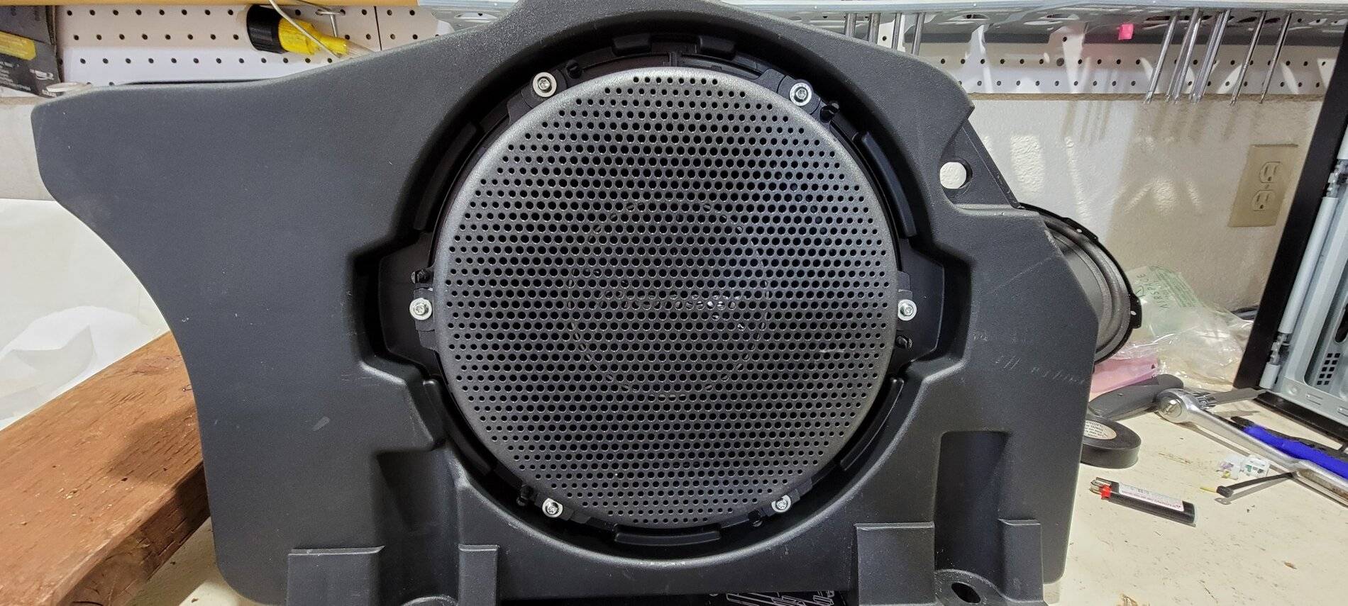

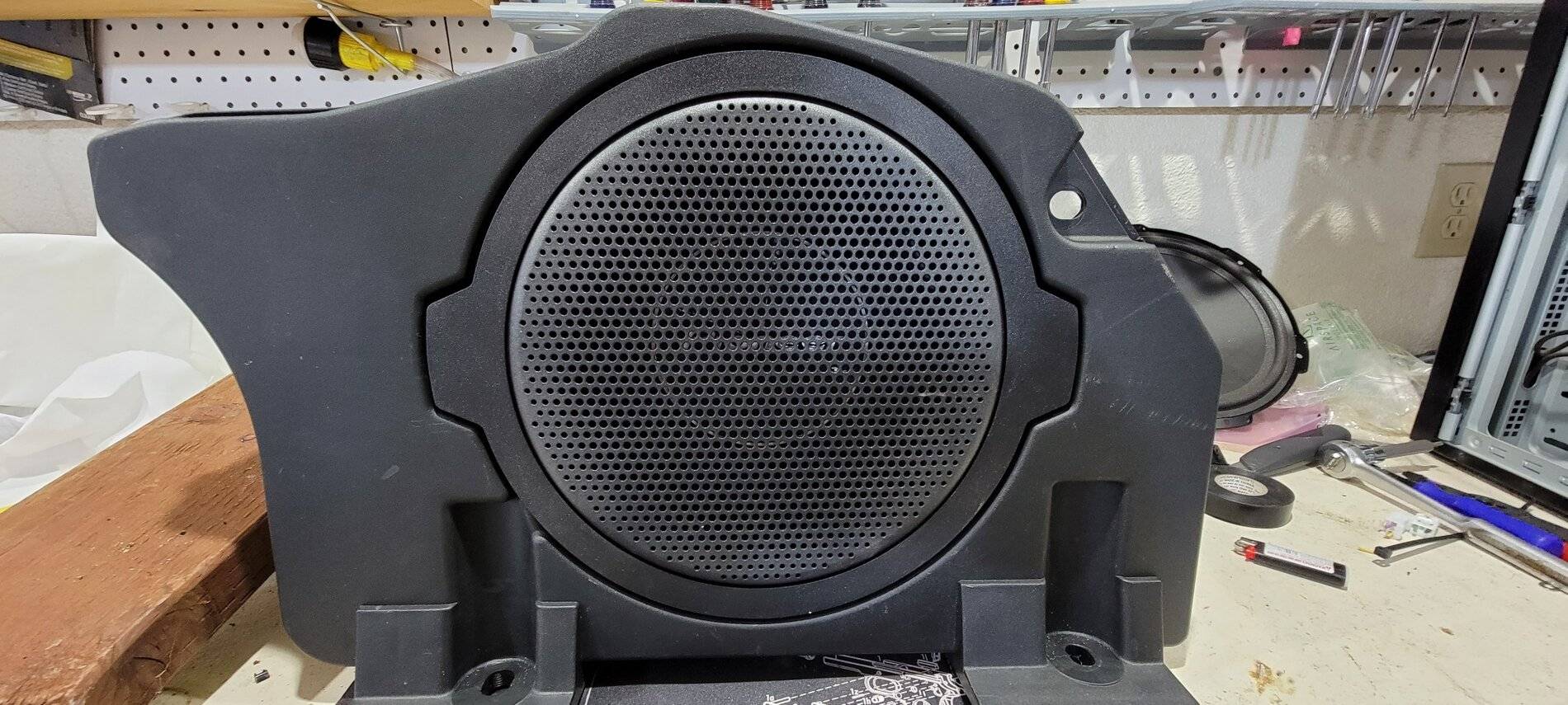

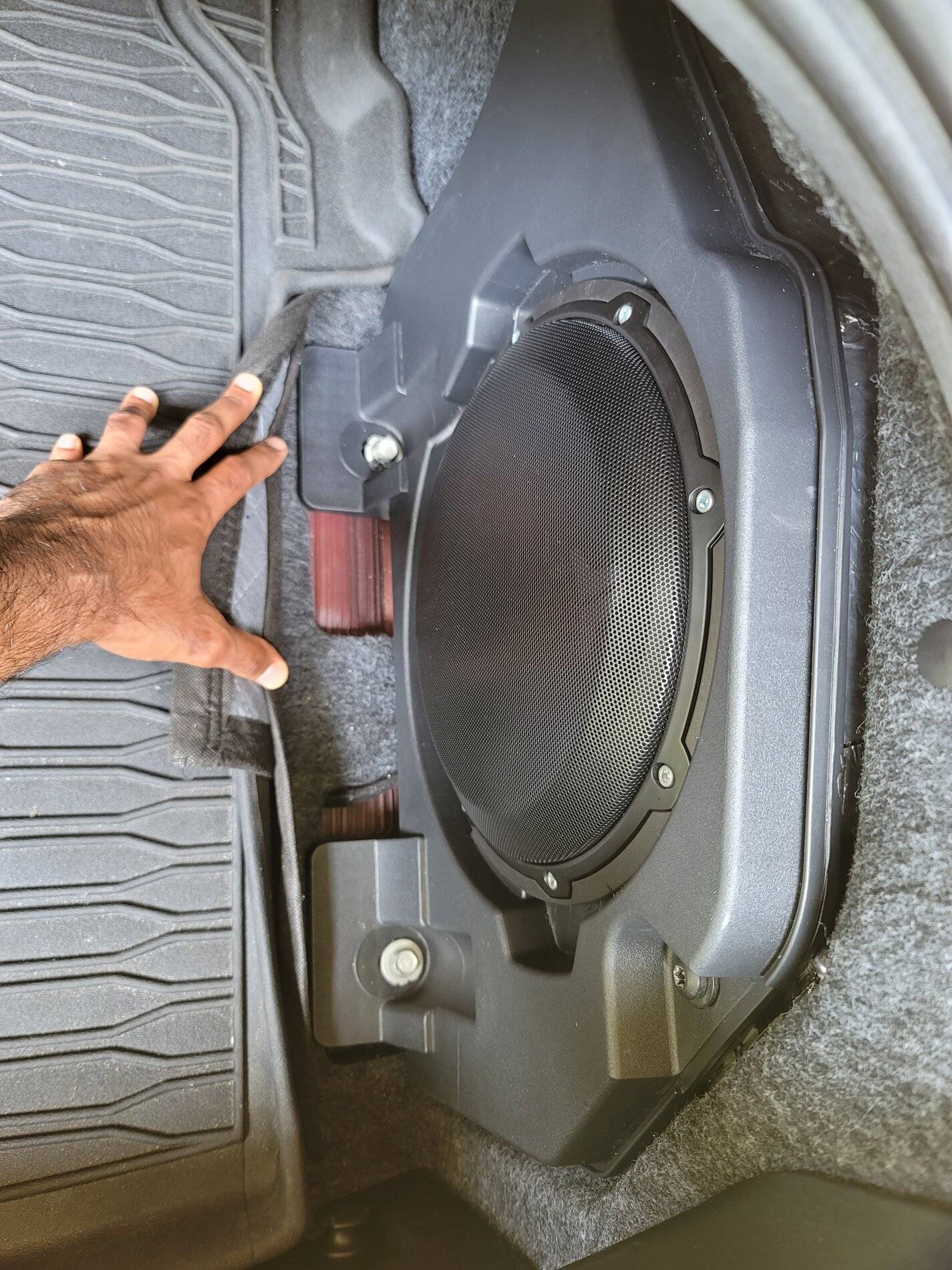

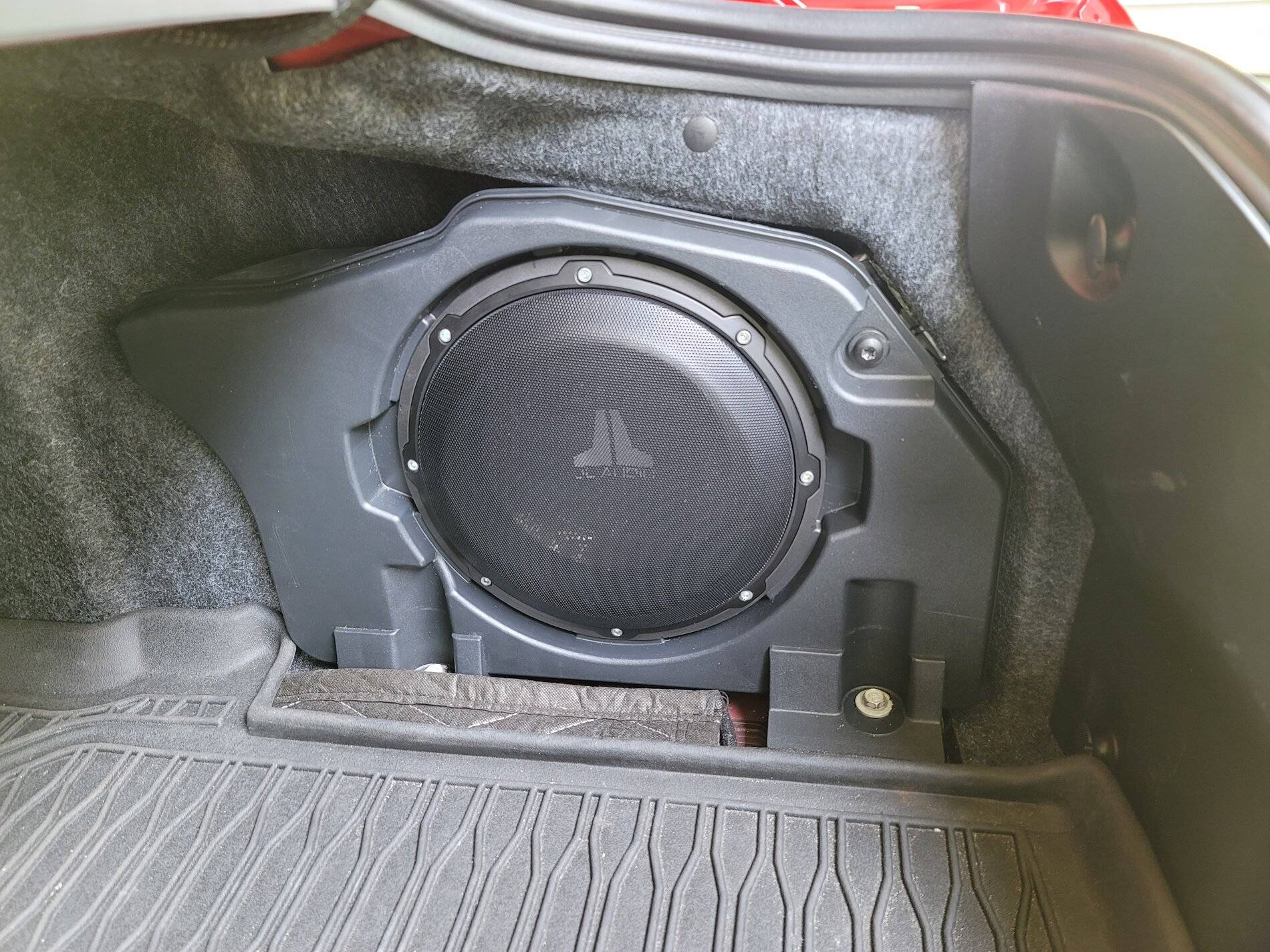

FYI, The B&O 10" sub uses the same mounting holes as the 8" Shaker Pro sub. I swapped the 8" Shaker Pro sub enclosure with JL 8w3v3-4 in my car to a 10" B&O enclosure with JL 10w1v3-4. I'll post some pics tomorrow. The only issue is the trunk liner leaves a visible gap near the bottom 2 sub mounting locations so you can see the bare metal underneath. The Shaker Pro sub has another plastic trim piece to cover that gap
Awesome.. Thanks for the help guys.
I don't mind the bare metal showing like @FreePenguin said just some small strips of fabric for hobby lobby or something.

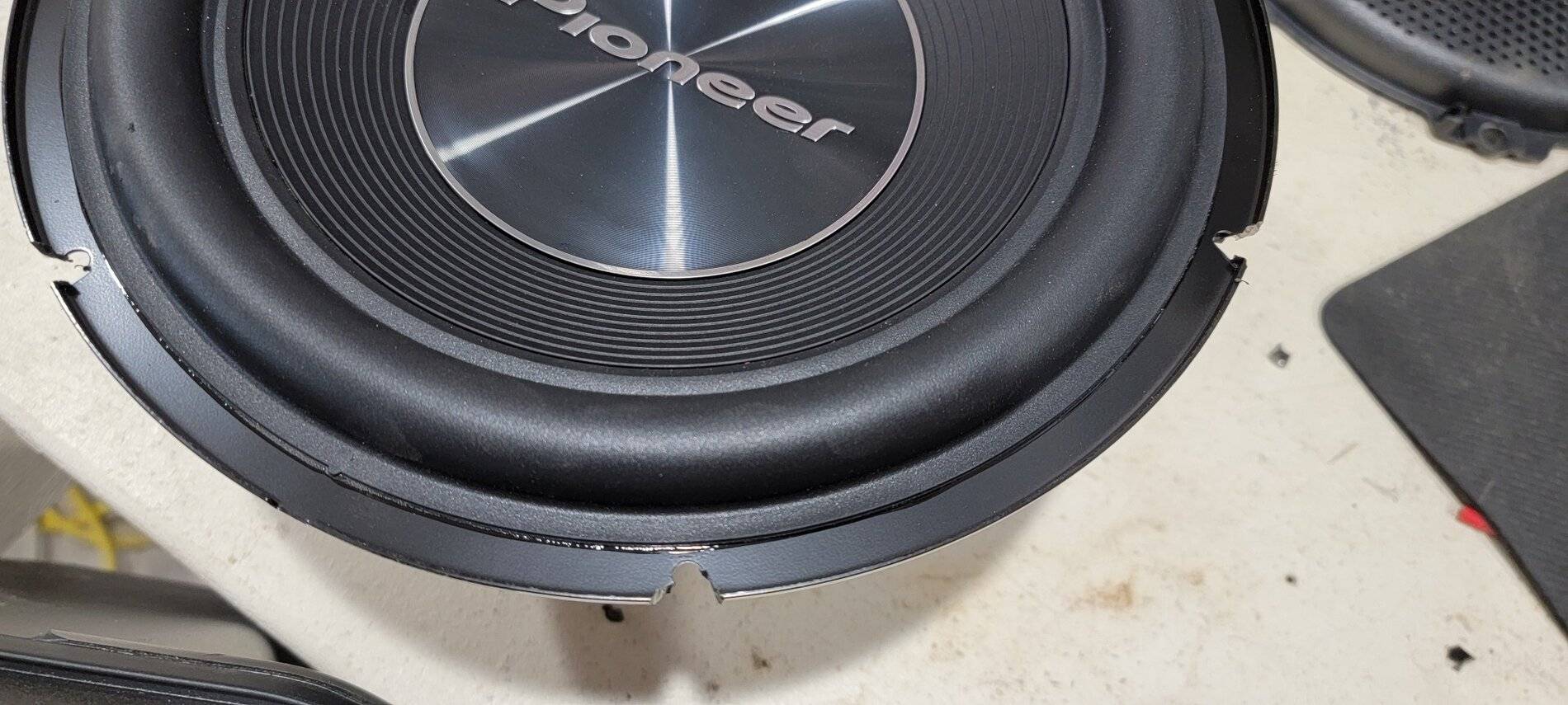

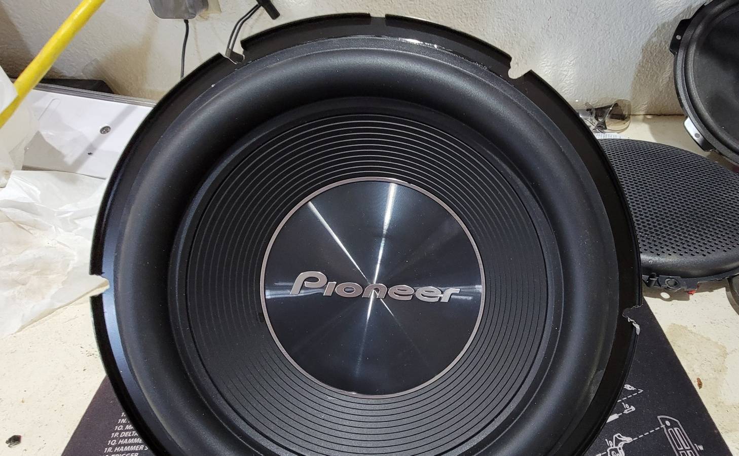

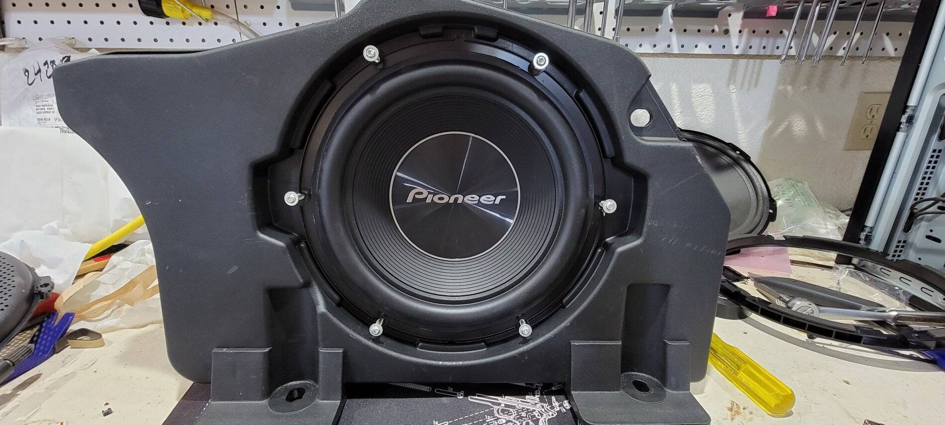

How about if you 'Dremel' the edge (the 90-deg bend) of the Pioneer sub where the screw goes, and use the original hole, with the OEM grille pressuring the speaker down? Would that be enough? Without the grille, the screw head would still grab the speaker, but the grille should push it down enough IMO. That would be the only way to install it for me. Thx.
I did it that way. Holes lined up perfectly. Didn't have to drill holes in the box and I re-used the factory screws. Took 2 minutes with a cutoff wheel on a die grinder. The seal is the same.
